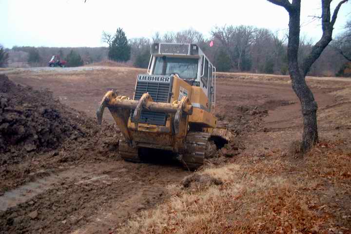

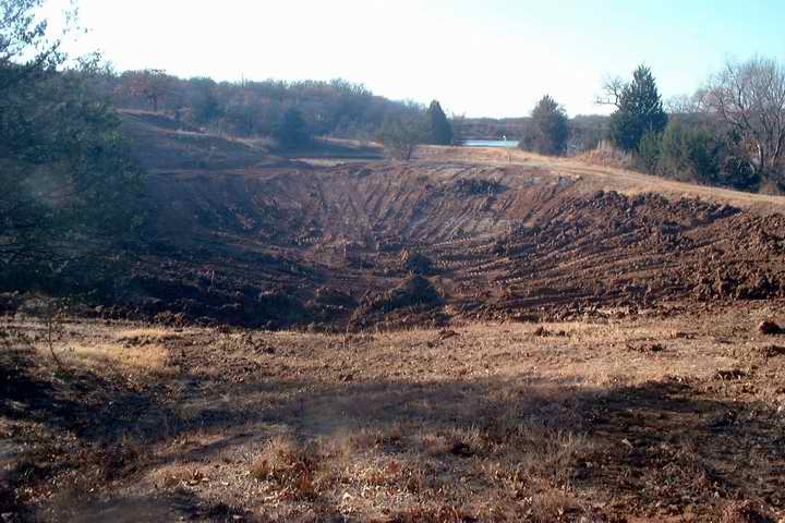

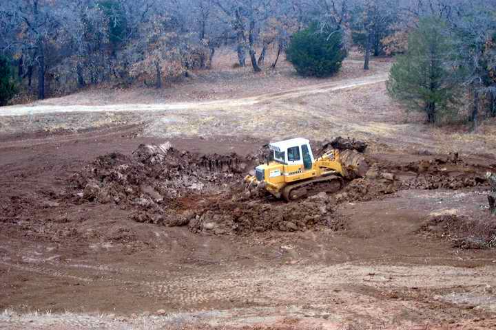

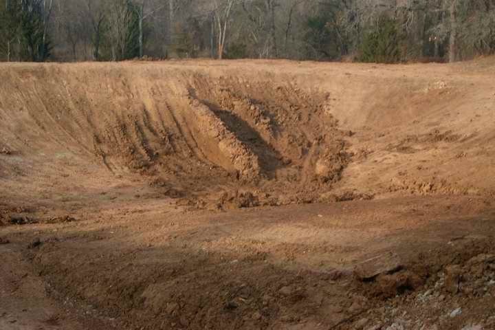

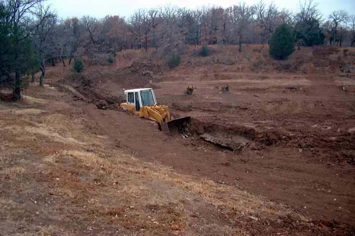

I have to warn you that when you ask me a question about a photo, I am inclined to flood you with a bunch more. Sorry. . .:eek: I had a man with a track loader in to clean out 60 years of silt from a pond. In the deepest point, the silt was 10 feet deep. This first set of photos is the dozer and his struggle to get the sticky silt out. He had tremendous trouble with it because his bucket would half-fill with silt that would not dump. He had to keep stopping and cleaning the bucket. It made his time not the most efficient and I sent him away with still lots of silt left on the banks of the pond. The photos below tell his story.

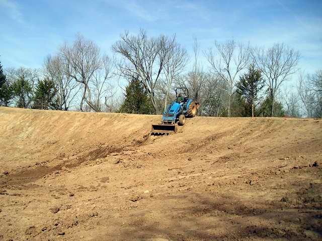

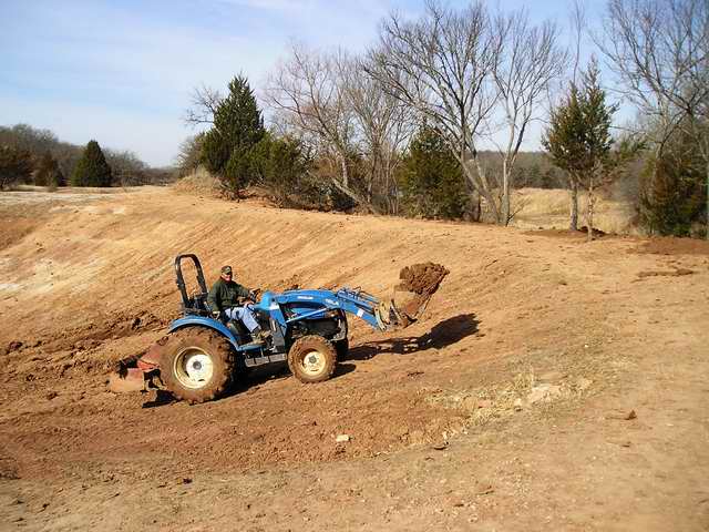

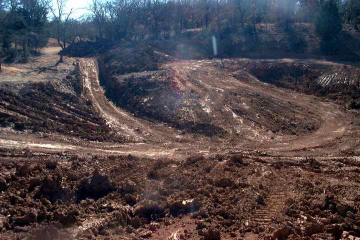

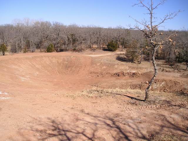

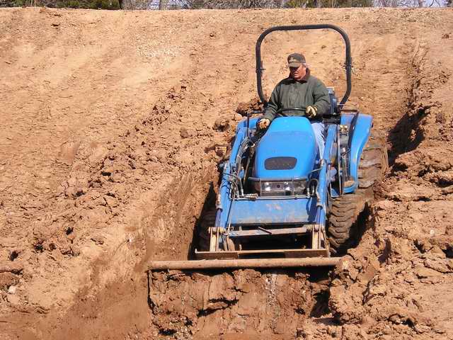

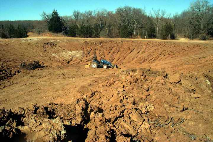

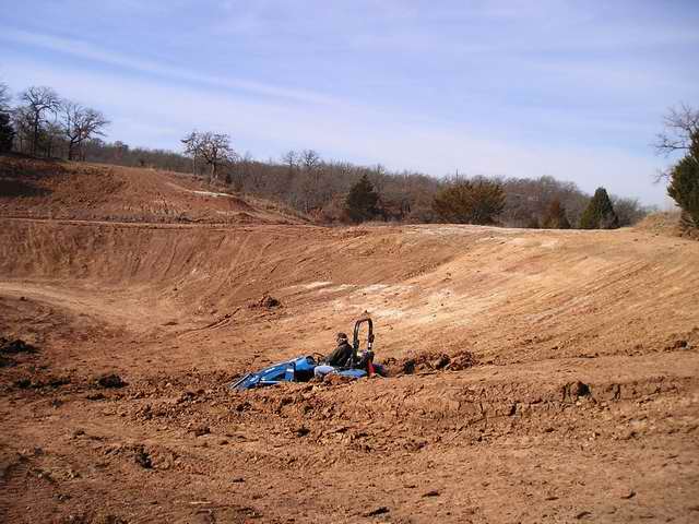

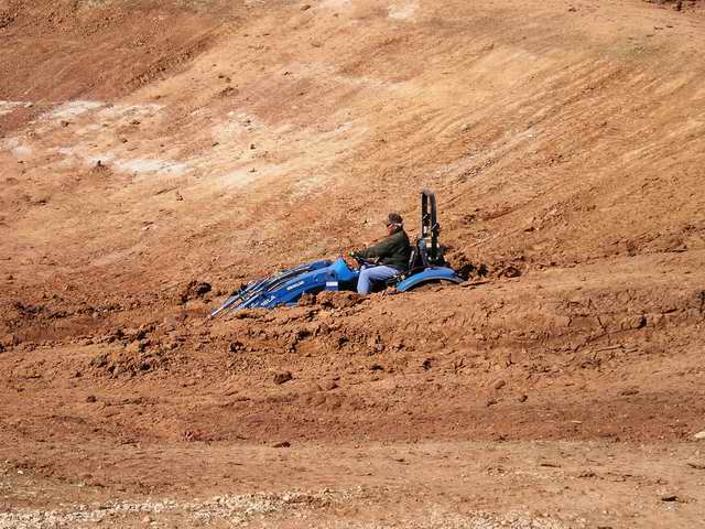

So, after the track loader left, I decided to use my tractor to clean up the pond banks and increase the size of the pond. That's where my avatar photo came from. Below are photos that tell my story as I worked my way around the dam. It was a long, but fun project and the whole time (several months) we got no rain. One big rain storm and my job would have had to stop. The last photo is after a big 5" rainstorm.

Great pictures and a fantastic project. It's fun to see your progress and knowing that anything is possible if you just stick with it!!!!

Hey Jim those r amazing sets of pics!
firstly i could not imagine that much silt could build up.......did u realise how deep it was or was it a surprise to u once the dozer started?
secondly what a fantastic job u did with that tractor - its a lovely hole of water!
i guess that clay holds the water well & u just loose water thru evaporation?
u were certainly lucky to have a run of fine weather, cos it would be hugely sticky job otherwise.....a true amazing story, and a big tractor job.
