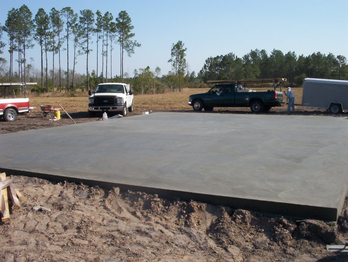

Truck #2 is done and Walter and his guys are also done for the day, will be back tomorrow to cut expantion joints.

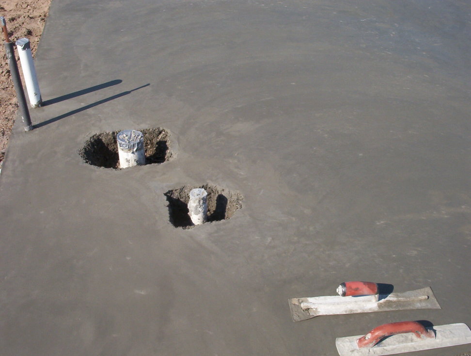

The bathroom drains and plumbing came out well too.... Now we will have to wait till concrete cures before building Garage. I plan on starting the building around the 23rd or so.........All in All a real good 3 days of work by everyone...

Mornin Big R,
Real nice so far, Im jealous /forums/images/graemlins/grin.gif
It looks pretty flat, is that the highest area around in case of heavy rains ?

Hey Scotty,
On this parcel of land which is 15 acres thats one of the highest locations, plus I raised it another 12 - 15 inches with fill, plus additional 4" concrete slab. Remember I'm in Florida and we tend to be about sea level everywhere except few areas in Central Florida ( Howey in the Hills ) hint, get the name of town. However this track of land lays out this way, all four corners of property are high and everything slopes down into the middle which is where two ponds and canals connecting them are located. This garage will be in the NW corner and located within 120' of Road & Electric. Thanks for your concern, it was my too...

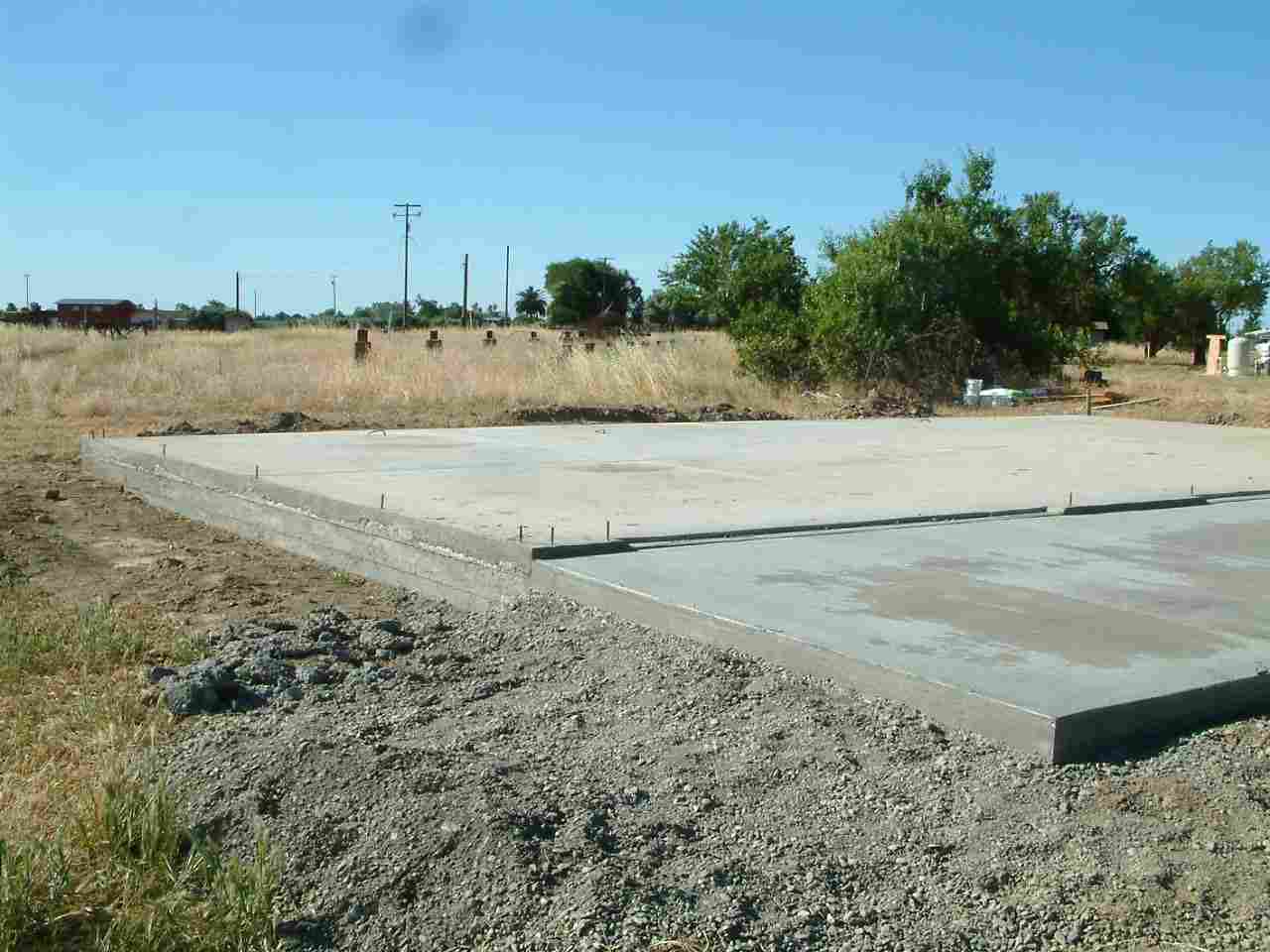

Here's what my garage/shop slab looks like (24'x42', 6" thick, #4 rebar grid 24" x 24", 12' walls, two 10'x10' rollup doors, one window, one 36" mandoor, steel frame, siding and roof). The Building Dept makes us use 5/8" anchor bolts cast in the concrete. I assume that you'll drill the slab and install expansion bolts to hold the structure to the slab.
   / Building Garage 30'x40'x15' #19
Re: Building Garage 30\'x40\'x15\'
Hey Big_R_JR_3, Is there any steel besides the edges? Is that the type of concrete that has fibers in it? My brother built a 40 by 60 metal building and used the fiber type concrete but also used rebar. Just curious.

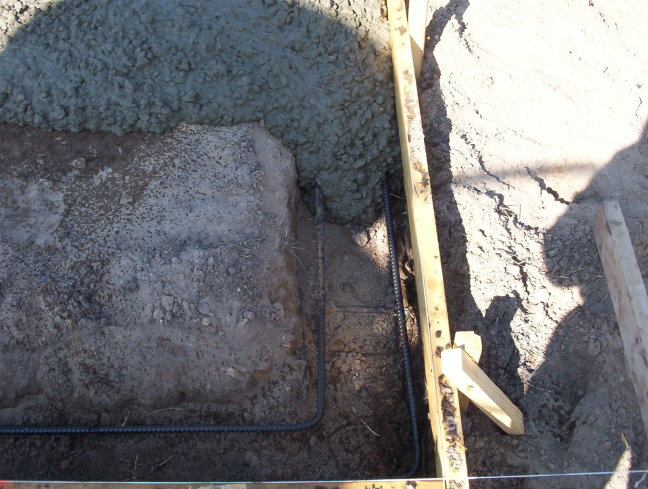

Flusher---- we used monolithic concrete footing (2500 psi) reinforced with 2-#5's rebar continuous. The slab is 4" thick & the footers are 12"deep x 12" wide continuous.........we will install 1/2" x 8" expansion anchor through base rail within 6" of each bow..... Base rail will be 2.5 x 2.5 x 12 Gauge continuous........
Humbleto---No other steel in concrete, or edge & no mircofiber...
