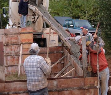

Boy, I'm wishing I could have used your building methods up here, it would have saved a lot of money. Here's how I had to start.
