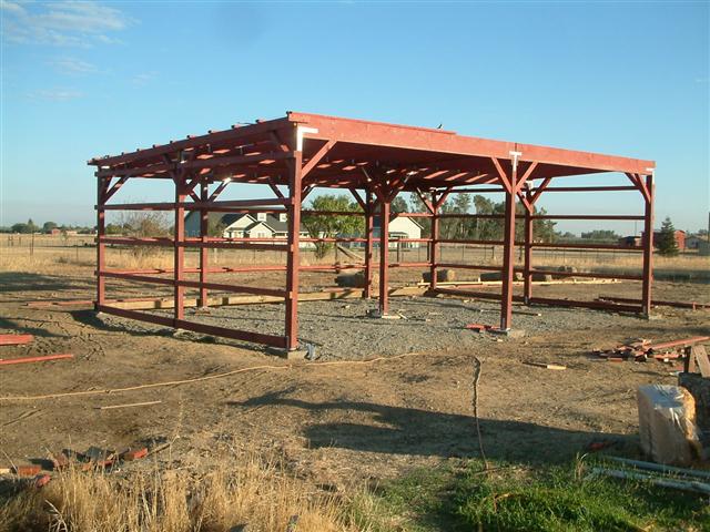

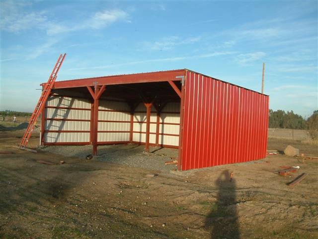

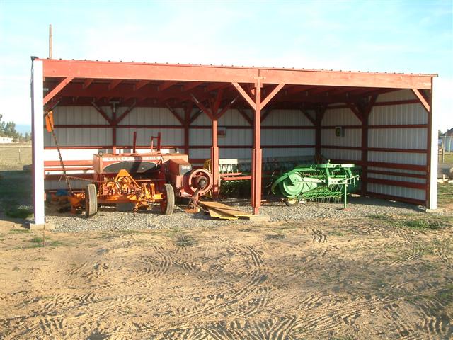

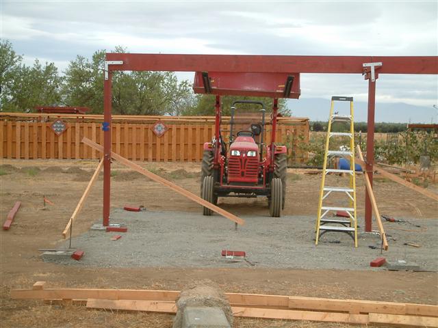

I built this 20 x 28 ft equipment shed--pole style working alone a few years ago (at age 67). Roof is 10 ft in front sloping to 9 ft in rear. Concrete footings are 18"x18"x18" using a cheap mixer from Harbor Freight. Posts are 4x6 ft pressure treated. Beams are doubled 2x12 (nailed and glued) in front, doubled 2x10s middle and rear.
Metal siding is 29 ga R-panel 3ft wide x 11 ft long.
Equipment shed-1.JPGEquipment shed-2.JPGEquipment shed-3.JPGEquipment shed-4.JPG
You can adapt this style of construction to your garage.
Good luck.
