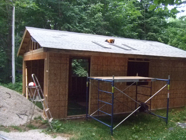

update for anybody interested, went with blocks, for the floor of garage, just using limestone, that`s it:)
Hope the picture took
   / BUILDING GARAGE BY MYSELF NEED HELP? #39
Looks great! Nice job you have done there!
   / BUILDING GARAGE BY MYSELF NEED HELP? #40
Looking very nice ! Keep up the good work ....
