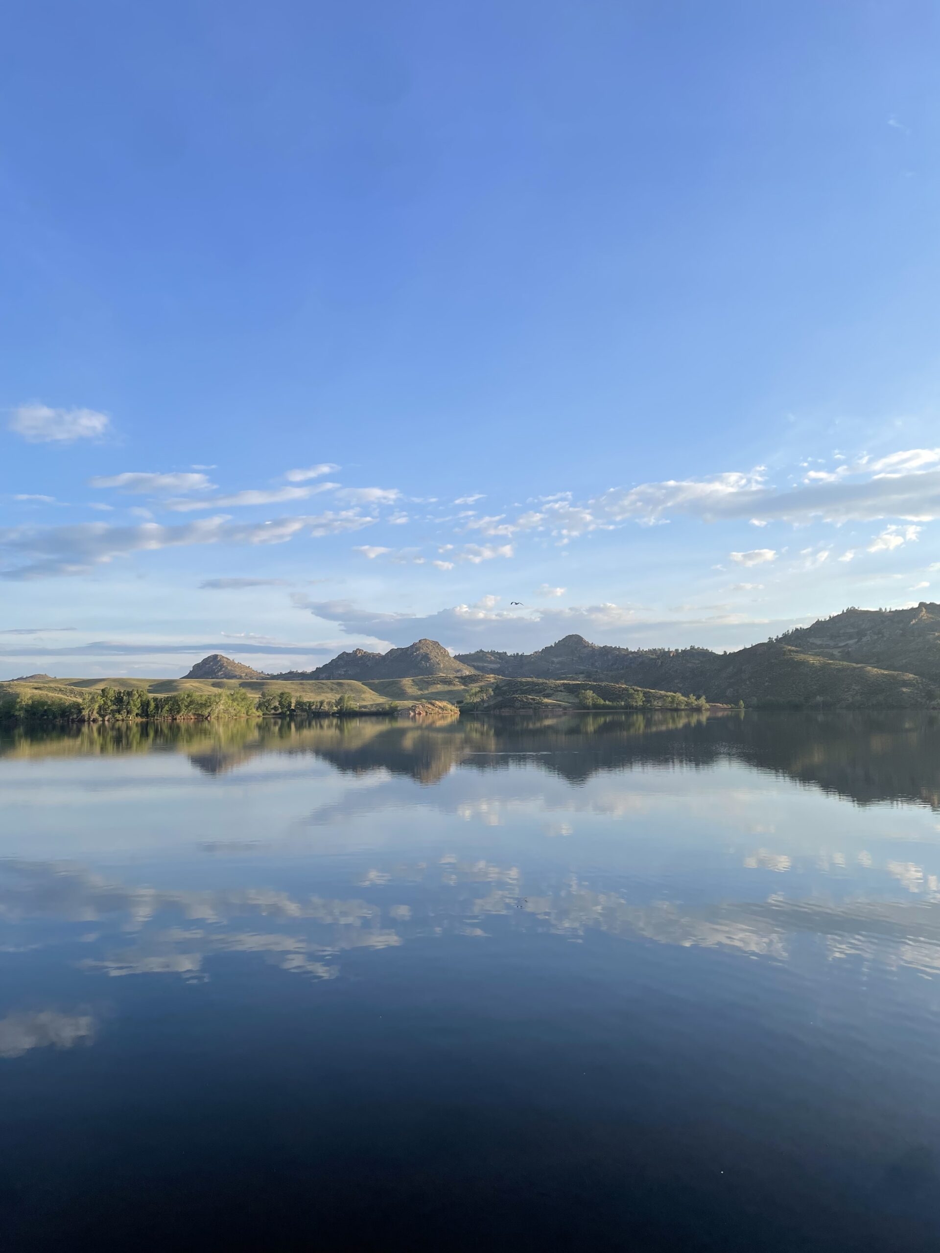

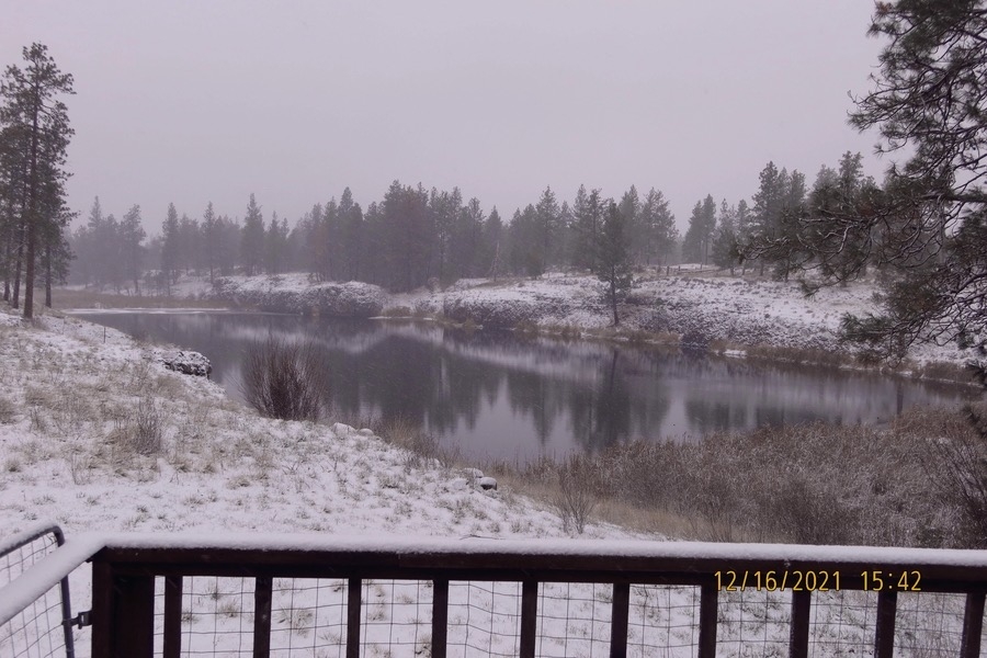

My little lake - Martin Lk - ten acres. Five acres - open water / five acres - cattails. It's 80 feet deep and was made by Mother Nature. This is the view off my front porch. Yes - it was cold when I took this shot.
