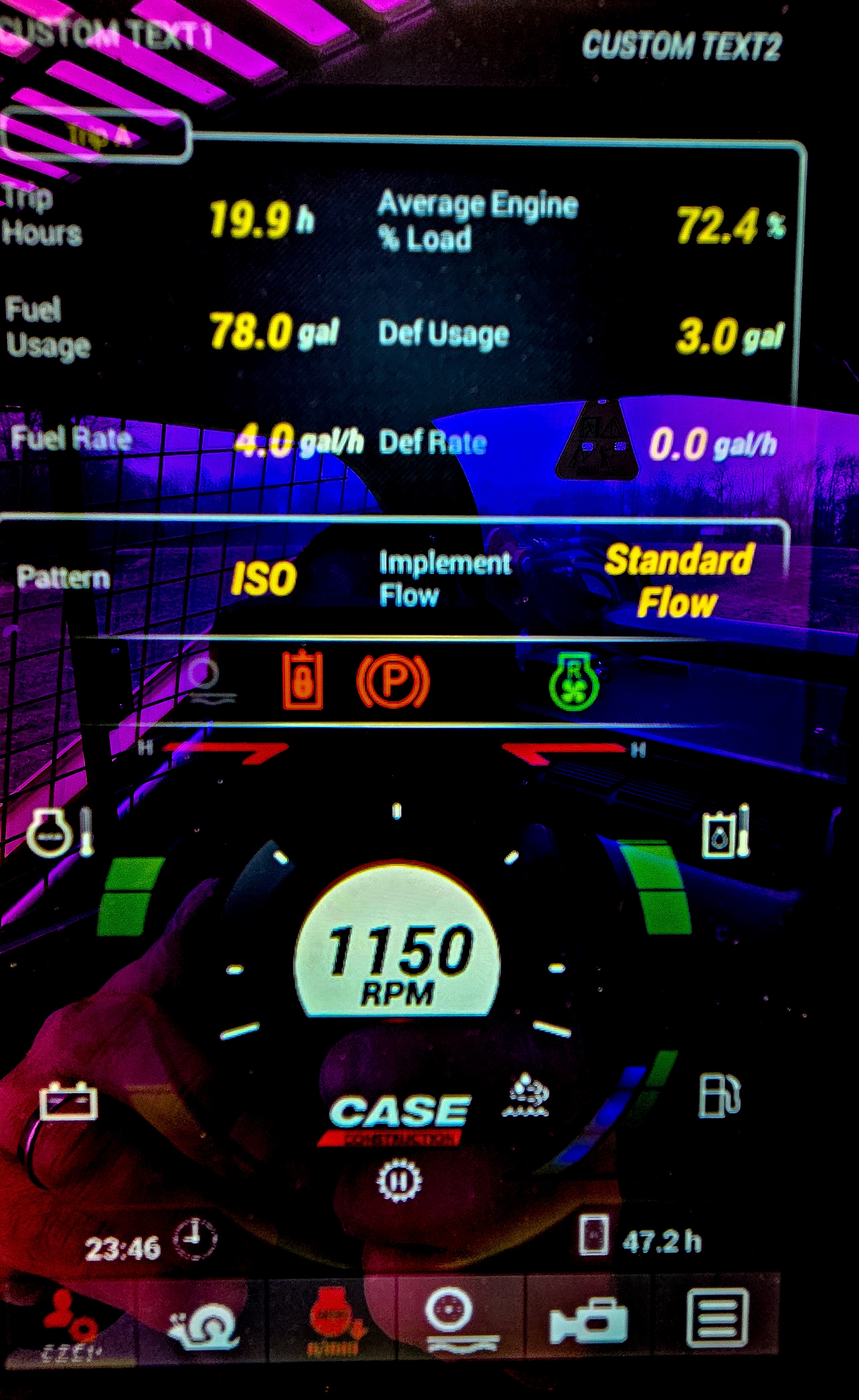

Removed most of the growth on the dam and spread a layer of clay on it today. I was able to track it in pretty well. I will say it's a hell of a ride if you back up too far and too fast at the top of the dam. I need to pick up a 45 degree elbow for the end of the inlet to get it off the pond basin. Looks like the rain missed us. Tomorrow I'm going to spread some clay on the side banks and hopefully pickup the vibratory roller on Tuesday. At the moment I'm about 20 hours in on the rehab including mucking it out. 78 gallons of fuel and burning about 4 gallons an hour according to the trip meter.

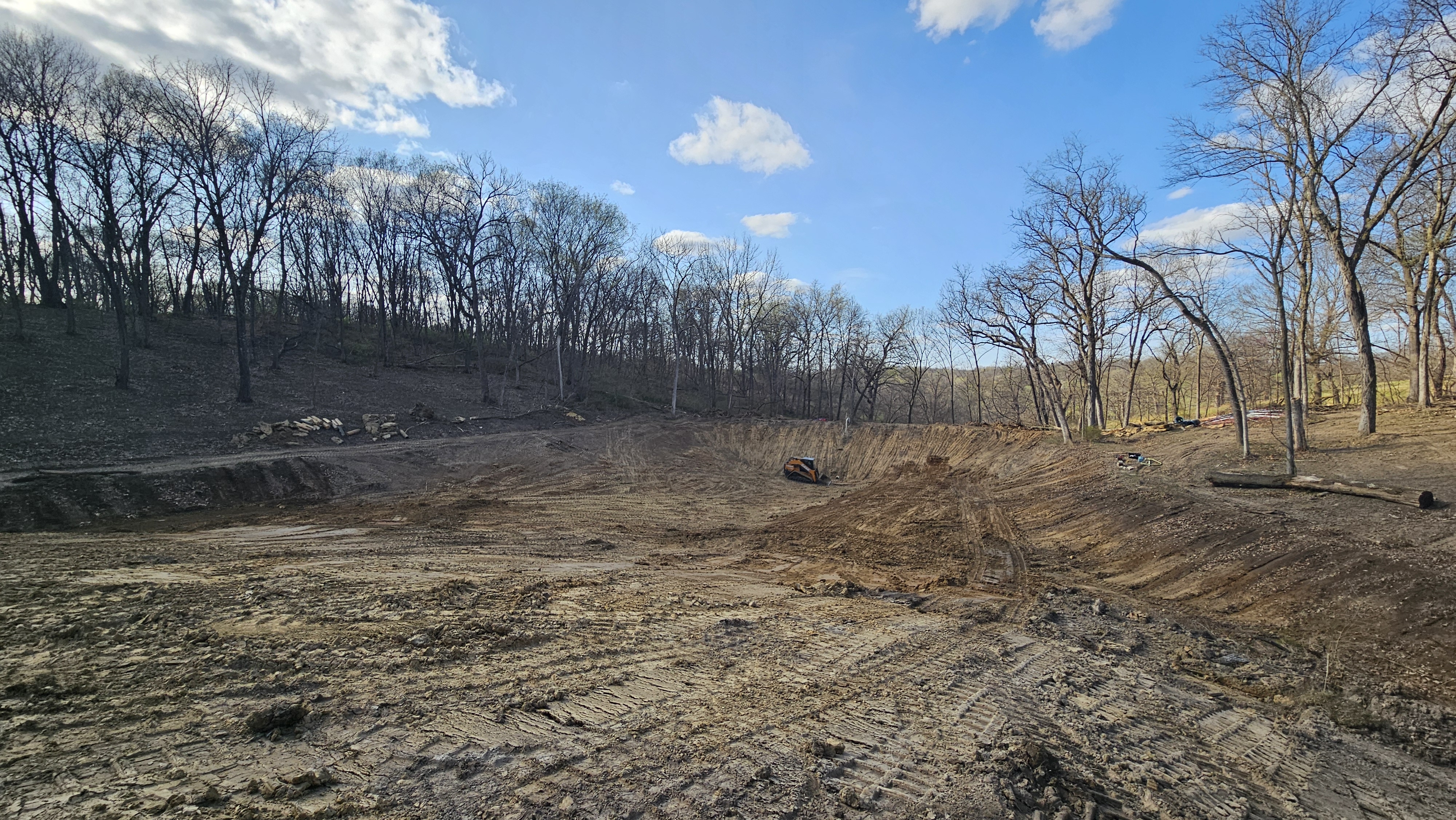

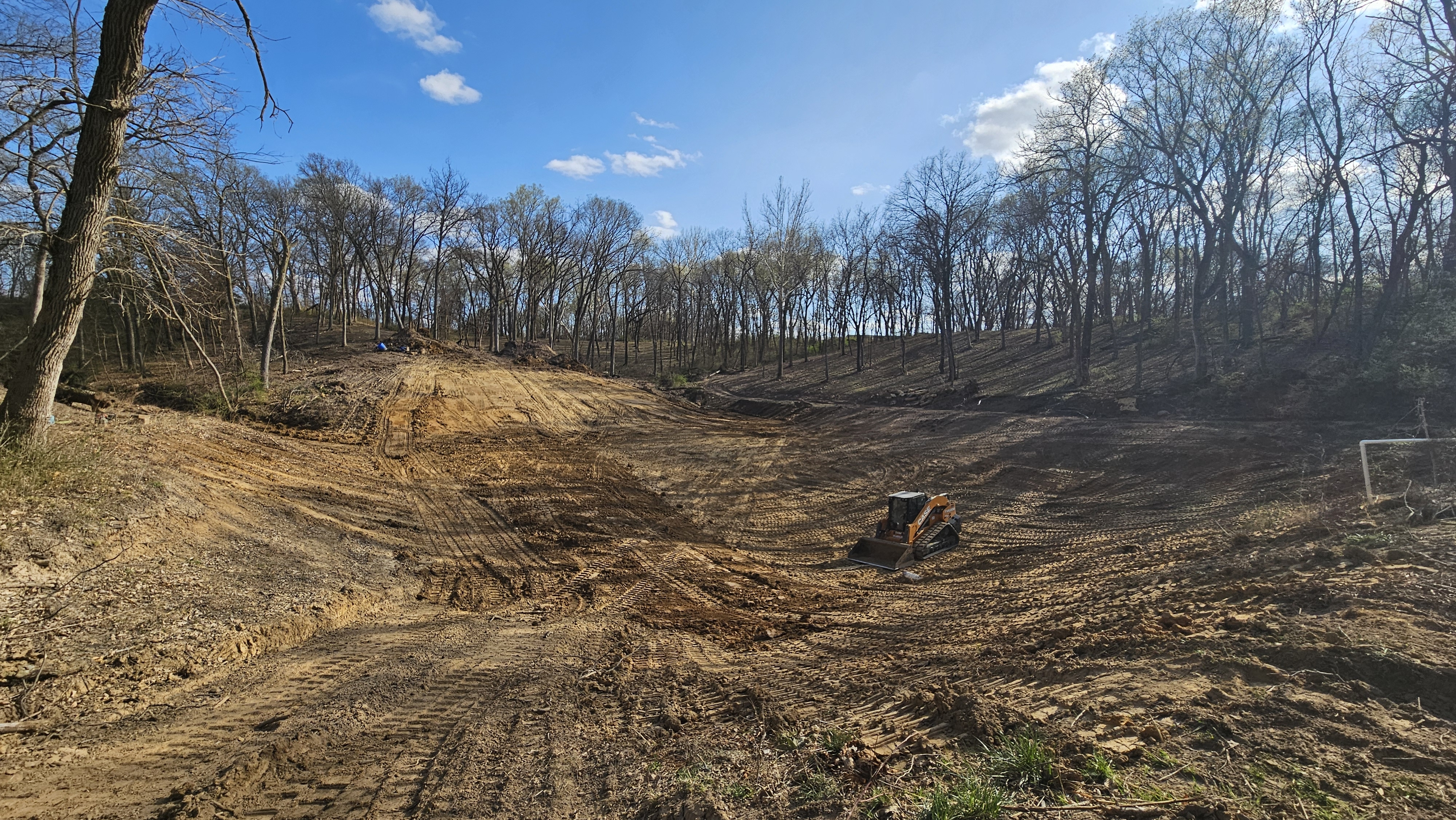

A few final pics before compacting. Picking up the roller tomorrow. My time this week is limited and rain moving in Friday and Saturday. I'm planning to compact tomorrow. If I can I would like to get bentonite down and mixed in at least on the lowest portion of the pond basin so if I do get some rain I don't have to completely drain it and wait for it to dry out again.
