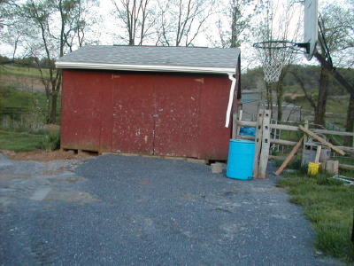

While waiting for building permit to build my house, I built a 12' x 16' shed. for floor joists I used PT 4x4s, 24" oc, leveled on blocks.
Used 3/4" TG flooring, and framed the rest conventionally. I've park my massey ferguson tractor in it for 8 yrs now, plus riding mower, tiller, etc.. . No problem with the floor, no give.
Some day I want to replace it with a nice 3 bay pole garage, but that will have to wait....
