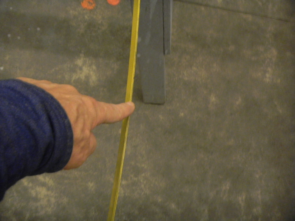

The PE / engineer that helped me with my bridge crane, explained how beams fail to me like this. Think of the beam as a yard stick. You push down in the center of the yard stick, what does it do? It bows off to one side or the other, before buckling. The flanges of the beam keeps this from happening. For my 24-feet span he said the S-shape was going to be to tall, so he suggested I get a Wide Flange beam. Rip an S-shape beam, and skip weld it to the bottom of the Wide flange beam.
I have no idea how many beams I've added flat bar to the flanges to increase the capacity of the beam.
Same thing I said in #55
