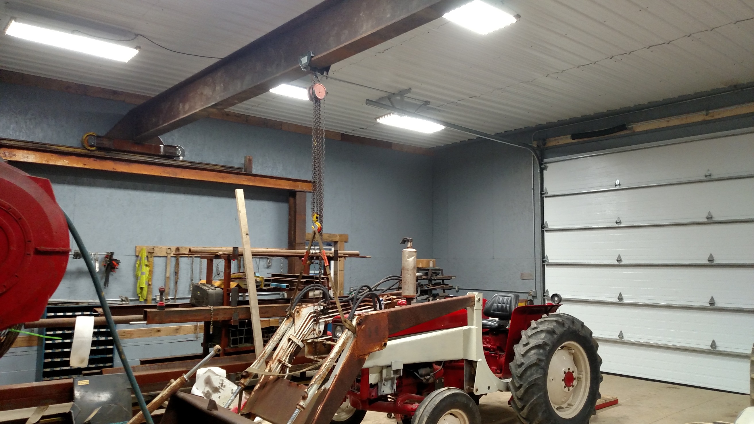

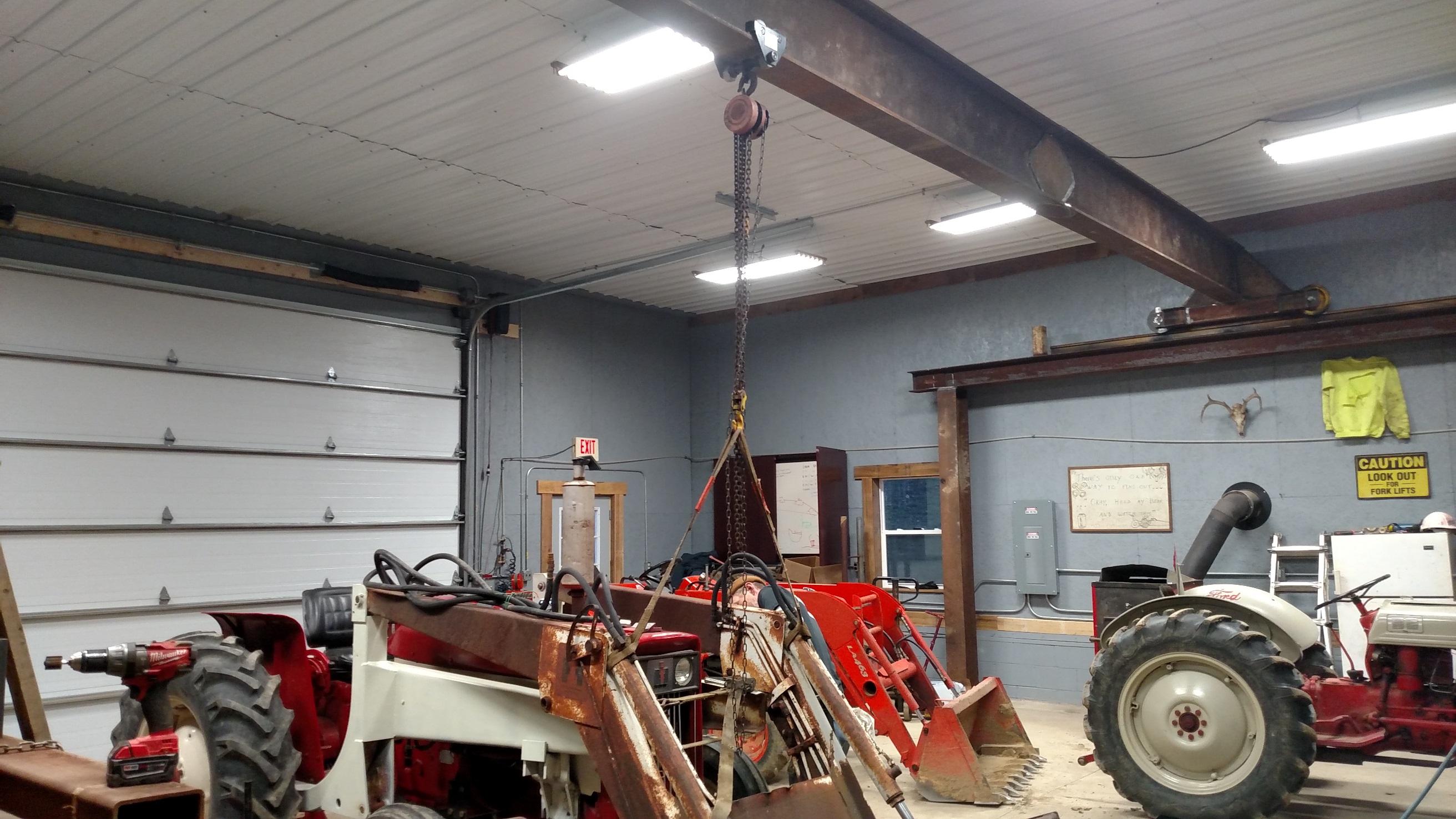

Used the crane last night. working on installing a ~1000# loader on dads 444

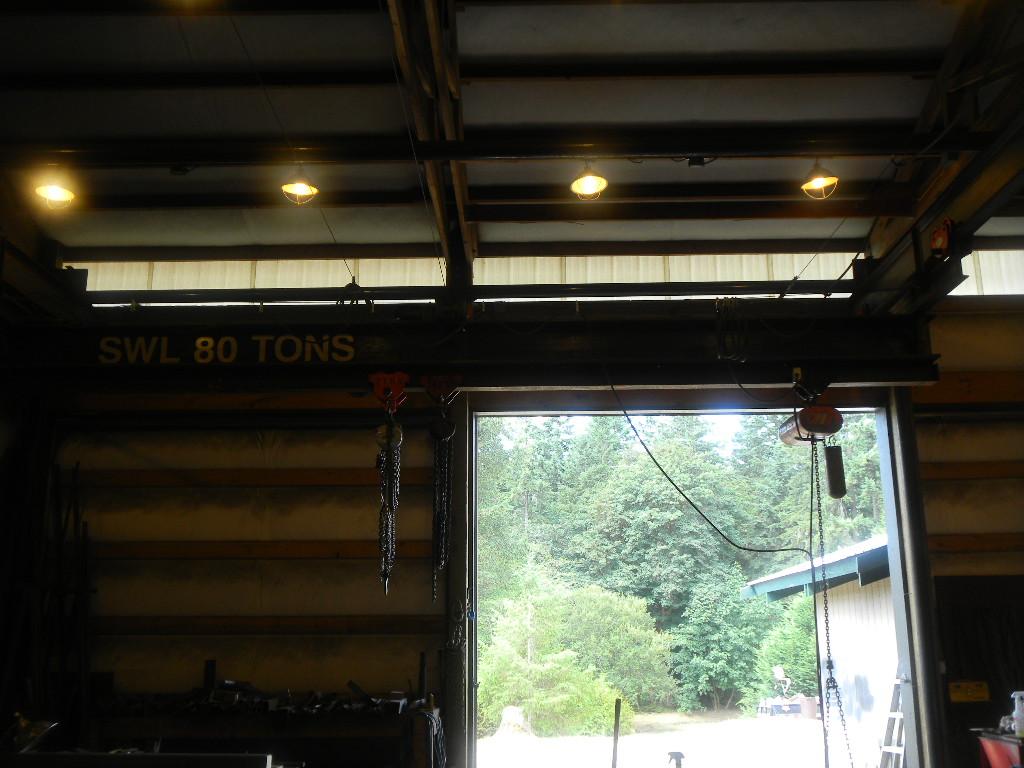

   / Building my bridge crane #76

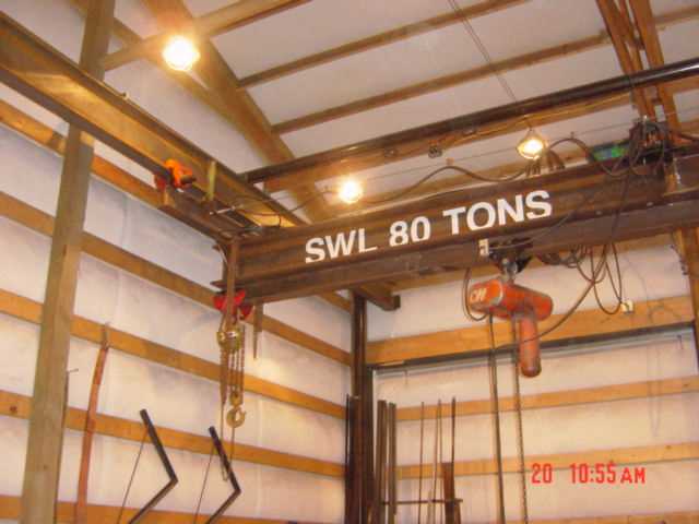

Hard to see in this pictures, I have an electric hoist, and two chain falls. One 1/2-ton, and one 2-ton chain fall. Sometimes you need more than one hoist to get a job done. :D

   / Building my bridge crane #77
And even with 3 hoists, you are safely under the "SWL" for that crane. LOL :laughing:
   / Building my bridge crane #78
My span beam started out in life as a spreader bar. To set pre-cast concrete utility vaults on Pier D aircraft carrier dock in the local Navy shipyard. Didn't cost me a dime, just had to go pick it up, cut it to length, and make the weld in the center.

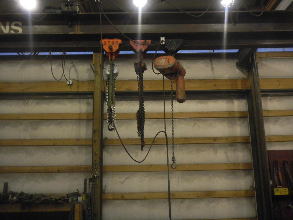

Took a better picture of the hoists this morning.

   / Building my bridge crane #79
So that's where our tax money is going!
