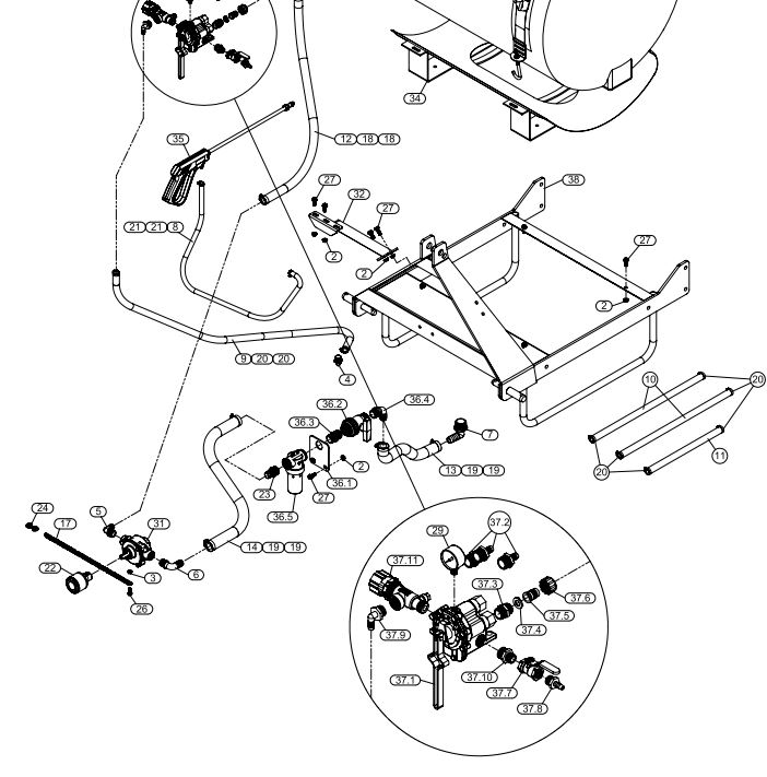

I finally decided to order a Fimco 110 gallon sprayer in June. From Tractor Supply. They do not carry this model normally so they had to special order it from Fimco. It took about 6 weeks before it arrived. One of the guys at TSC assembled most of it, I had to assemble the rest. By then I was busy bush hogging so I used it earlier this week for the first time. It has 30 foot booms. Now, after using it and hitting fence posts and trees, I am wondering if a boomless sprayer would have been a better choice. I was thinking that this would have less spray drift. I am mainly spraying 2,4d.
The main problem I had with the assembly was filter. I was mounted on the sprayer in the center and pointing forward. When I lowered the 3pt hitch, the filter sat on the drawbar and would have smashed it if I had not stopped lowering. And being in the center, it is directly behind the roller pump. I made a bracket and mounted it sideways so the hose could then come around to the inlet side of the pump. That's another thing, they have the inlet and outlet sides of the pump reversed. I have attempted to upload their assembly drawing. Here below.
