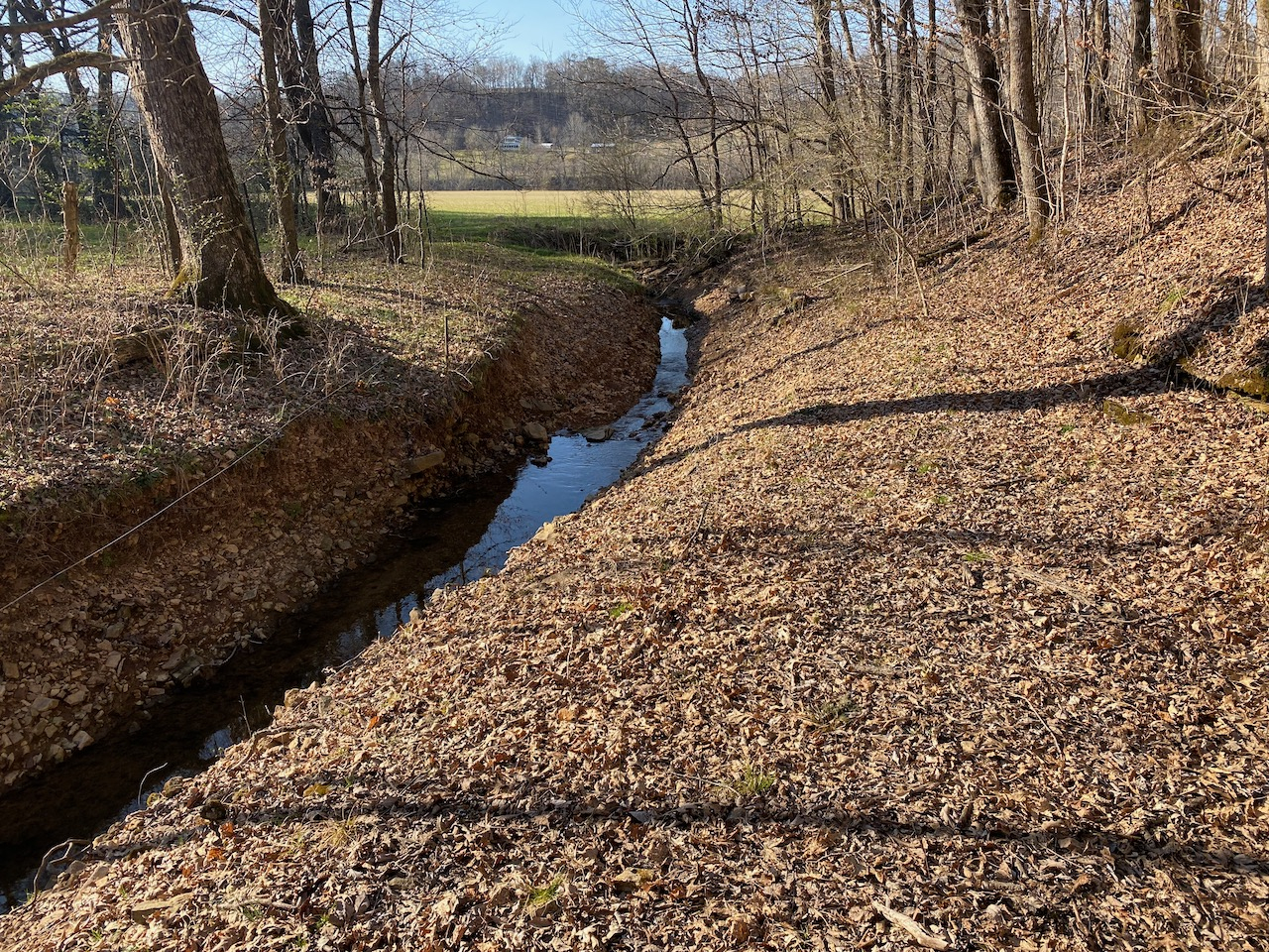

Thanks Deezler. Like I said I'm new here and haven't caught on to conversing with folks yet. I'm glad you posted this since I want to share these ideas/questions too. Thanks for the stick drawing. I see now what you meant by chaining the pole to your bucket. I thought maybe that would be too much cantilevered weight sticking out that far.
I will try to post photos of the the 2 creek crossings I hope to conquer, may need help just posting the photos.
I have already learned some things from the other folks posting in this thread, look forward to more of the same

The other thing I had considered doing was buying a pair of treated 16' 6x6 posts to use as additional beams going across, probably on the outer edges, but that would have been expensive and a little complicated logistically (hauling them home on my 12' trailer, or paying for delivery, and then my bridge abutment walls would have had to be located ~a foot closer together, too.)
Re-scanning the thread and counting 2x6s in pictures I was guessing your span to be 15' or a bit more. Guessing the above comment pretty much verifies.
In the coming year or so I am faced with need to span a creek/ditch. Currently 5'-6' deep. Complicated by the need to cross at an angle.

Responding to some other bridge threads reminded me about my own. Still going strong, doesn't get much usage other than by foot or my lawn mower for trail maintenance.
I did end up adding some 16' treated 2x12s to help spread out the load when I drive across. The tread width is sized juuust narrow enough for my tractor.
The only pic I found of this apparently has my kiddos in it. A dead tree had fallen on it (thought I heard a funny "THUNK" from the woods the day before!) and we went to investigate.
And unfortunately the bridge sort of does show up on the latest aerial imagery. Enough to raise concern of any pesky local agencies? Let's hope not.
