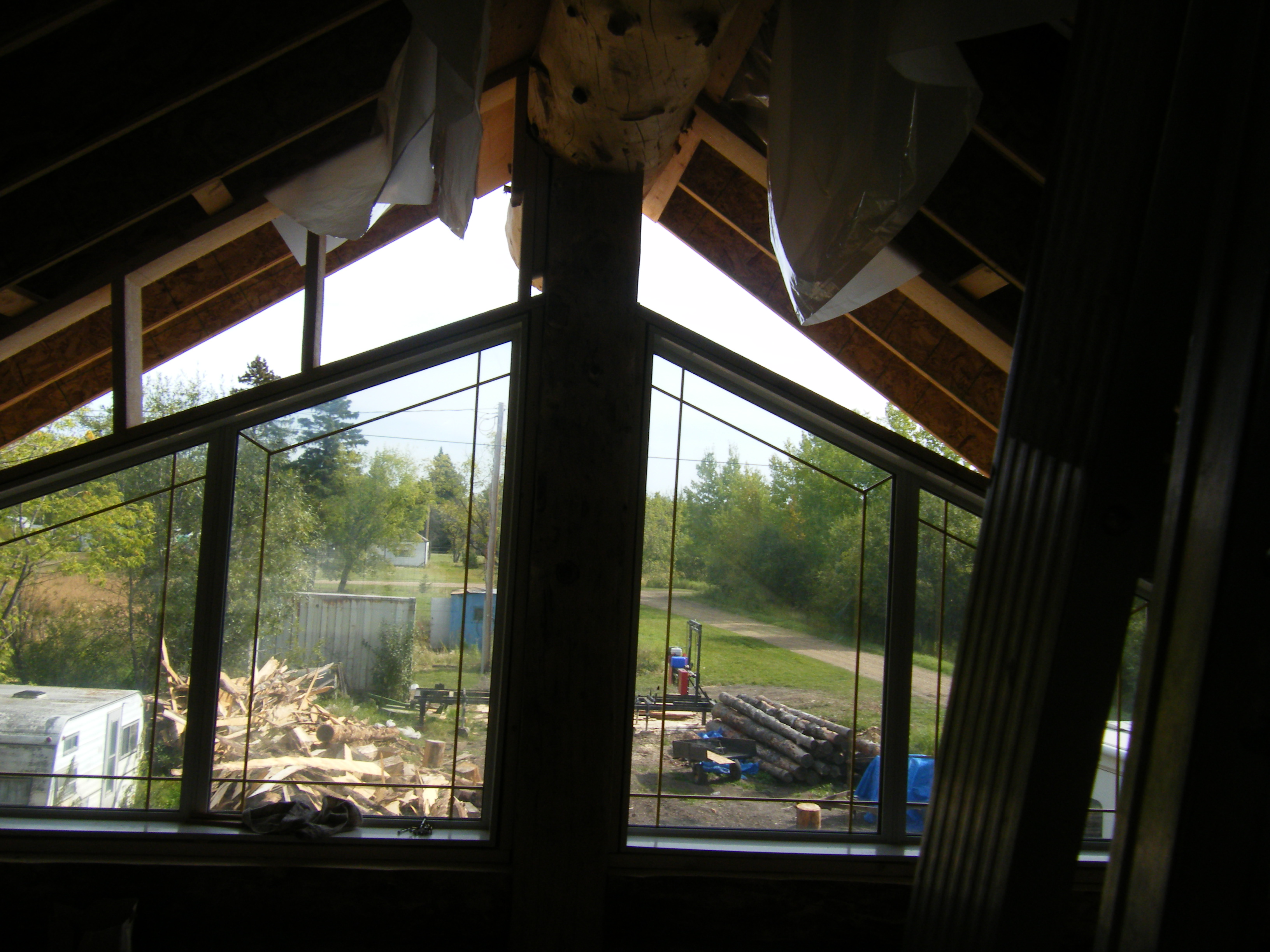

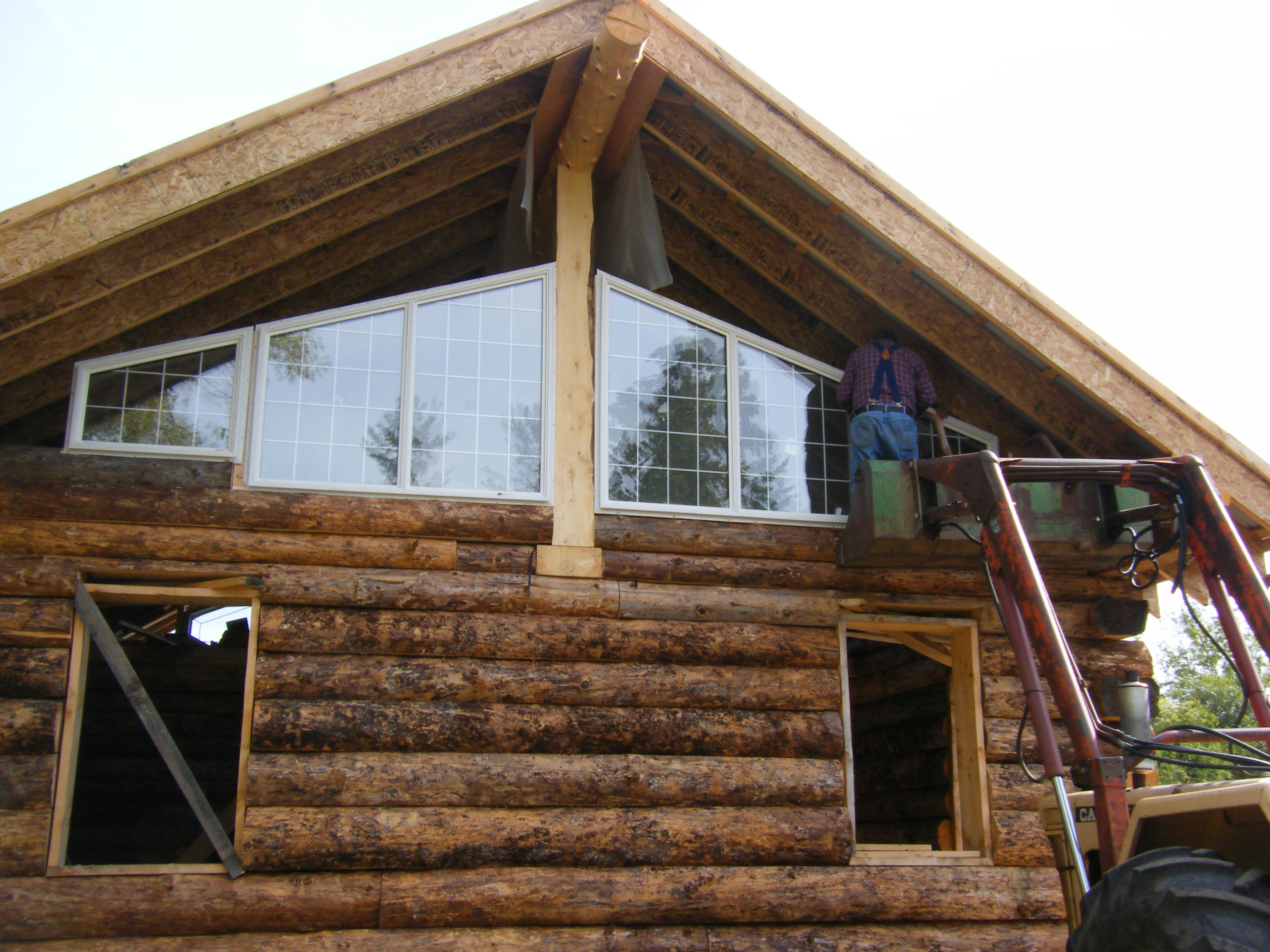

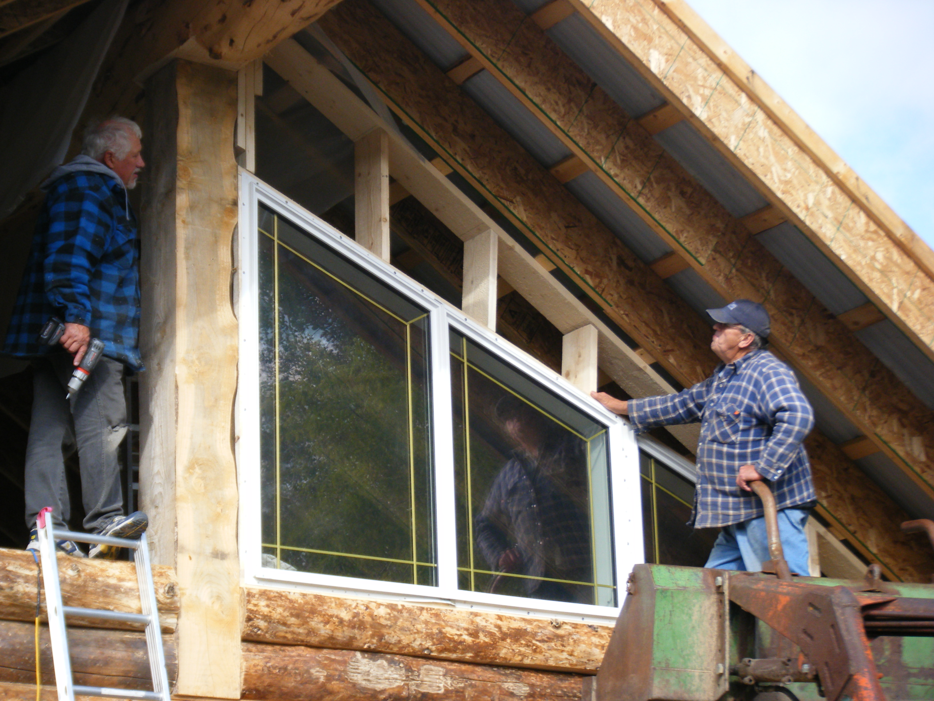

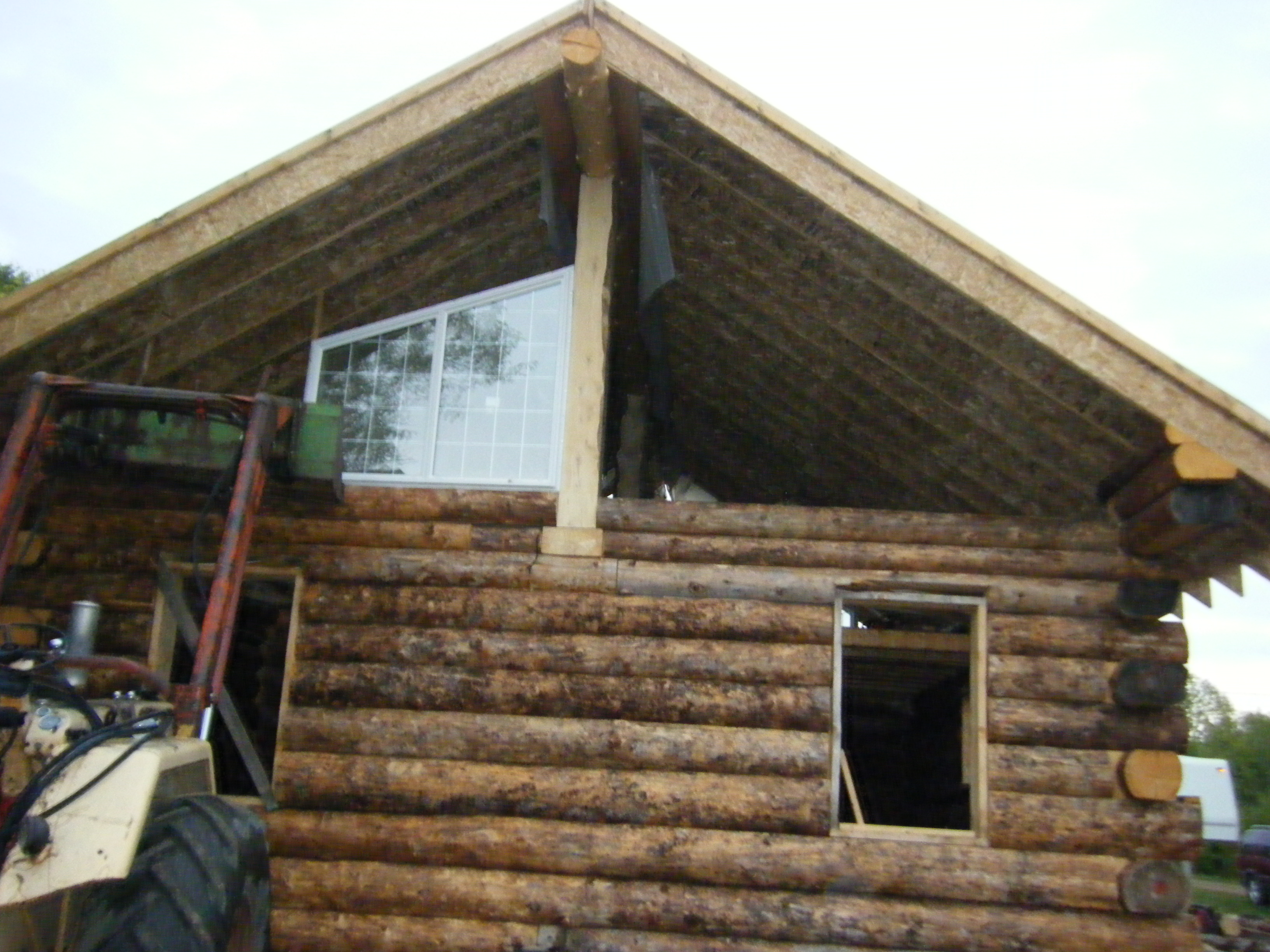

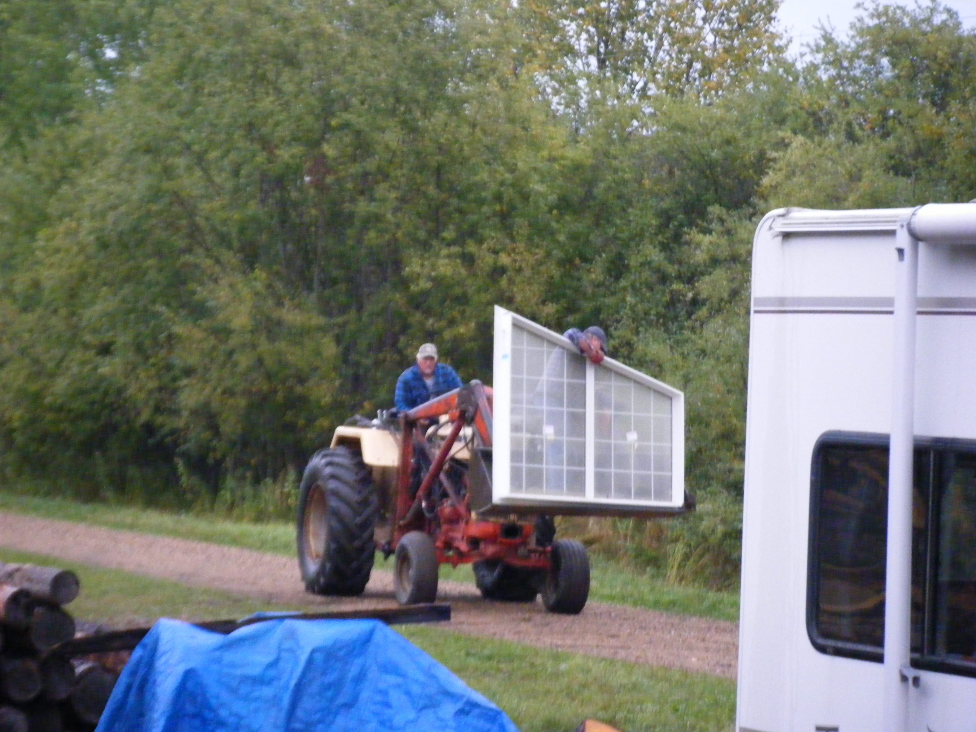

I am posting pictures as I find them in the vast digital maze that they are stored in, so some are not necessarily in order that they were made, please bear with me, These pictures were us putting in the windows with my old 730 case. Special thanks to my brother-inlaw for being brave enough to ride the bucket and holding the windows cabin window 006.JPGcabin window 007.JPGcabin window 010.JPGcabin window 013.JPGcabin window 019.JPG

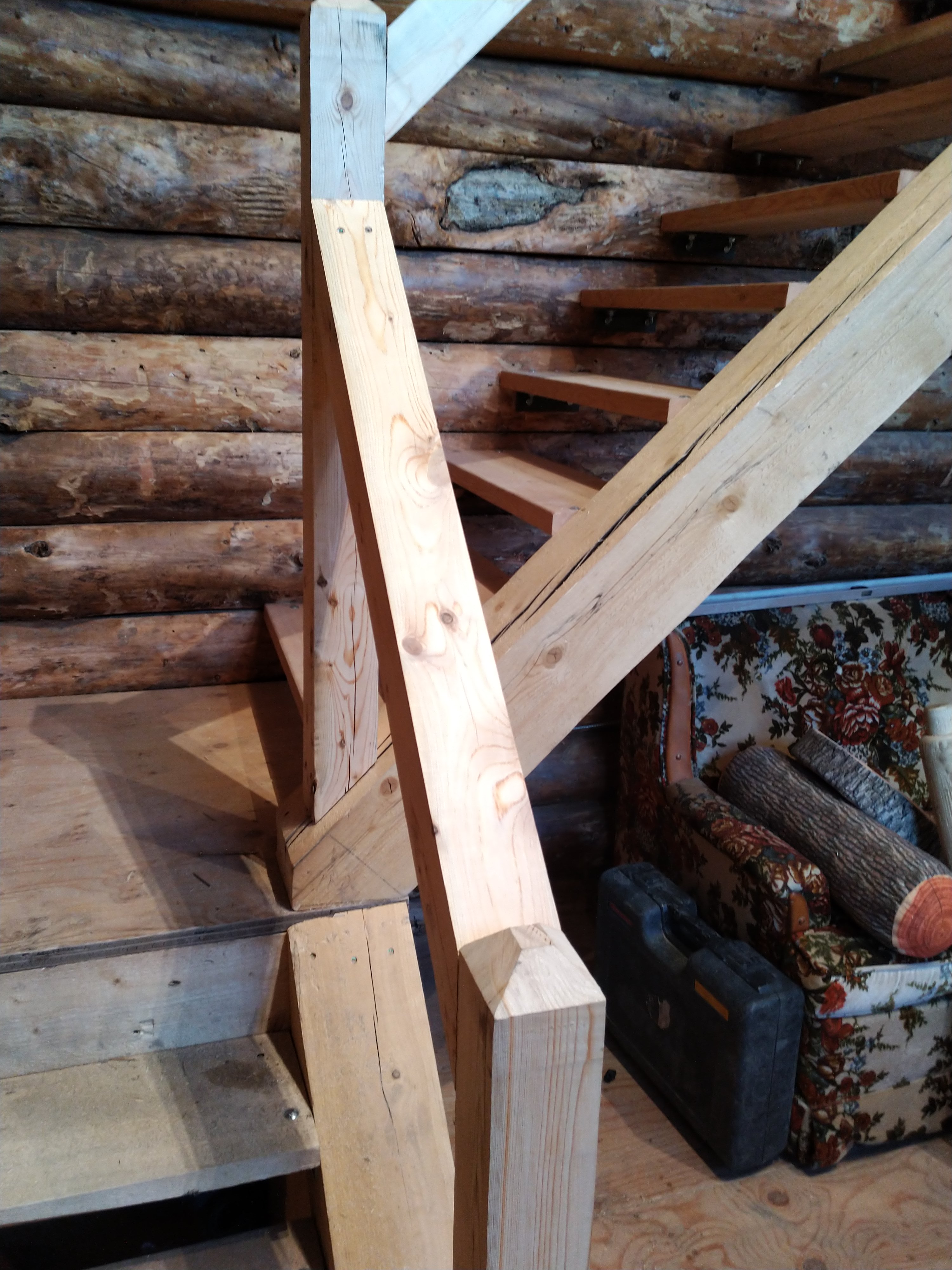

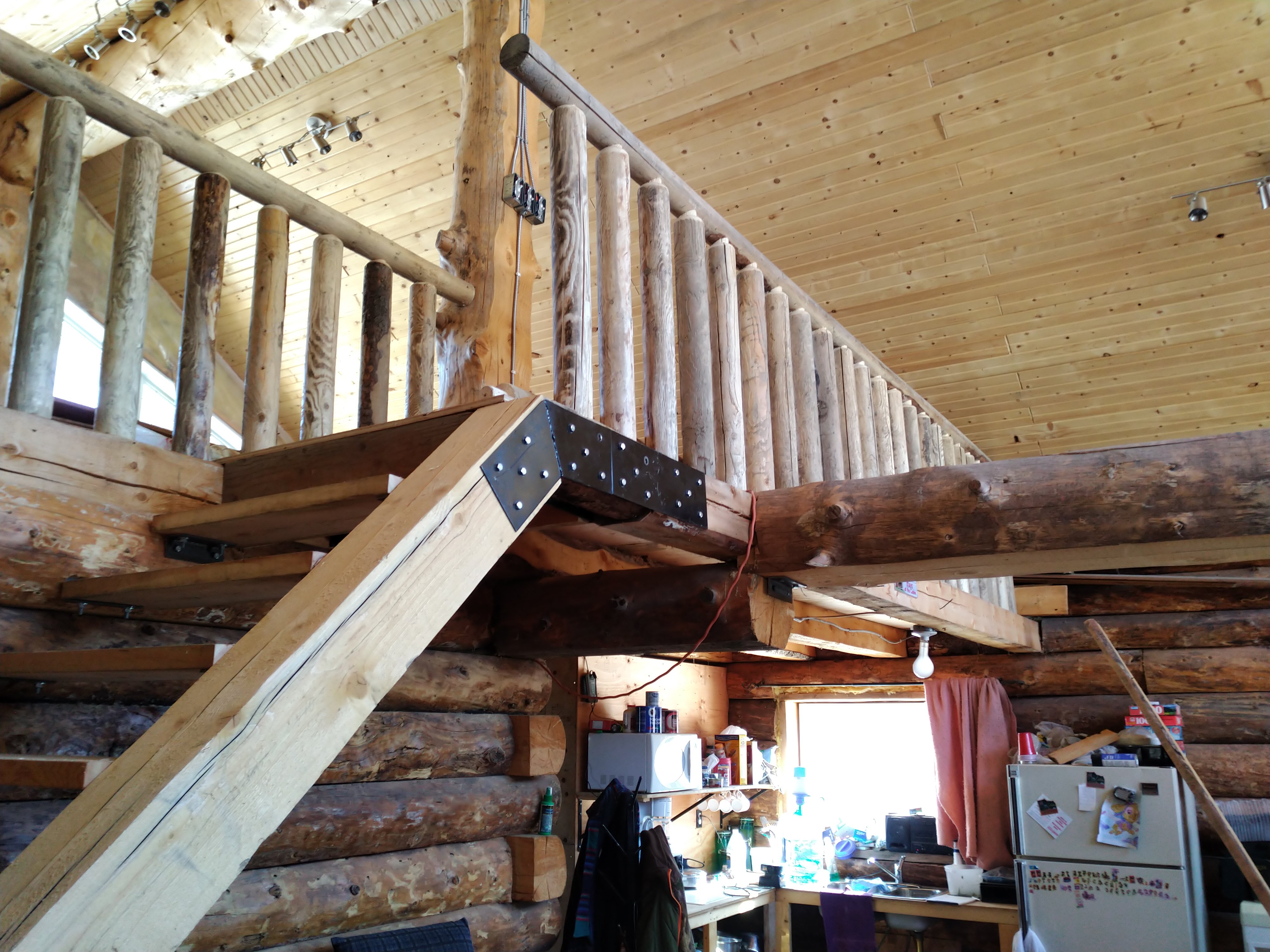

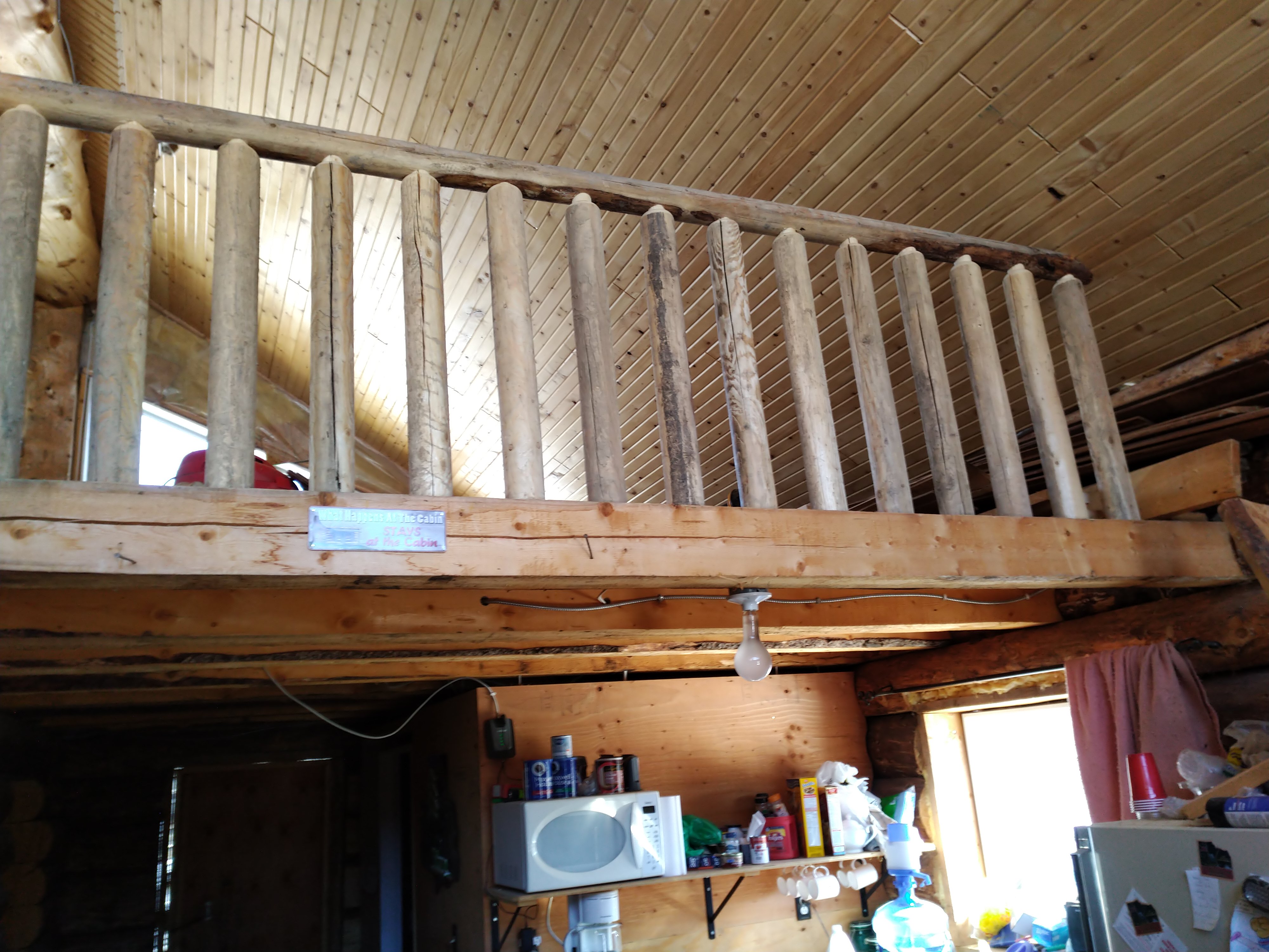

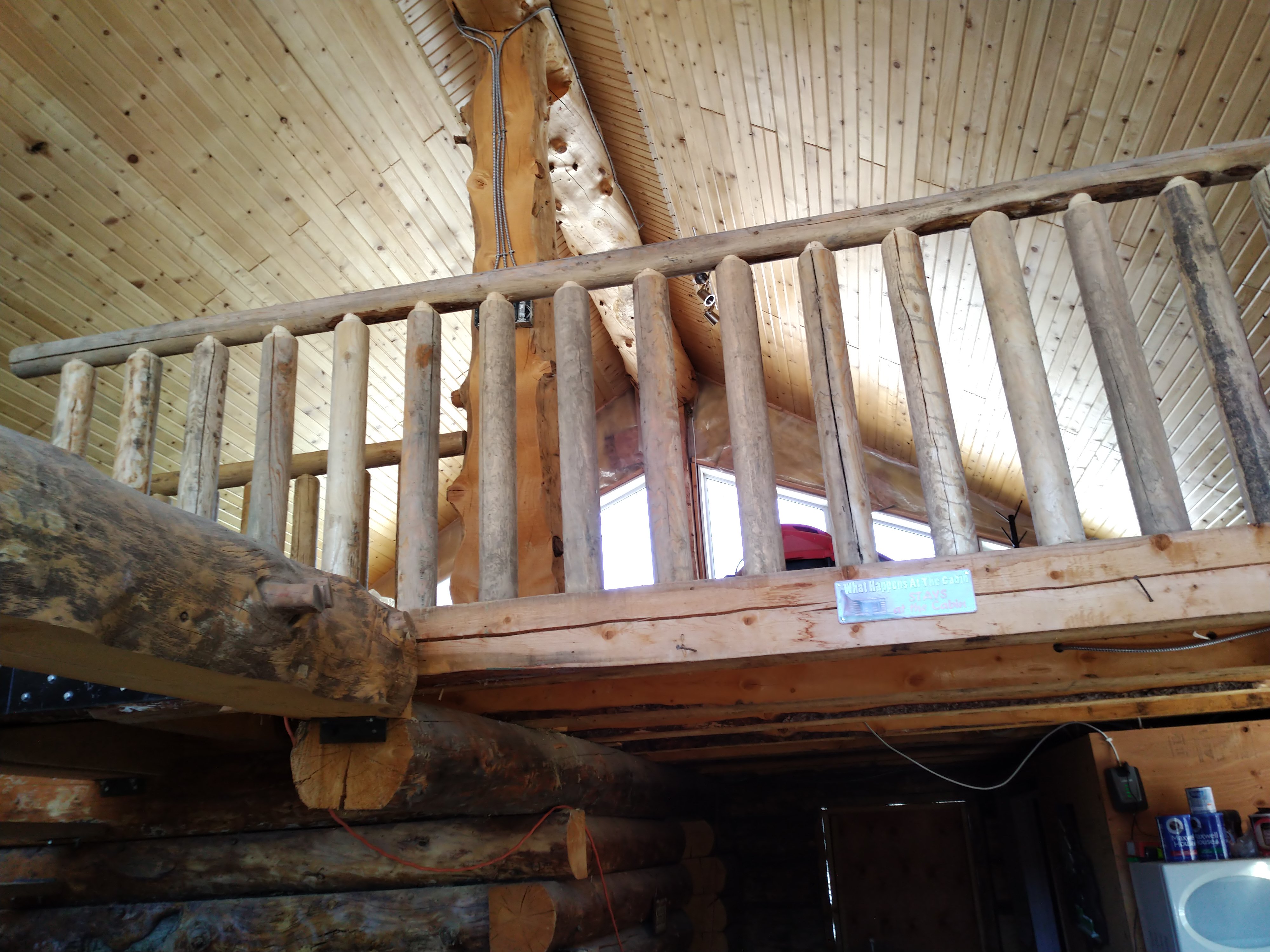

#113

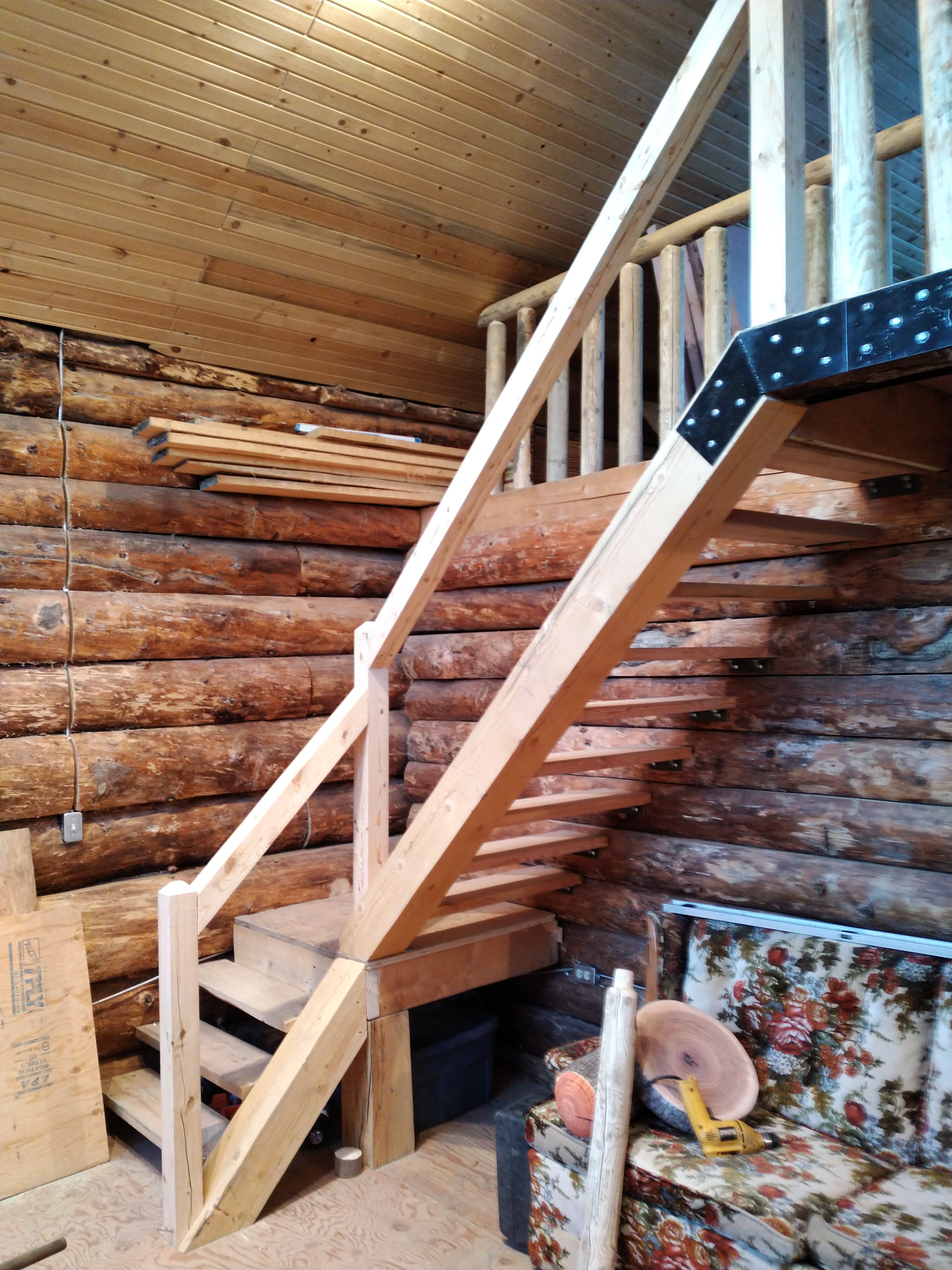

The next pictures are of the stairway, I used milled 8x8 spruce for the beams, 4x4 oak that I had laying around ,planed them and they had a real nice finish to them , I used 2x12 fir for the stairs that I purchased at the lumber store along with tamarack rails that I used for the upstairs railing, I purchased a lathe and lathed all the ends top and bottom . IMG_20190324_185706.jpgIMG_20190324_185724.jpgIMG_20190323_142026.jpgIMG_20190323_142039.jpgIMG_20190323_142044.jpg Not shown in these pictures I put 1" rebar for stair rails drilled into the handrails and beams and painted black.
