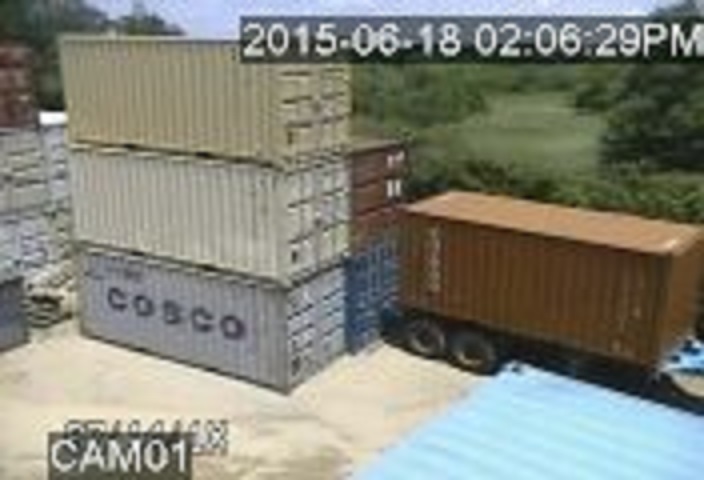

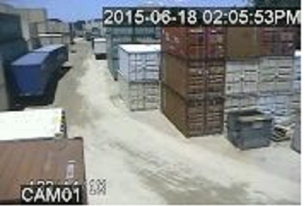

Done a lot of concrete work (more than I ever wanted to actually). If you want a 100 year building get the thickest rebar you can afford and wash your welds and spray them or dab them with Rustoleum. One of my customers owns a logistics company that stores and short hauls these containers. I'll log in remotely & snap a couple a pics with the PTZ (he won't mind):
He has over a thousand on site at any given time and you'd be amazed at the stuff they can make with them. I really like your idea and I'd stack another one on top to give you the ready-to-go height for a good barn or shop with space above for an office or storage.
View attachment 430220 View attachment 430221
As far as your soil prep, I'm jealous looking at your soil with that much natural sand and rock you won't have any issues.
