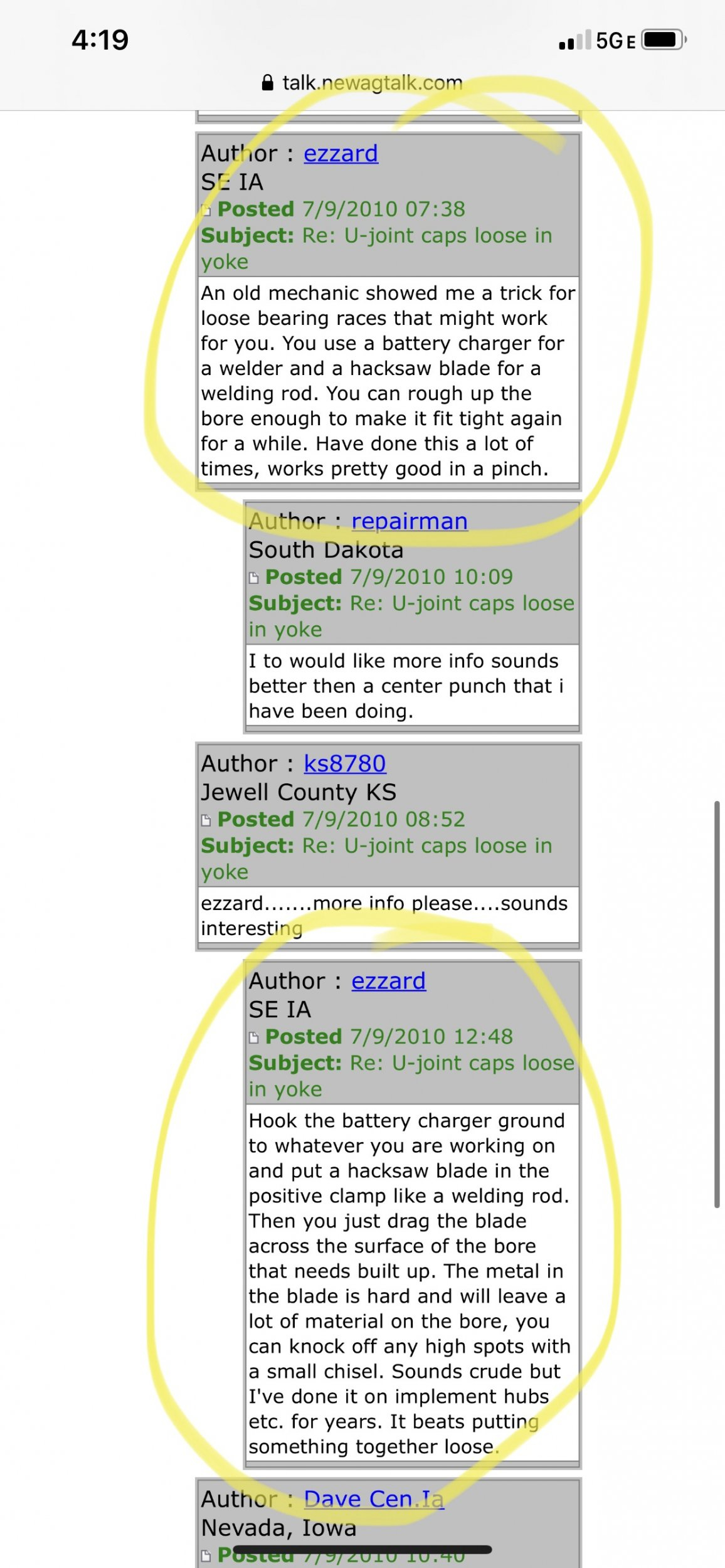

After researching many different solutions I found this. Anyone ever done this or heard of this being done before? Or does anyone have any other solutions that might work they’d like to share?

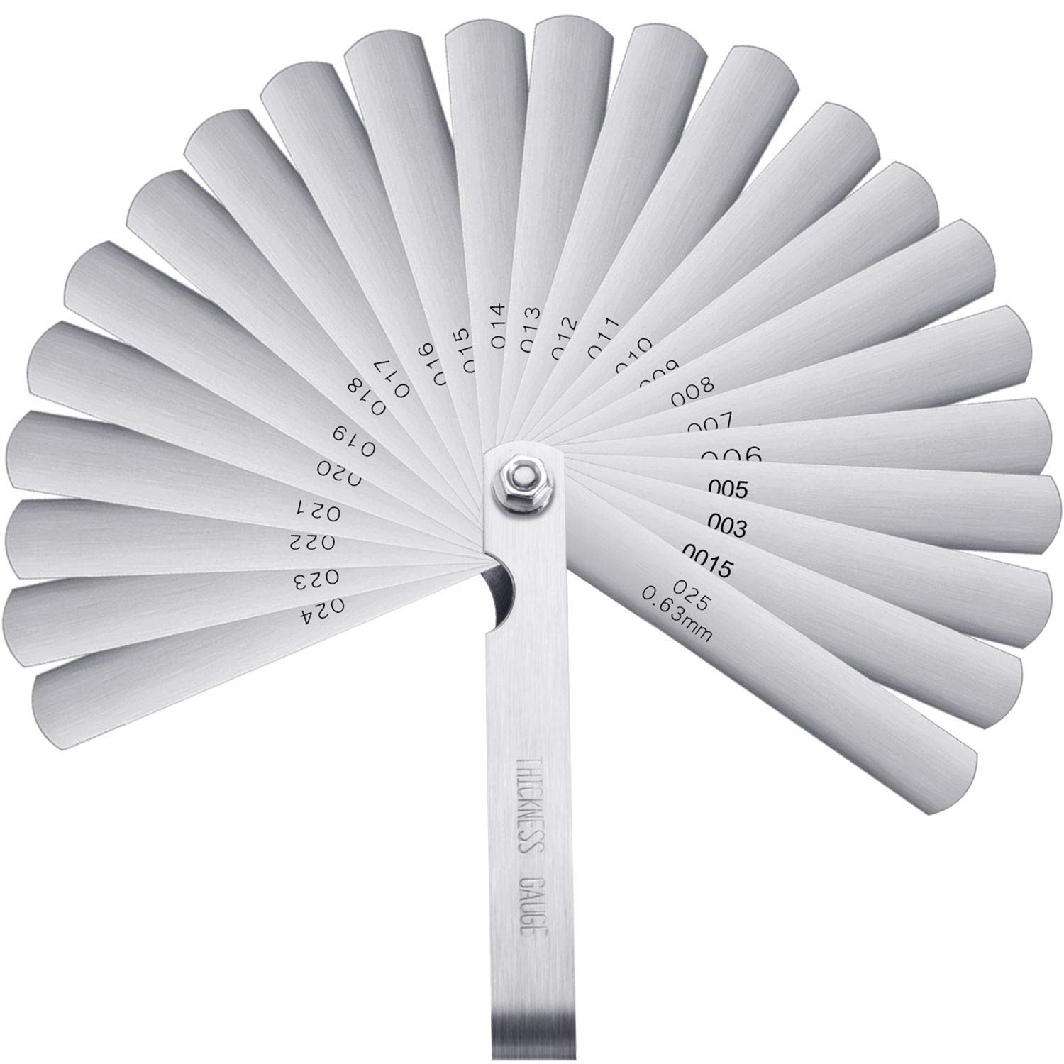

Could buy one of these and use the correct size to put in joint for the time being.

Now that’s thinking out of the box ... I got plenty of feeler gauges laying around. Not sure if I’ll be able to pull it off but might be worth a shot.

You can try to wedge a feeler gauge in between the cap and yoke. But I wouldn't go very far before checking to make sure it's not working it's way out.
