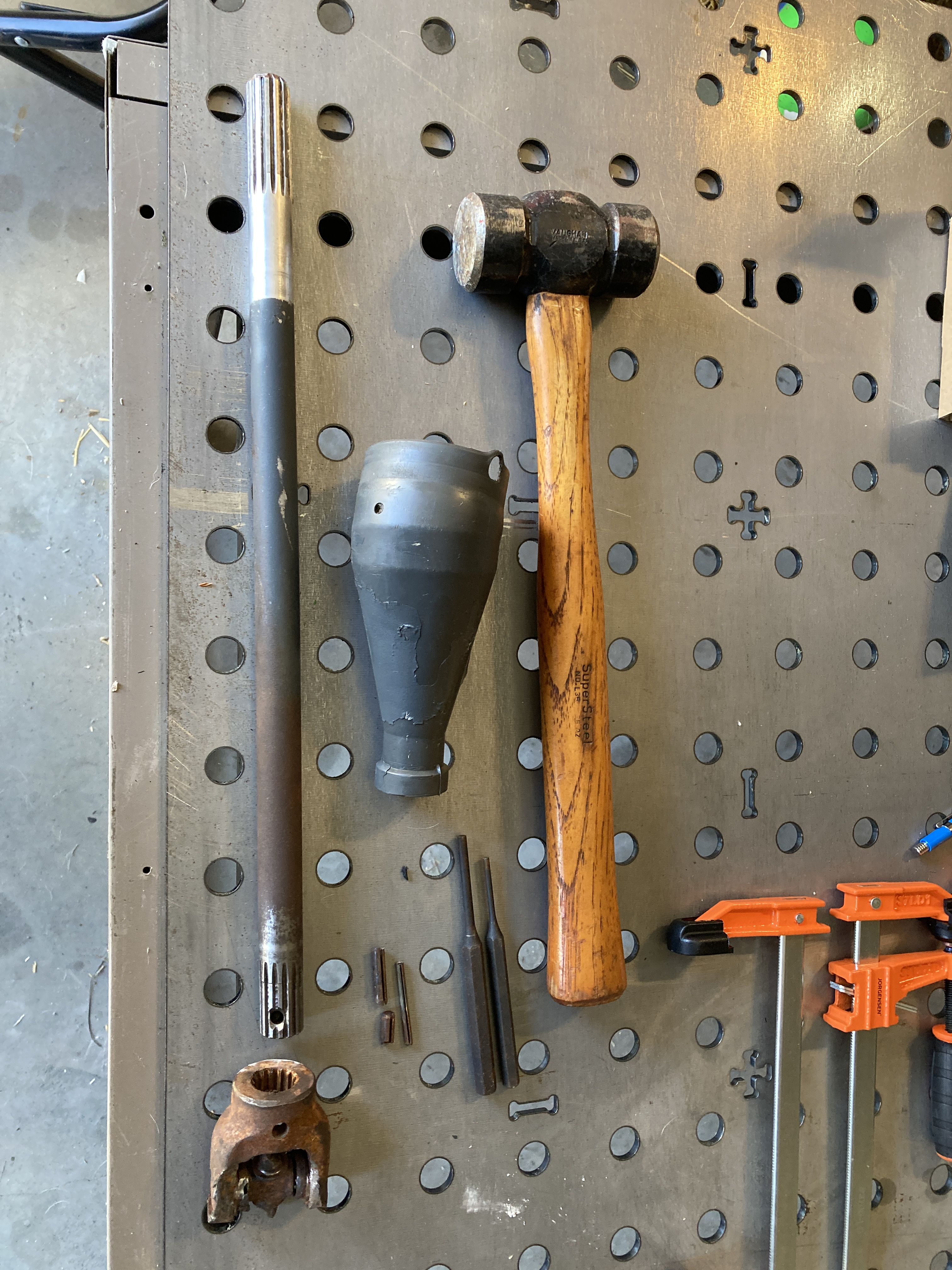

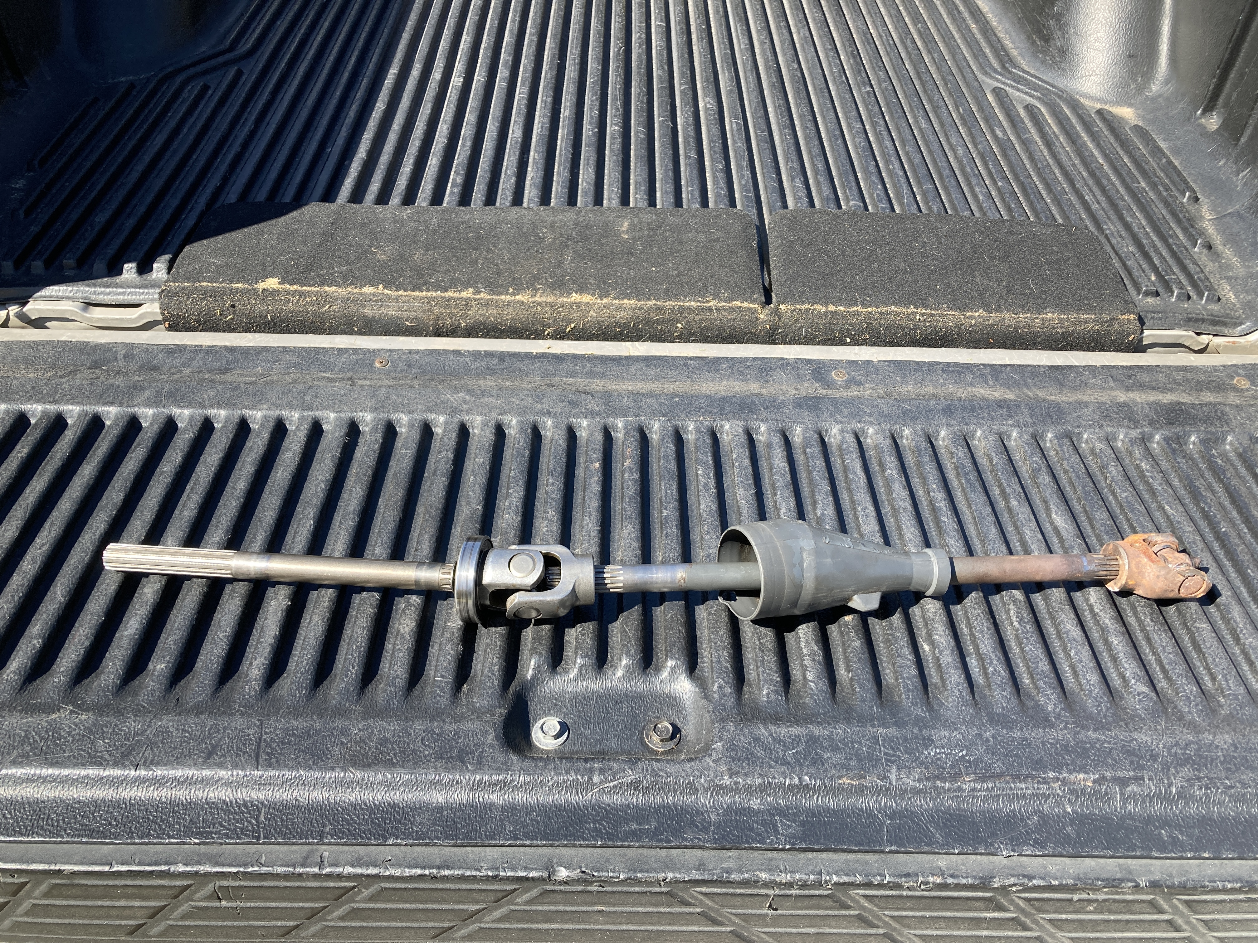

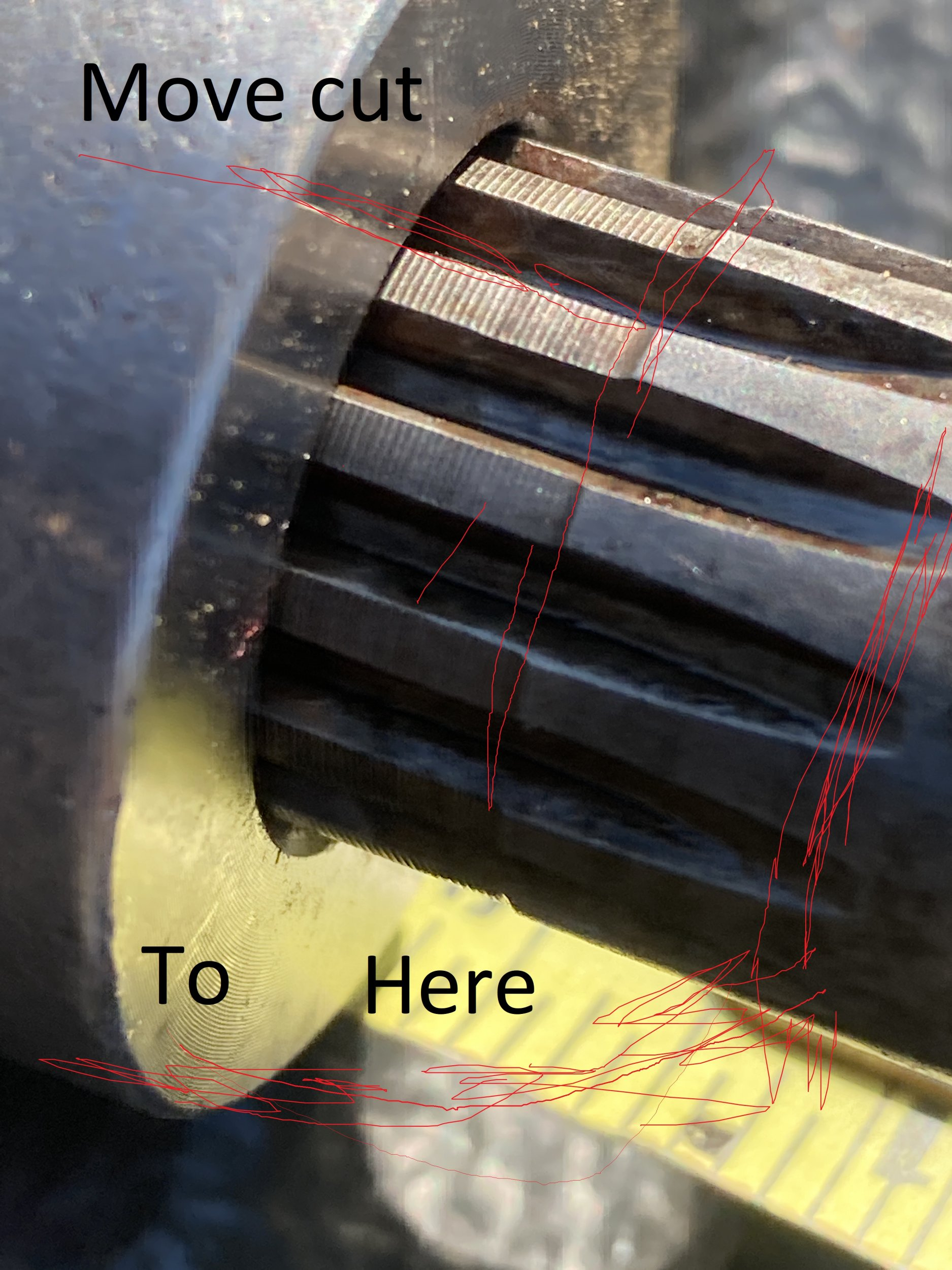

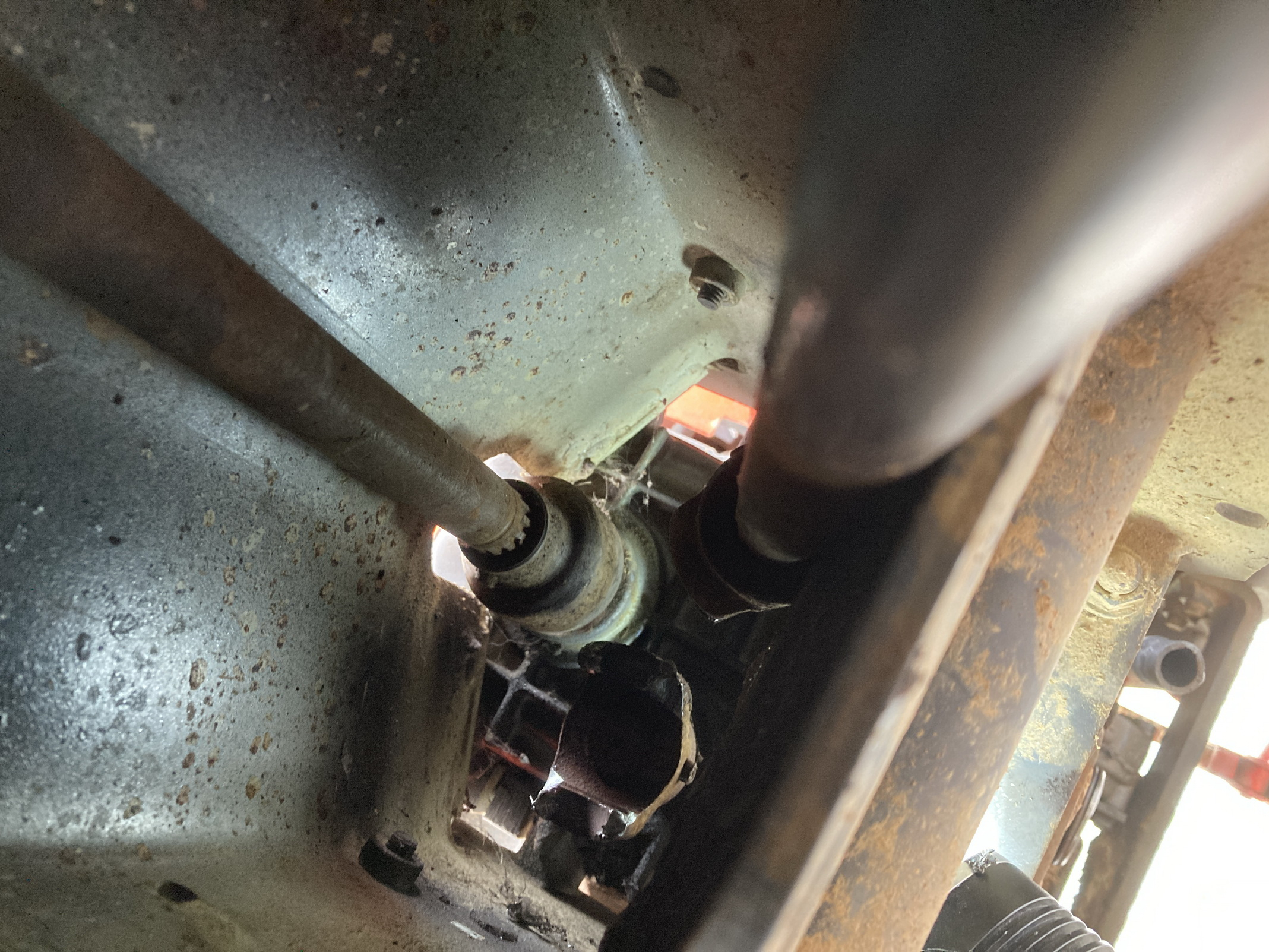

Thanks for you help. I did purchase the PDF shop service manual which provided many new pictures which have clarified many things. I posted some of these screen shots. What I have learned is the drive section I need to repair is in a fixed distance design. Previous I thought I could detach the second u-joint but it actually goes through the bell housing.
One consideration, which is a long shot would be if all u-joint pins were removed on both sides at the HST and also the pin holding the drive shaft at the second u-joint. It may be possible to break down the replacement u-joint and insert the drive shaft into all required yokes and push them past the pin positions as to provide enough room to reseat the replacement u-joint into it's seats and replace the bolts and holding collars. The real question on this possible solution is how much room can be gained if the three shaft to yoke connections are pushed beyond it's pinned locations?
Because the u-joint is broken I am able to slide the drive shaft almost completely out of the front u-joint at the bell housing.
A second possible solution is to machine and weld in some sort of telescoping coupling to allow clearance to complete the repair.

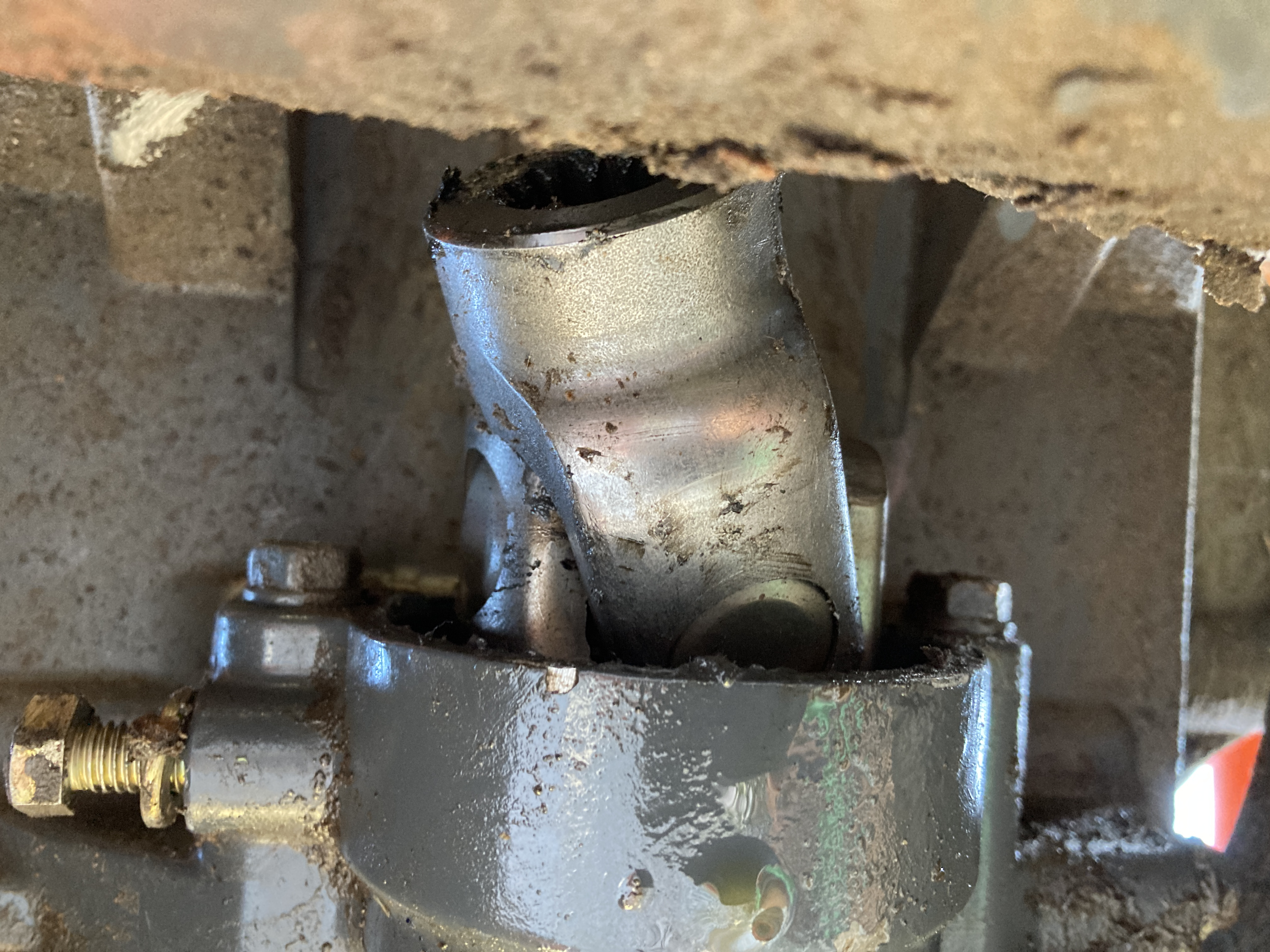

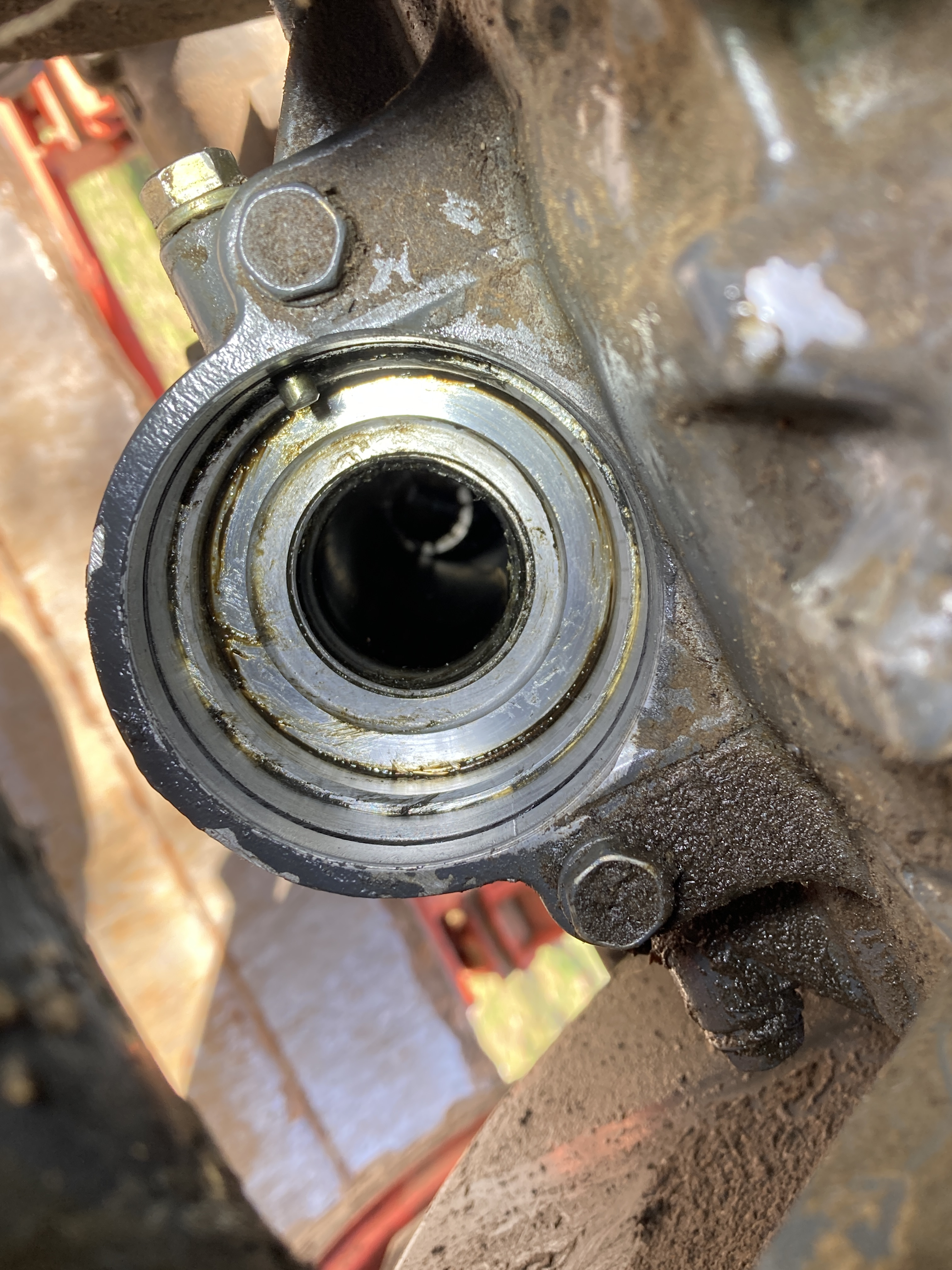

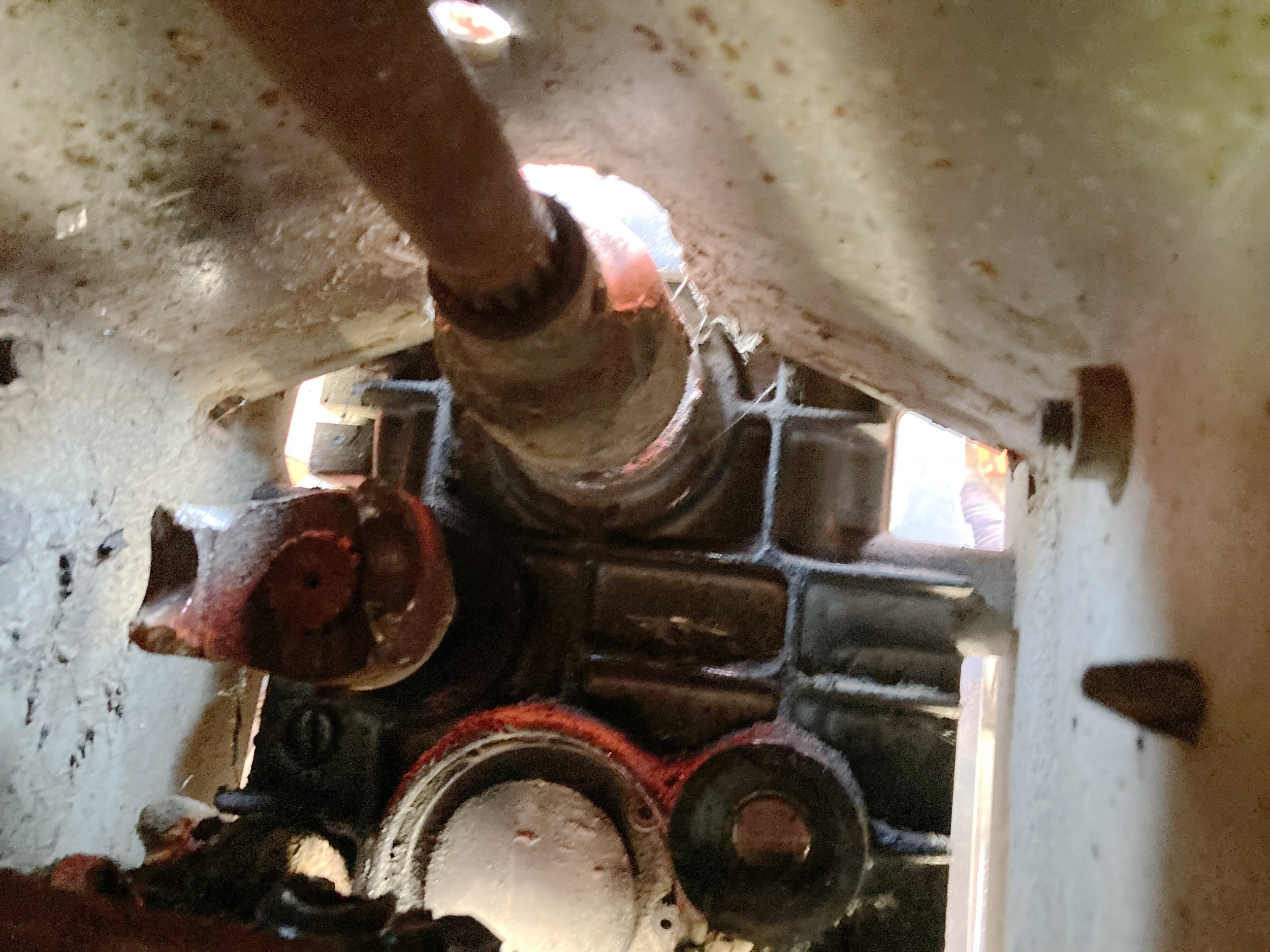

I have been told by Kubota the service to replacement this u-joint will cost at minimum $1100. They have never done this repair to a B26. I purchased the PDF service manual and learned what i could. I previously removed the hydraulic tank and was able to remove the parts after removing the stopper bolt. The remaining half of the u-joint is still on the shaft of the HST. This stopper bolt retains the bearing and u-joint which is pressed into the bearing and also the plastic cover. While handling the parts I noticed the spline shafts can penetrate beyond the pinned locations providing what may be enough room to do the repair without the damaging tear down. I will open the bottom plate to complete the repair. If necessary I will have the shaft made to be collapsible with lockability at full extension.

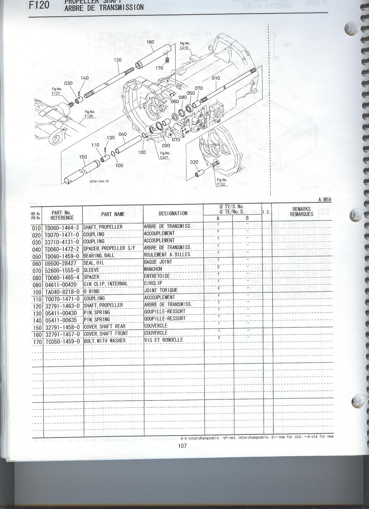

Sam, I've been studying the pictures you've posted and am kind of confused. Is there some sort of intermediate gear box between the HST and front axle? It almost looks as though the front driveshaft is offset laterally from the front axle pivot point.... but that doesn't make mechanical sense at all for a U-joint design.
So I'm confused. Can you help with a real basic tutorial on the way the B26 is set up? Is that center case or whatever it is even necessary for your application?
Here is a diagram of the way the M59 front axle is driven. The transmission output and the front axle input are on the same centerline and rigidly held. There are no U joints.
However, take a look at the couplers # 020 & 030. They are capable of handling twice the horsepower of the B26, and best of all are already machined. It might be easier to make external splines to match than to try to machine a coupler. Or maybe find an imperial dimension equivalent.

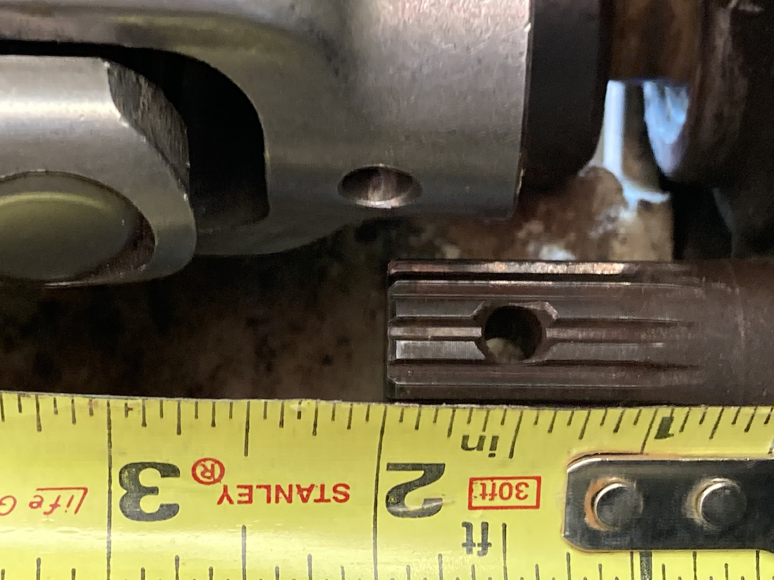

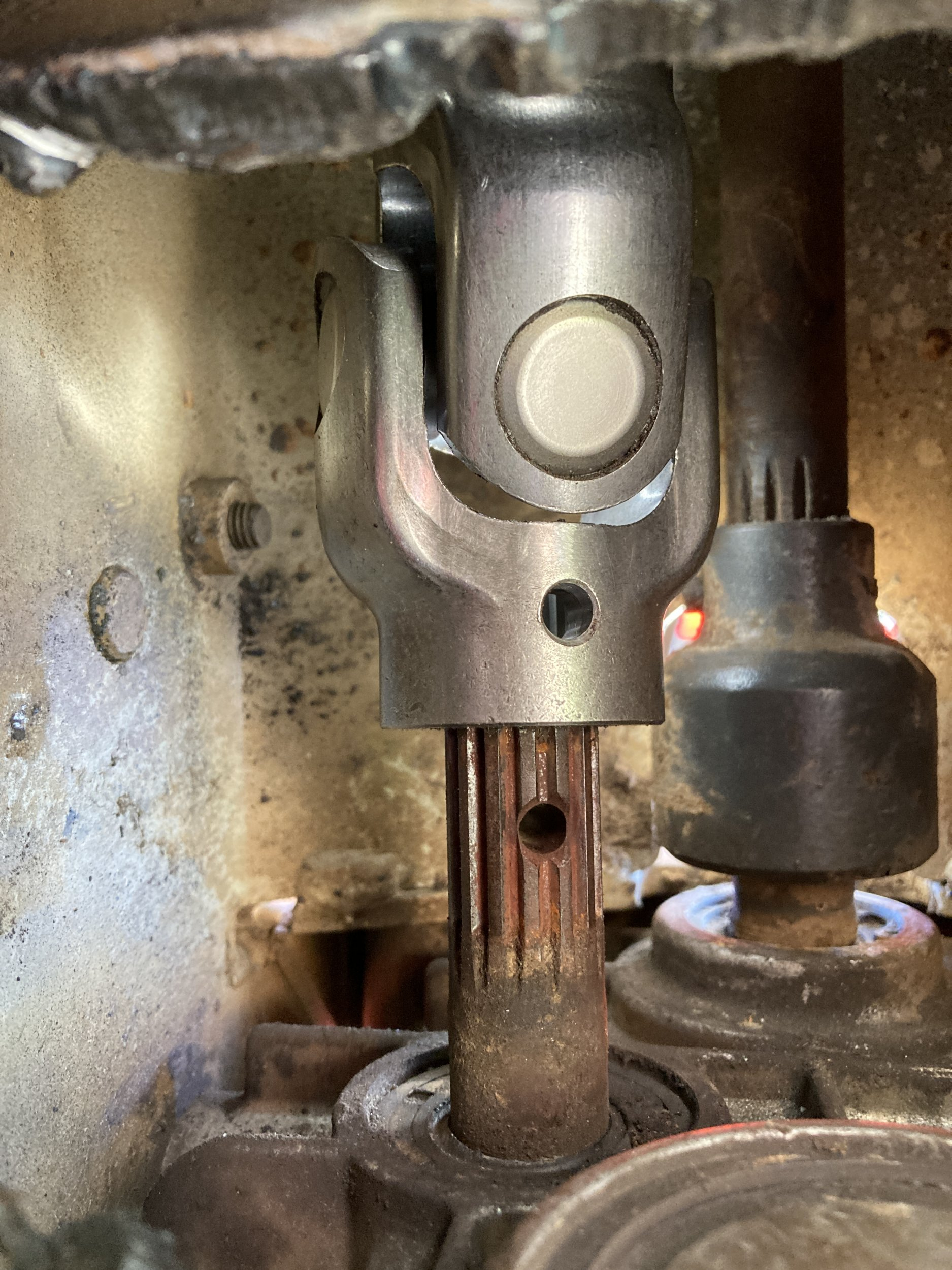

The B26 design uses two spline shafts and two fixed offset u-joints. The front axel pivots at the center of this drive shaft. The U-joint at the bell housing has a pressed baring which hold everything with the stopper bolt.

"Make sure Kubota isn't doing the same thing. Make sure (if you need new splined ends) that standard will fit before you get too involved."
Great point, I plane on trying to install the stock parts hopping the spline over shoot will allow assembly. If it is not possible I will simply try other simple adaptations.

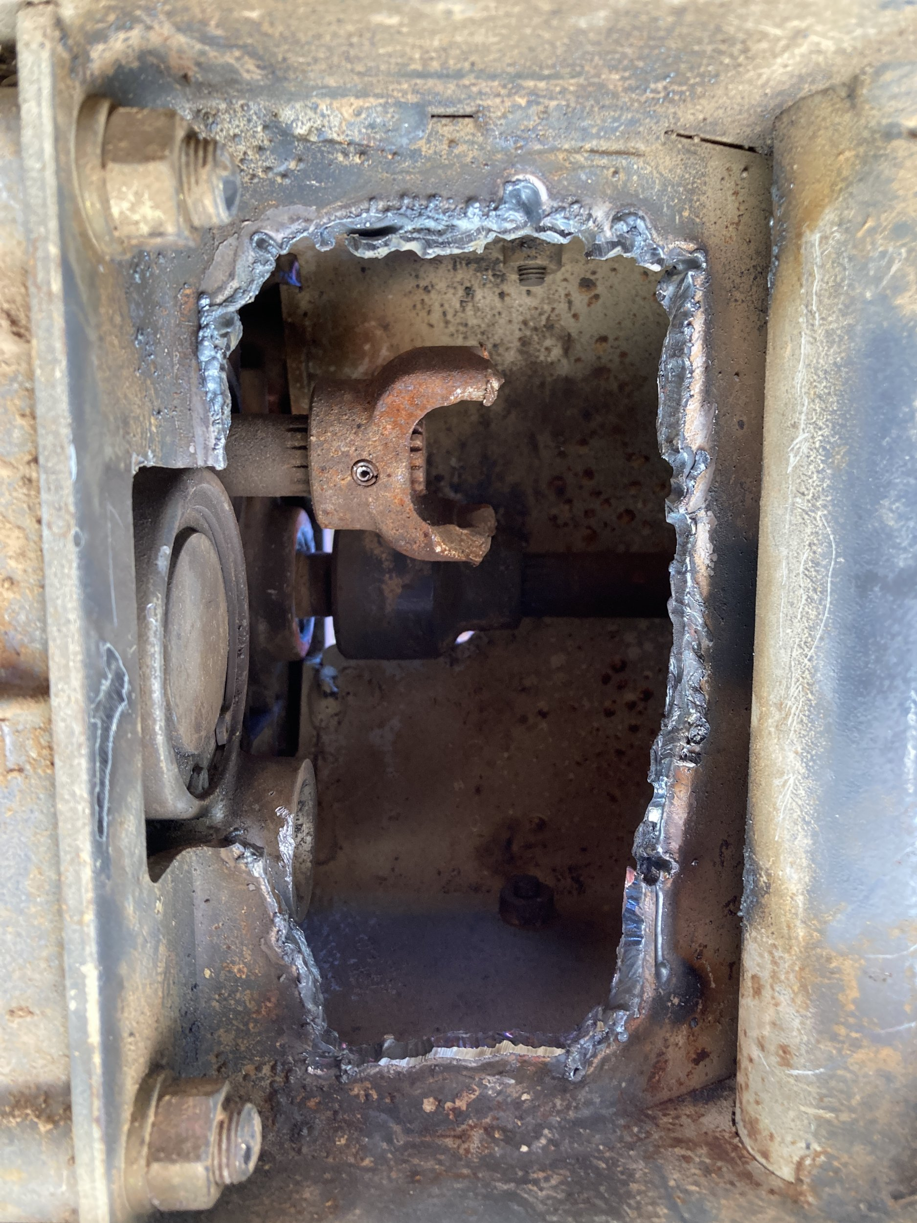

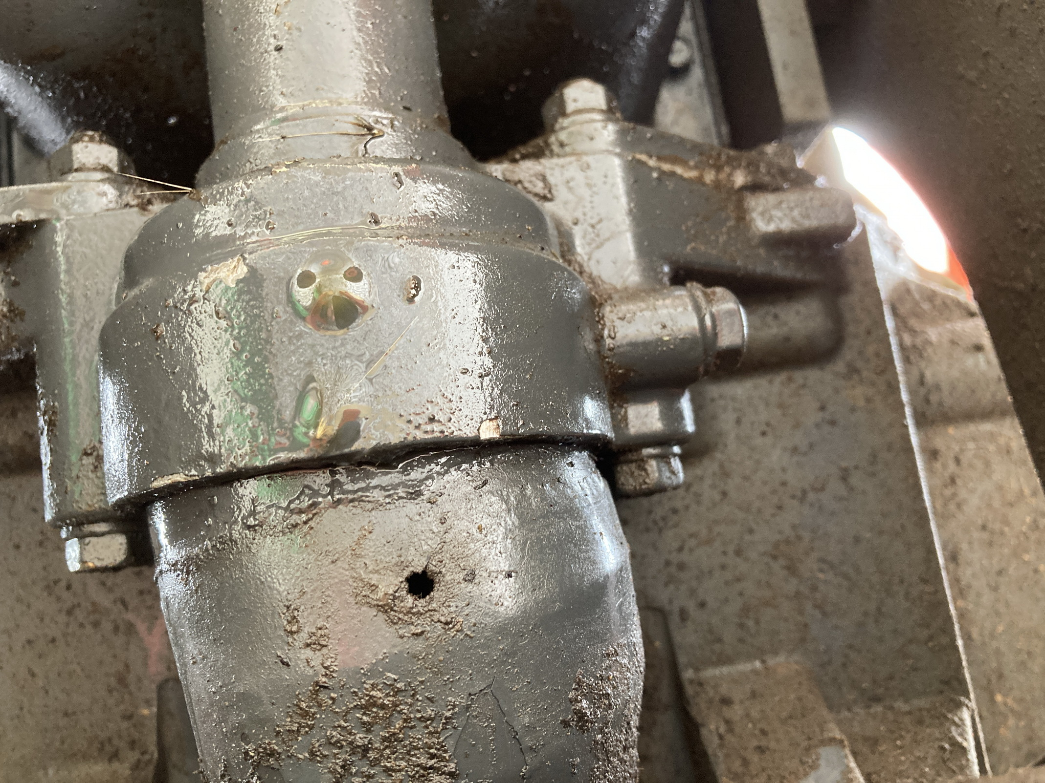

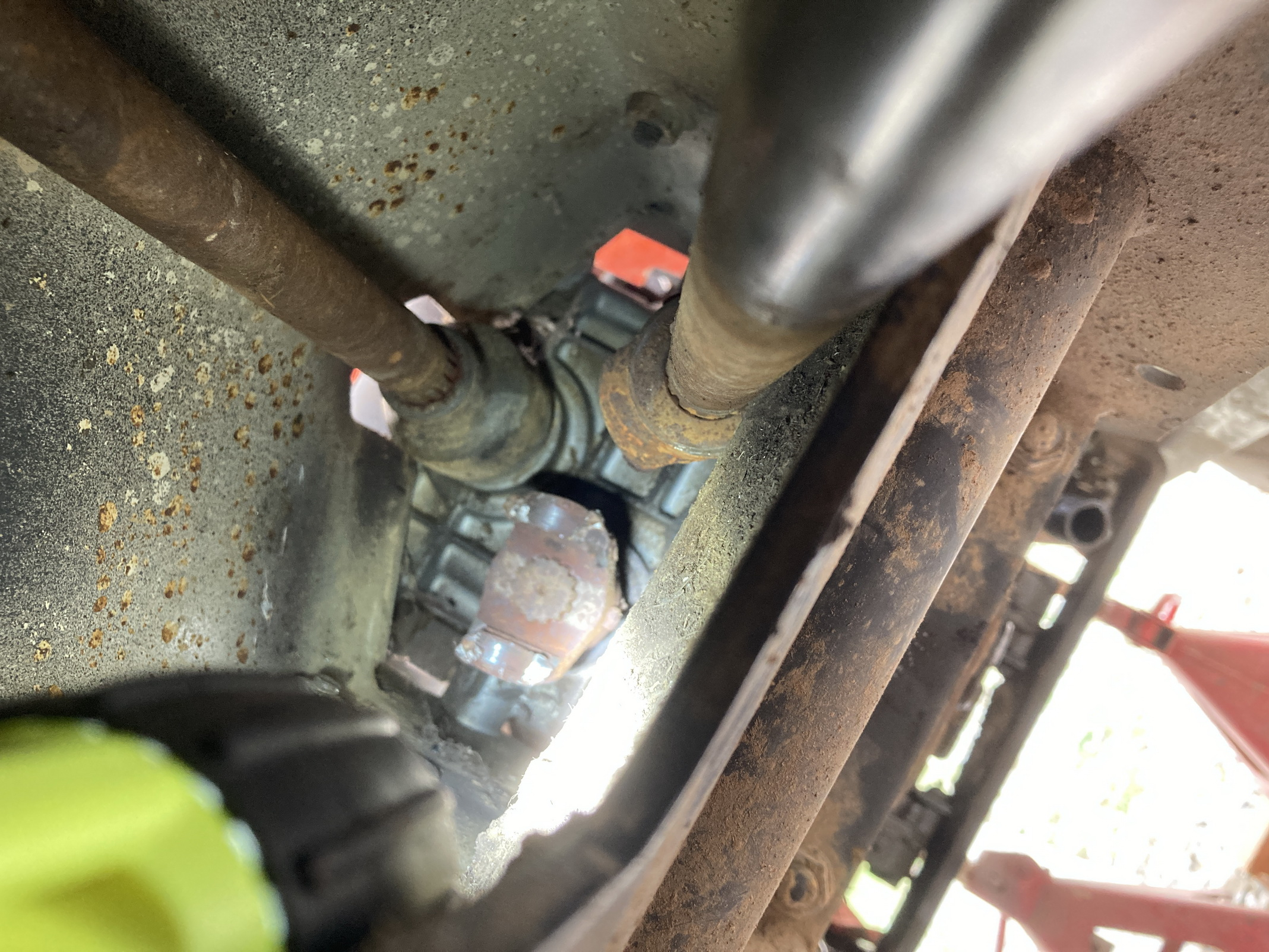

I purchased a Plasma Cutter (Tosense CUT50P 50A Non-Touch). Not pretty on my first try but did the job. Gained access and was able to learn I need basically an extra half inch to allow the u-joint installation. I am hoping to get the drive shaft shop to move the spline and stop to allow an additional half inch of penetration.
