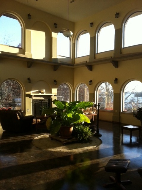

We live in a high thermal mass home, it has 100 cu yards of concrete exposed mass on the interior. A total of 400 cu yards including exterior ICF walls. The floors are on steel bar joists with no contact with earth. All the floors are stained concrete. It is a south facing home with a lot of triple pane glass with 32' overhangs. The overhangs were designed to allow max solar during the winter and minimum in the summer.
Each space has in floor radiant heat with a separate t-stat, meaning guest rooms are closed off and not heated. The wood frame interior walls separating these rooms are insulated to insure this is done.
As many have mentioned, the mass acts as a flywheel. So for example, Mid Spring and mid Fall nearly never call for heat or AC. Warm Spring days are offset by cool Spring nights. During the Spring/Fall time frame, there is still 1/2 solar exposure due to the overhangs. Late Spring/early Summer where where it is low 60's at night but high 70's or more, we open some windows during the night. The home stays cool all day after closing.
During the Summer, due to the flywheel effect, the AC often runs late at night. This is fine because it's the coolest time of the day. So you can imagine an AC unit cooling a home to 74 deg with an ambient air of 70-72 deg outside is nearly no load.
During the winter, the heat will not come on if the sun is shinning. But the fact is, Indiana can have some cold gloomy days and requires heat. We leave the heat set constant all Winter, there is almost no way to fight the flywheel by Setback thinking. To give an example of the power of mass during the winter, we had the power go out during an ice storm a few years back. The power was out for 5 days and the temps were in the 'teens. Over that time frame all my neighbors with out wood heat ended up moving out due to frozen water pipes. Our house temp dropped by only 5 deg. It even rose on a sunny day!
At this time we heat with an electric boiler but I would like to install a wood boiler. It would take years for payback though. We do work from the home but other than the window opening/closing for a month in optimum times of Spring/Fall, we do nothing.

Paddy
This statement is a popular "misconception" regarding conventional A/C operation.
During the Summer, due to the flywheel effect, the AC often runs late at night. This is fine because it's the coolest time of the day. So you can imagine an AC unit cooling a home to 74 deg with an ambient air of 70-72 deg outside is nearly no load. "
The "no load" condition does NOT APPLY to the operation of a compressor type A/C unit.
Whenever the compressor is running, the full motor amperage for operation is drawn. The "work" being done is compressing the refrigerant, not moving heat.
The "savings" comes from the possibility that the A/C will run for less time.
So when the A/C turns on in the middle of the night, It costs the same per operational hour as it does when the outdoor air temperature is 104.
Just a point of clarity

Bingo.
It cost the same per hour (or per minute) to run no matter the temp.
The savings comes in from the fact that the cooler it is outside, the more efficient the unit can be. Which is twofold cause the cooler it is, the less loss there is through the walls.

CalG,
So you agree, low delta T, equals lower costs? That was my point. With temp swings on a hot July day from 70 to 80+ from night to day, it costs less at 70 deg because the system is more efficient. So it might cost the same per hr of run time, but it runs much less at 70 vs. 88 deg ambient.
   / Building with 'thermal mass'. Are the claims bogus? #29
Yes, I agree Lower costs will be realized every hour the AC doesn't run.
But your comment:
"So you can imagine an AC unit cooling a home to 74 deg with an ambient air of 70-72 deg outside is nearly no load. "
This is just not true. the "no load" situation does not transfer to any realized efficiency. If the heat load within the house (thermal mass) were sufficient, that AC unit could run all night regardless of the outside air temp. That is, the out door air temperature does not make it easier for the AC to reduce the heat load of the interior space, nor does it assist in the heat transfer efficiency (read electricity expense) out of the interior space. If there were gains to be made due to Delta T, that would imply that your thermal INSULATION is inadequate. (in which case you would do as well to open a window or two ;-)
When the A/C is running, It consumes the same energy regardless of Delta T. It is either ON, or it is OFF
You would realize the same savings by changing your thermostat setting! There is no "efficiency" there, but there is savings.
But you have to ask yourself, Where did the extra heat inside your house come from that kicks ON the AC late at night? "solar gain and thermal mass is a good bet.
