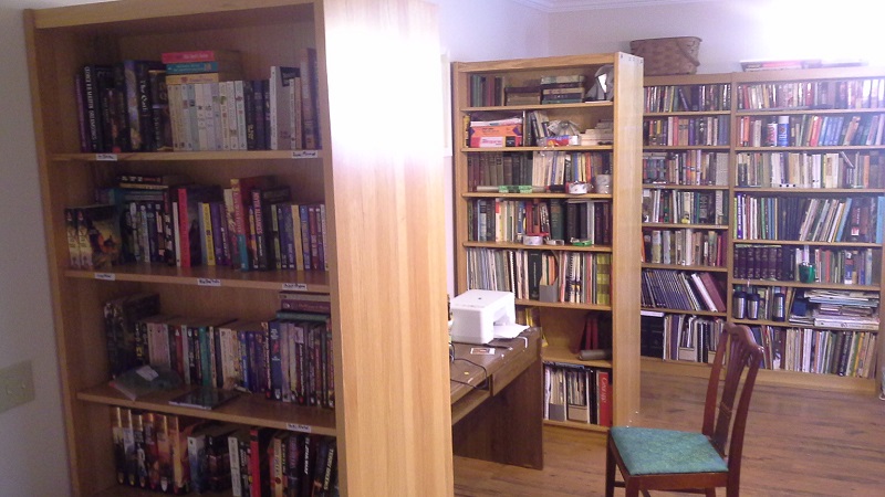

Nice house. Also people need to realize that thermal mass does not have to be created by hundreds of cubic yards of concrete, just hundreds of cubic yards of something dense that holds the temperature. Dirt will do.
SWMBO's solution is books.
We also try to keep bookcases against external walls.
