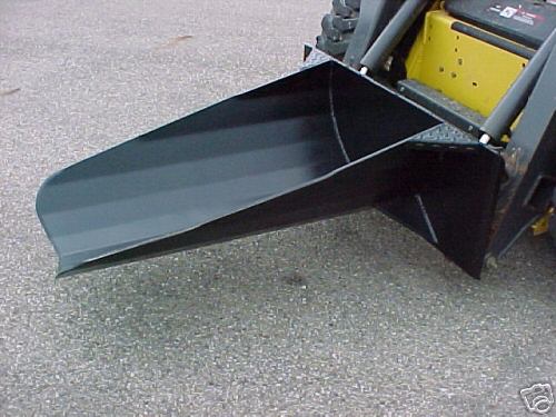

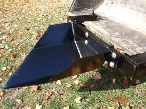

Here is the tree spade that Mr. Jimi built. This one is built out of 3/8 steel, and is 48 in long. I have used it and it works quite well. On building one of these, just cut down the size to fit your needs. The steel mill can cut it out for you, or use torch or plasma.

   / Built a Shrub Bucket #36
Thanks for the additional pics and Inofrmation JJ I appreciate it.
Others opinions/experience welcome.

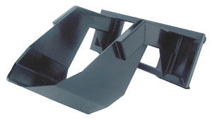

On the first tree digger, the peple says it cuts roots better, the roots gets traped in the center rather than being pushed out of the way.

   / Built a Shrub Bucket #38
Thanks for the additional pics/info. J.J. I appreciate it !
