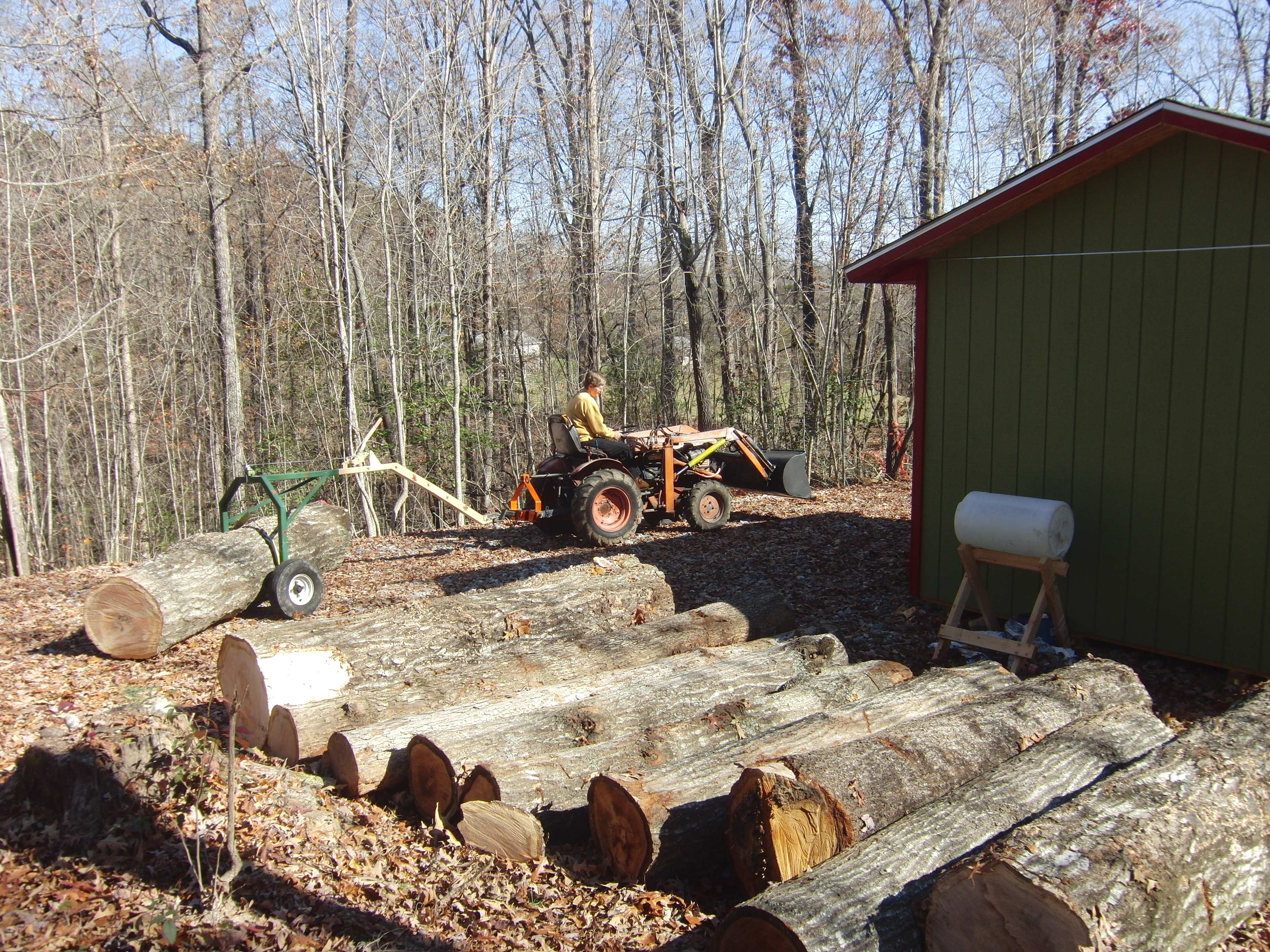

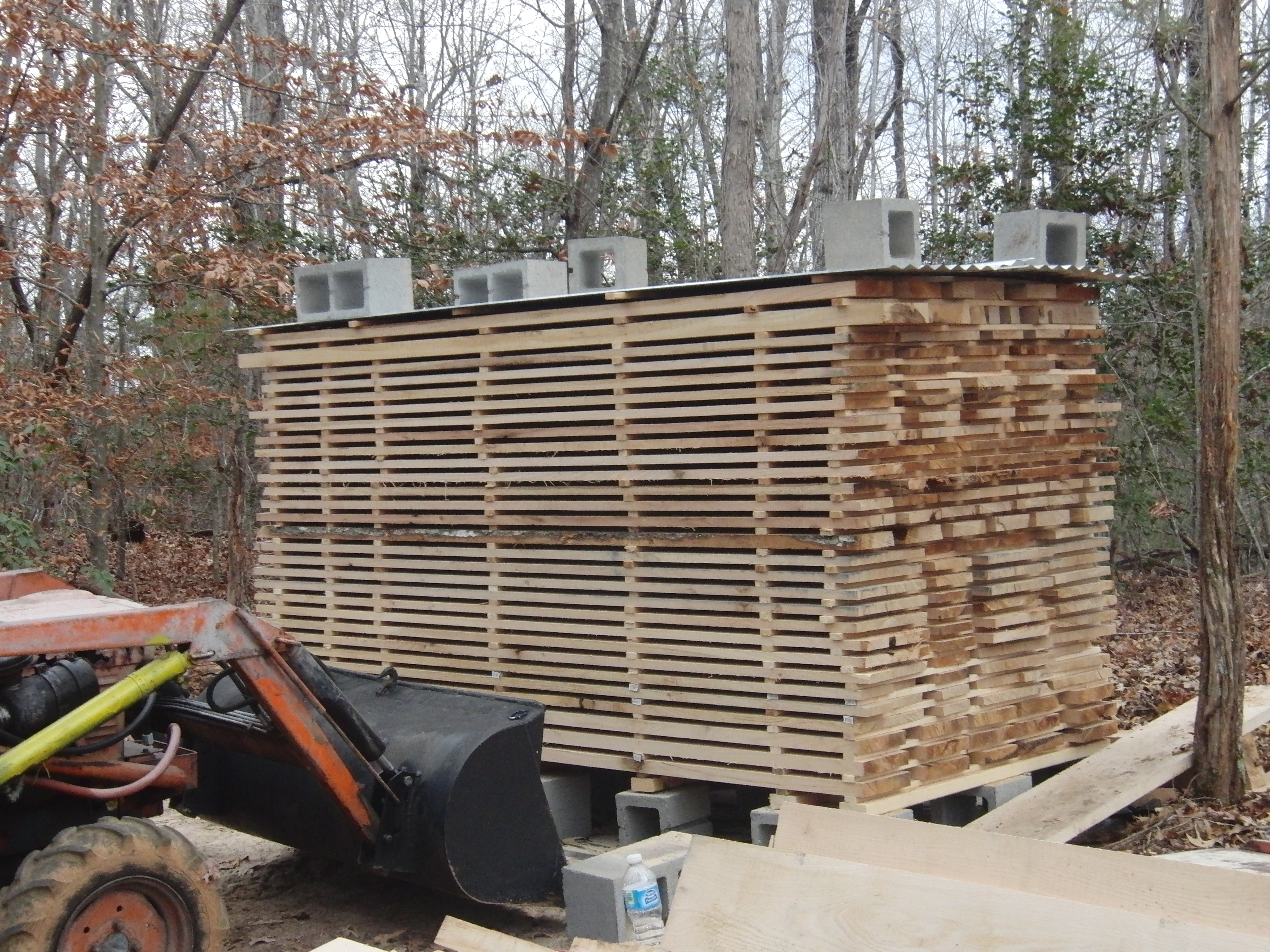

That downed tree was just an example. It and another were cut into lengths. I had a portable BSM cut it up.
