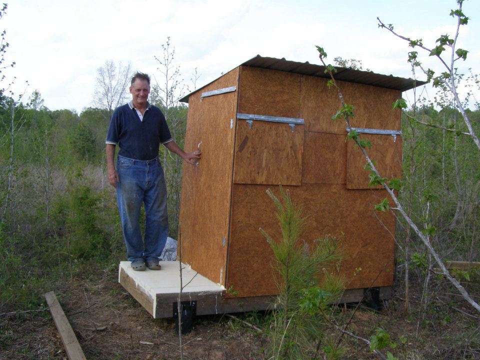

Haven't fired out of it yet. I think most of the muzzle blast will be outside of the window frame since the gun will be rested on the frame itself. Earplugs might be in order. I'll let you's know after I fire a few...:)

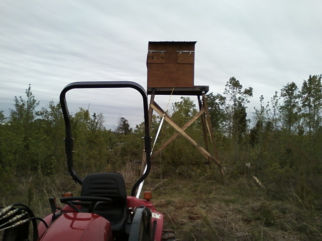

Nice blind!!! I see you are from western NY, not too far from me in Oneonta. From the pics it looks like there are no ceiling/roof rafters holding up the metal roofing?? Looks like it is attached to the top plate on the walls only. I am sure you get quite a bit of snow where you are located. You might want to slip in a few rafters to hold up the metal roofing while it is under a snow load. Unless that metal roofing is super thick. You and youre family will have many years of memories hunting out of that blind.
   / Built me a new Deer Blind
#20
I have an 2x1" steel I beam running down the middle of the entire roof. No pics at this time but will post some when I take em.........Good observation though........
