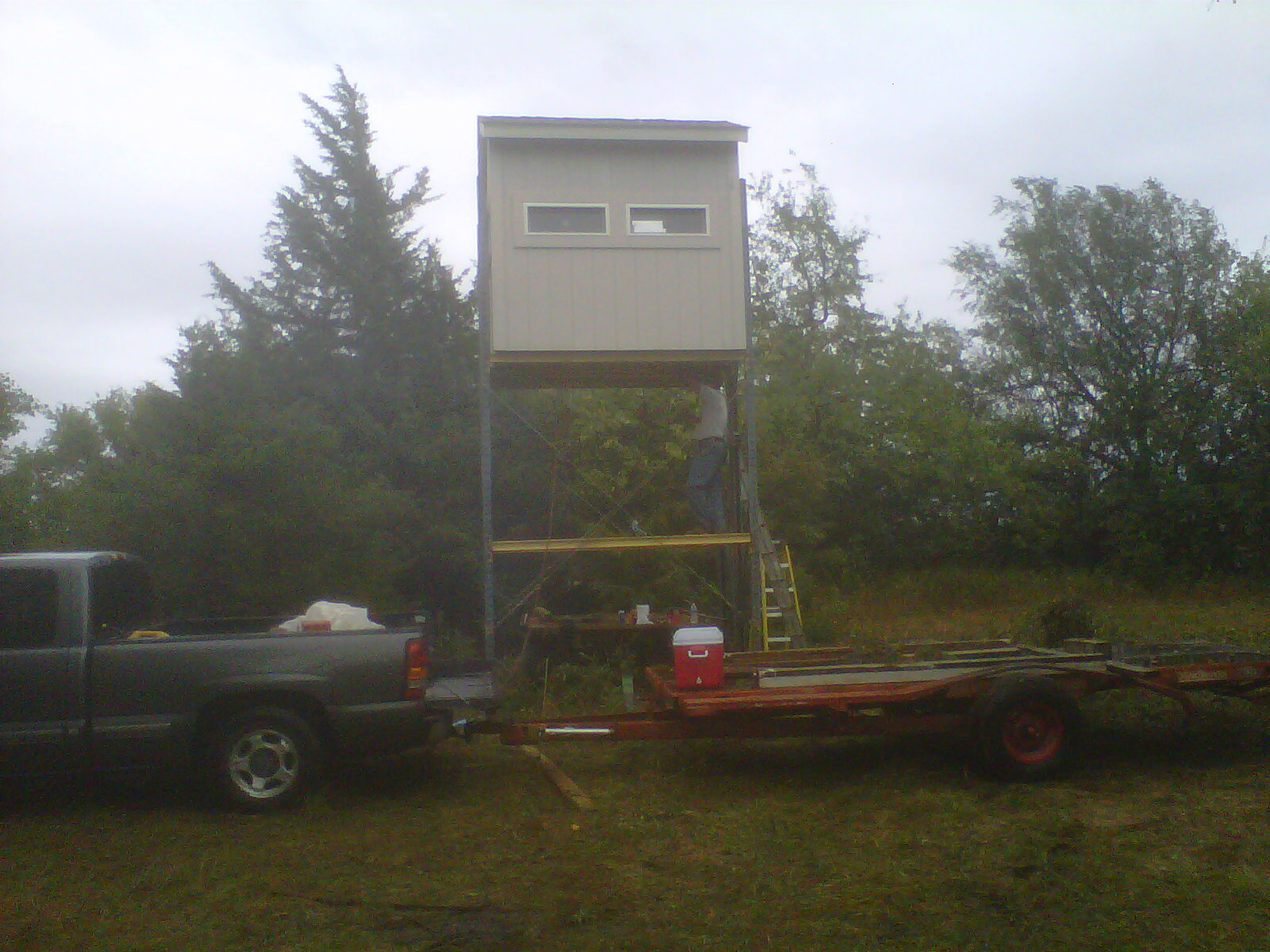

Nice set up. I did something similar. For those that have access to one - find a place that deals in used warehouse equipment. I got two 14" pallet racks for $100. The rest is easy after that.

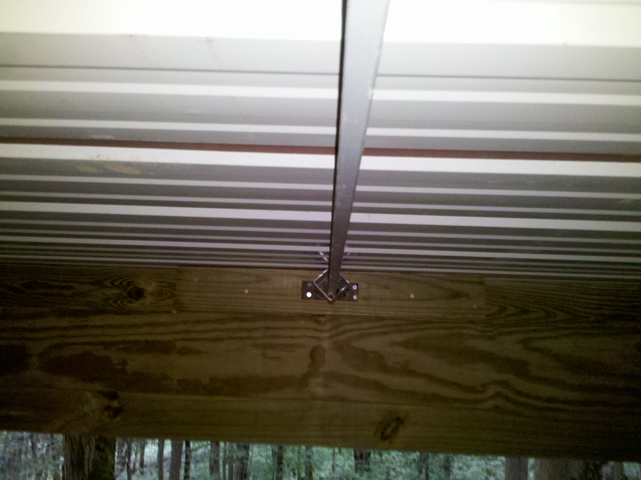

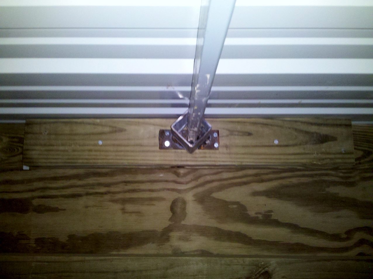

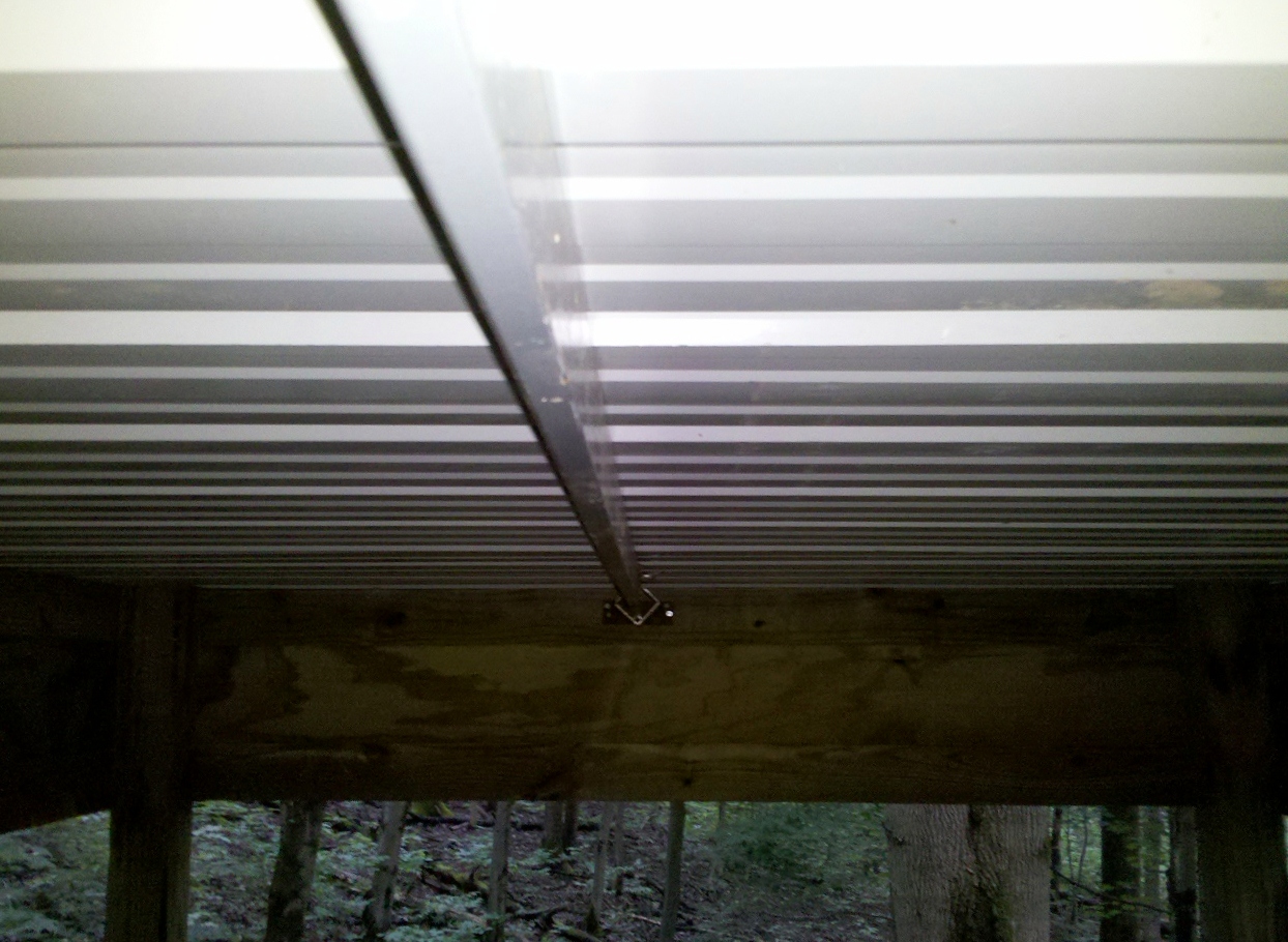

Nice blind!!! I see you are from western NY, not too far from me in Oneonta. From the pics it looks like there are no ceiling/roof rafters holding up the metal roofing?? Looks like it is attached to the top plate on the walls only. I am sure you get quite a bit of snow where you are located. You might want to slip in a few rafters to hold up the metal roofing while it is under a snow load. Unless that metal roofing is super thick. You and youre family will have many years of memories hunting out of that blind.
Here is the metal 2.5" steel I beam I ran down the length of the roof in the middle of the 8' Span. I had some 2.25 galvinized box tubing and the the beam fit in perfectly tight diaagonally. I welded plates on the end and screwed the brackets in to the top plate..........Should be good to go. I'll be pouring cement around the posts next time up there..................I

Nice blinds guys! i built a similar one last year 5x8 interior dimensions, 6' tall interior with a framed roof(rubber roofing glued on the top to reduce noise). It's got insulated metal walls and i still need to put the carpet in the interior. i've got to be careful with movement so i cut pieces of 3d blind material that i can push pin into the window frames to customize the opening size. All in all a great winter project ... we dragged it to the site with the quad, that's the way to go. skids are PT 4x4 and are 12' long, worked great. i just laid a couple large rocks onto each end of the skids and it's real solid. Thanks for sharing all the pics!
