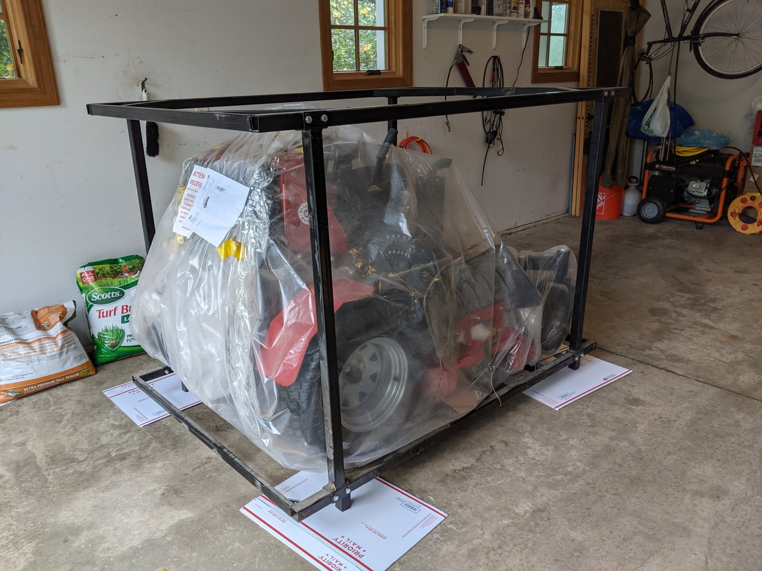

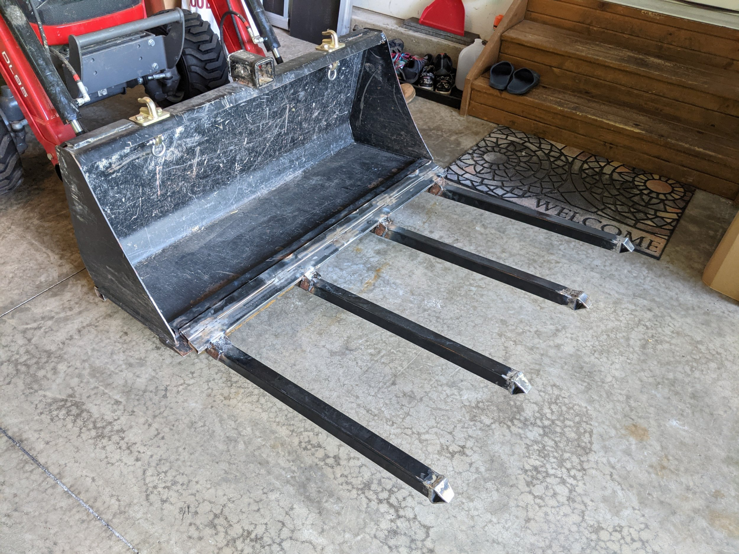

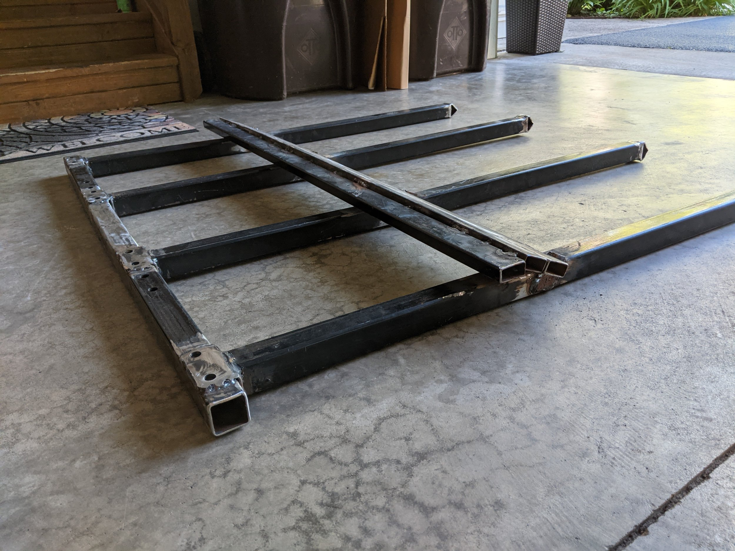

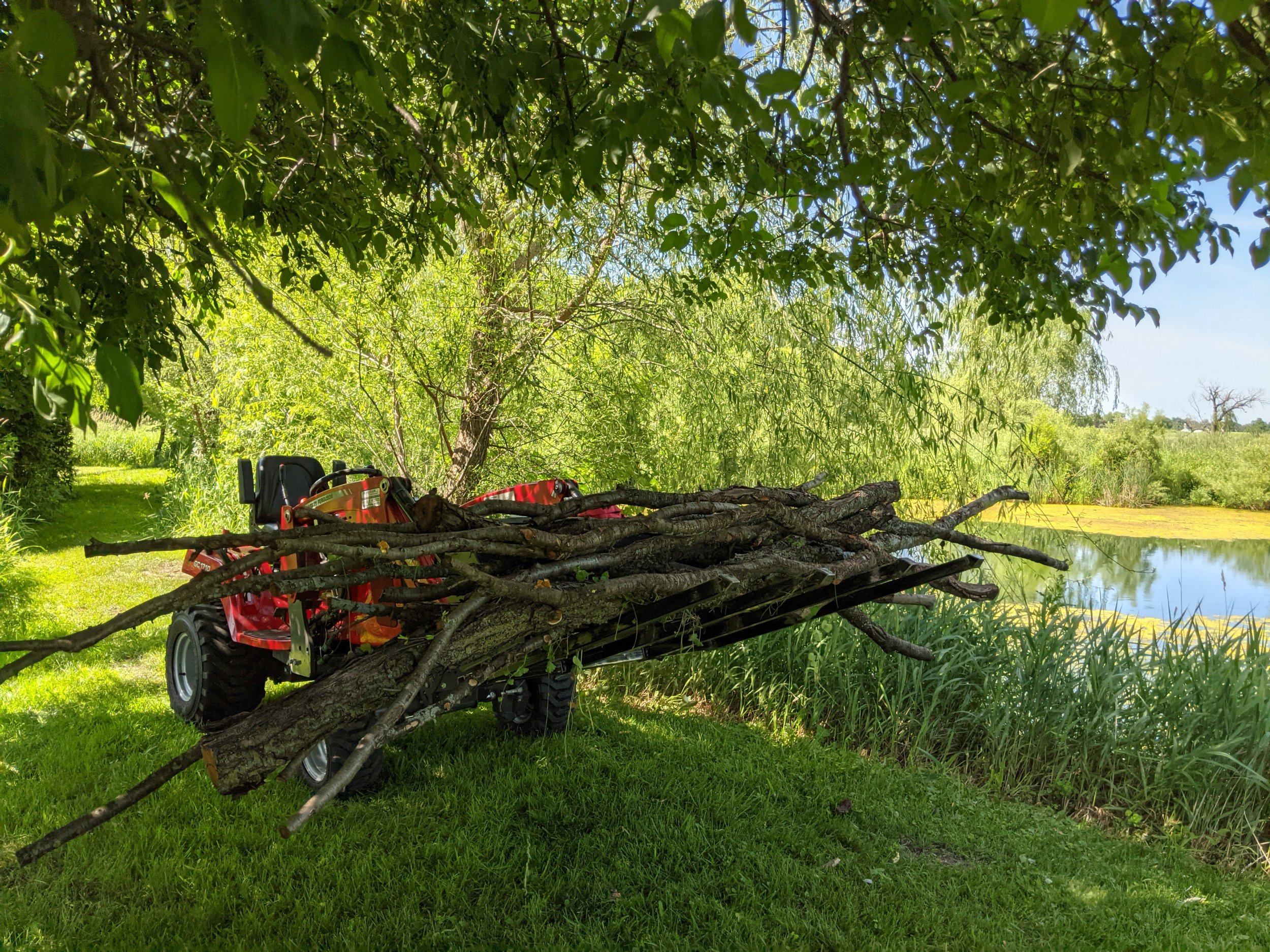

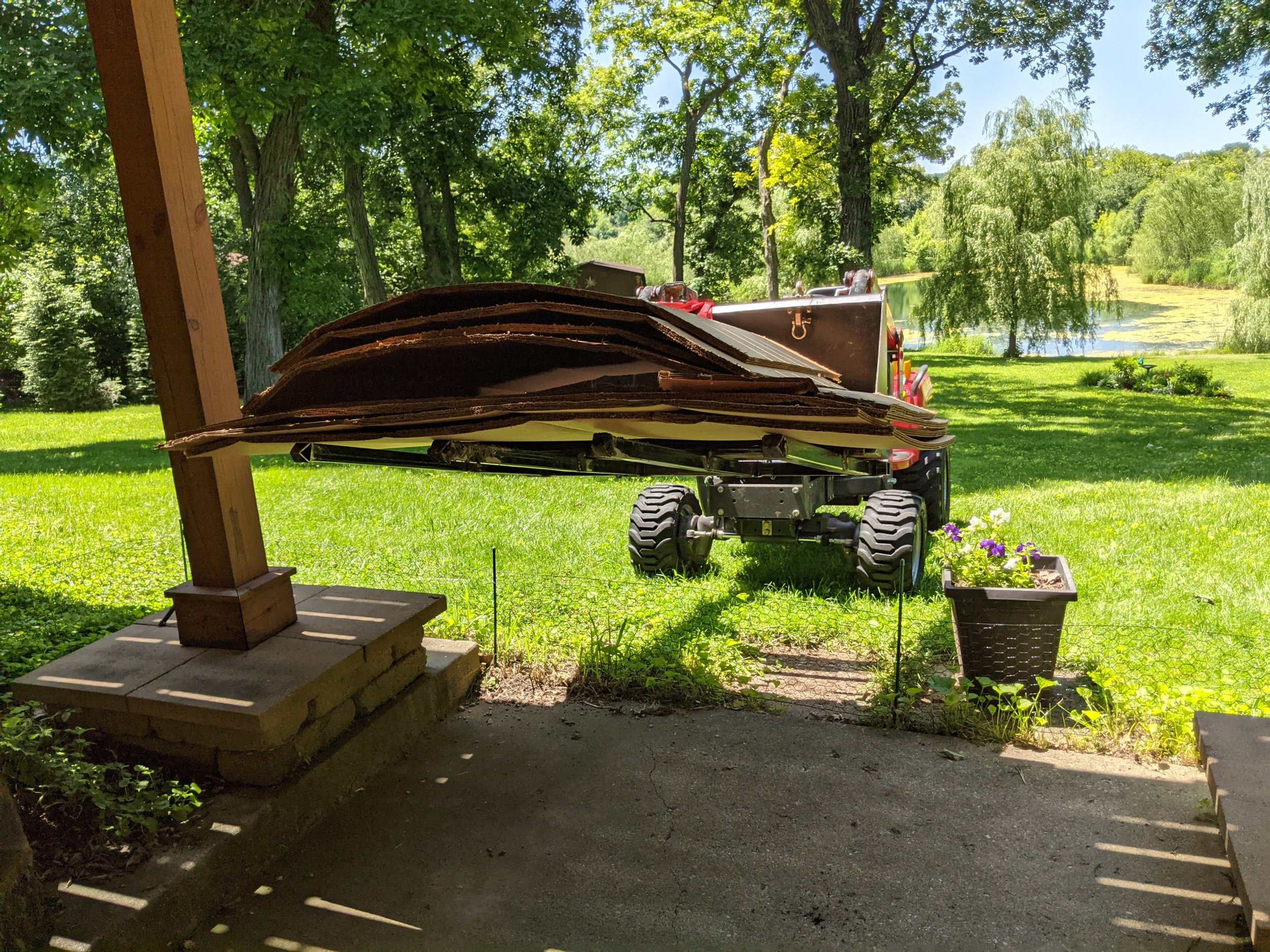

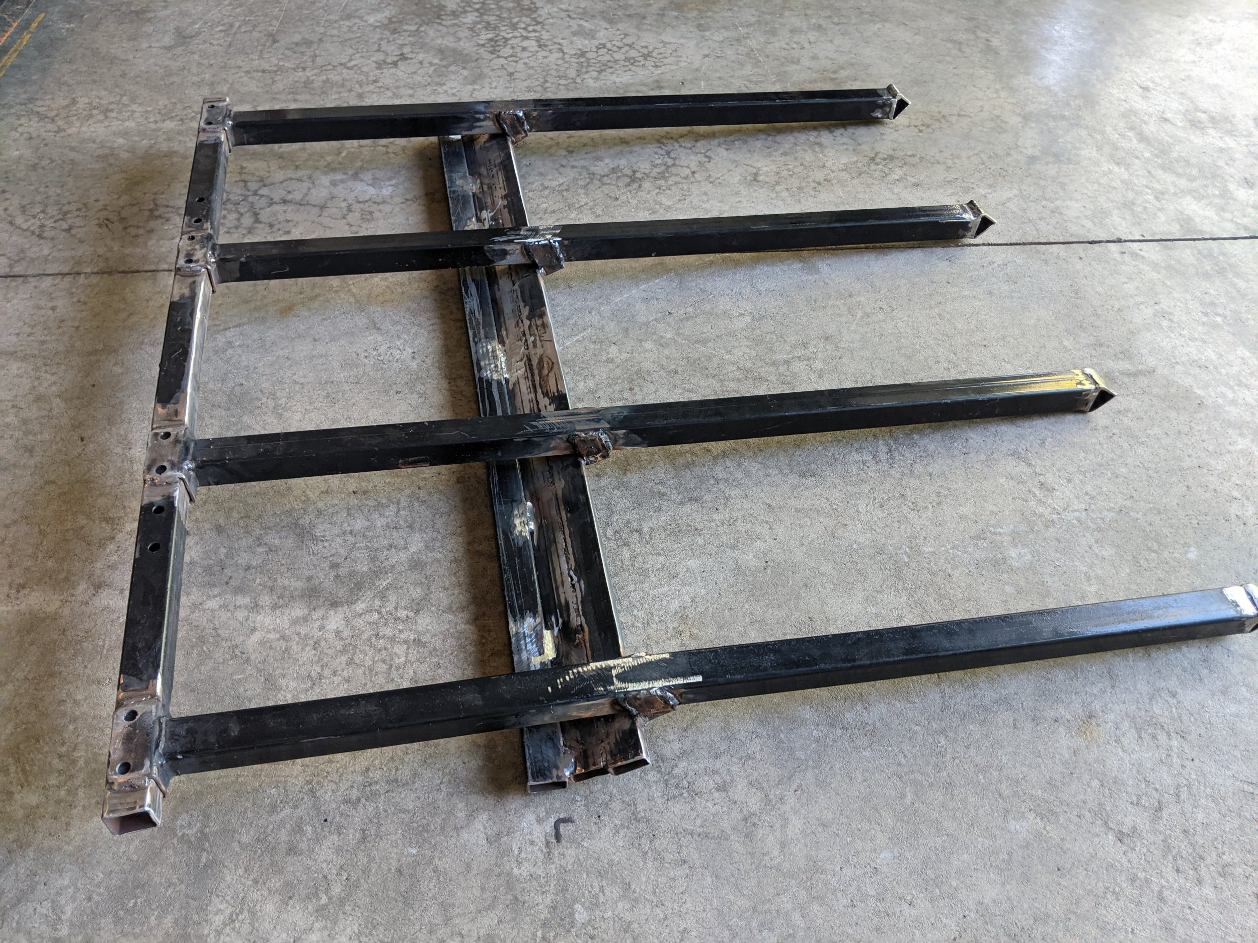

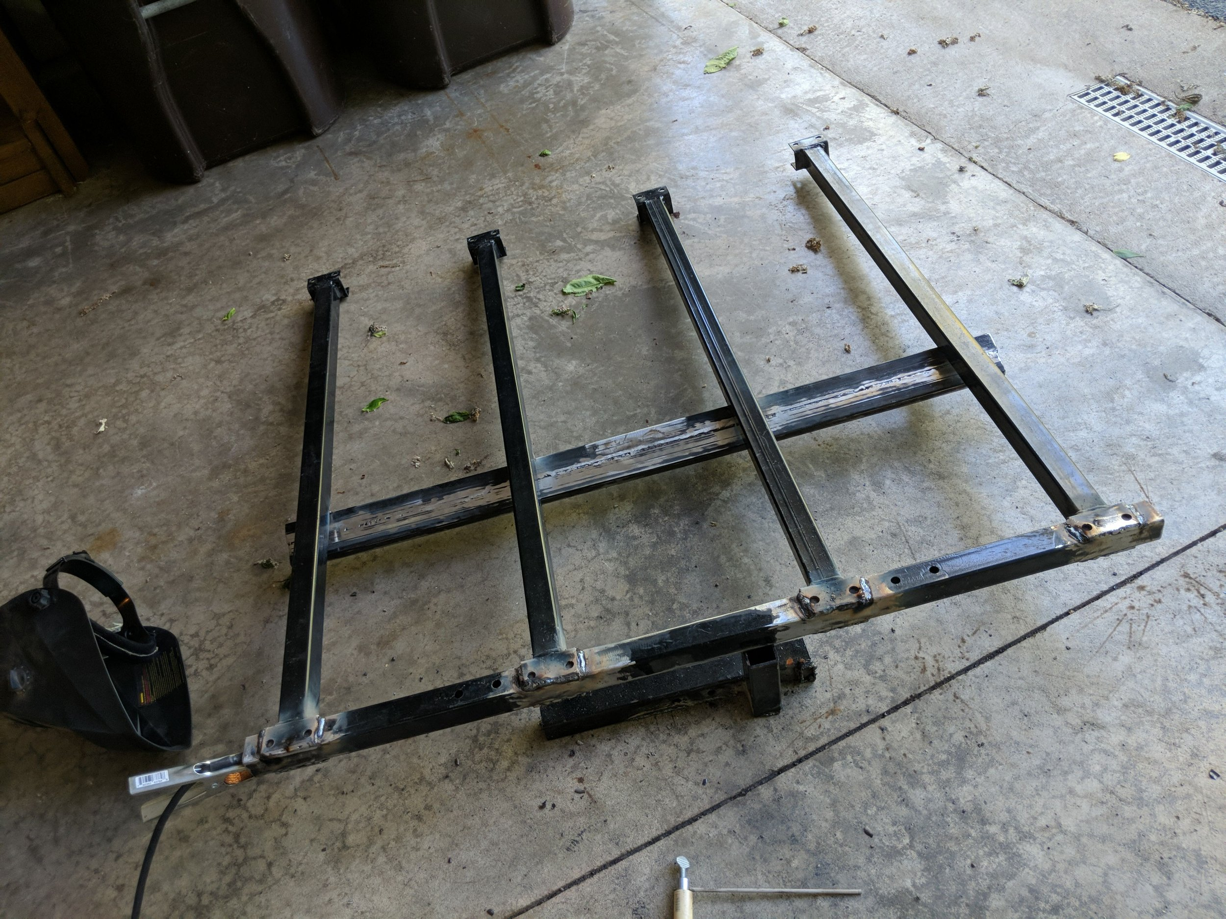

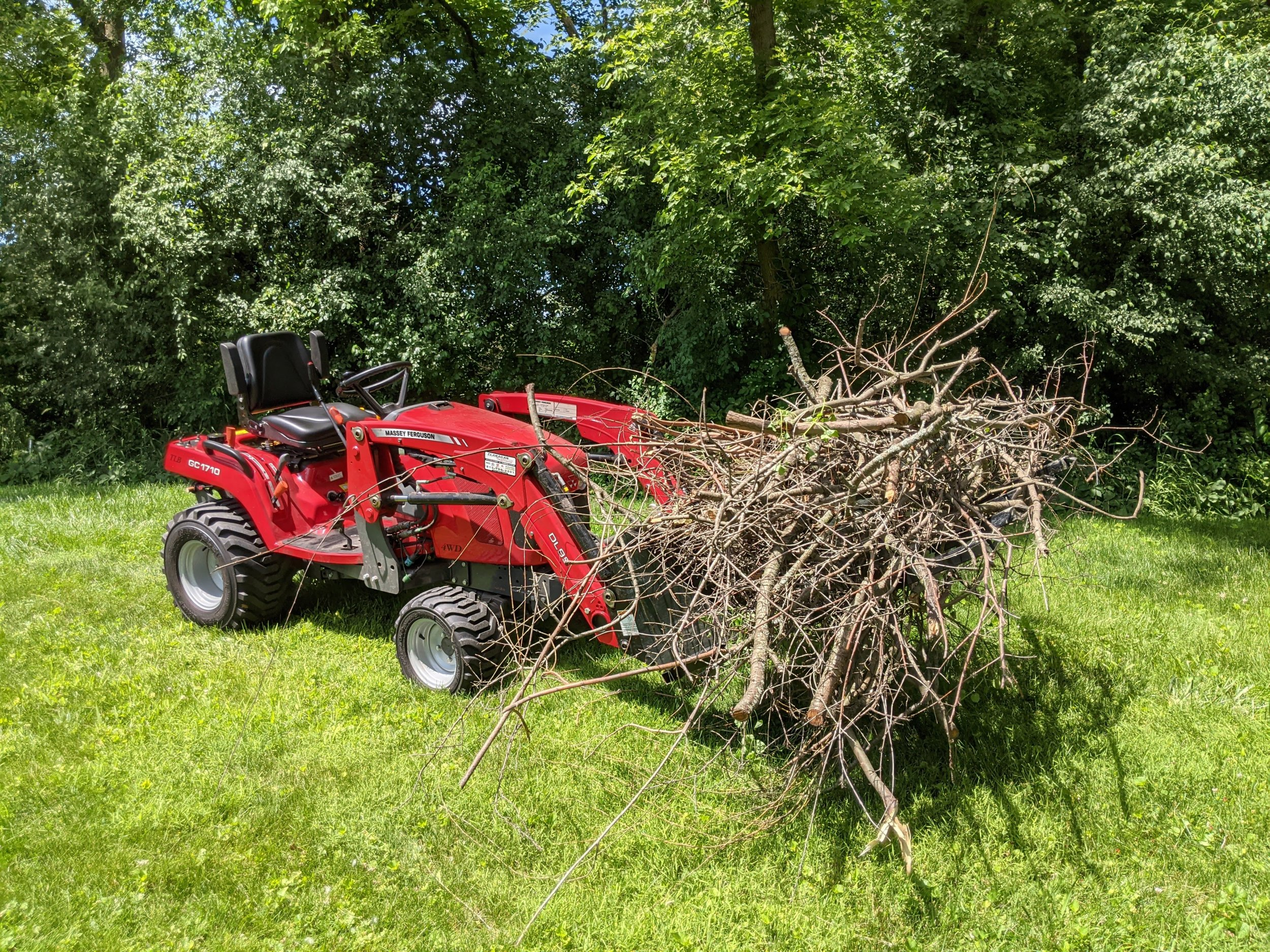

Hey guys, long time no chat! Finally had a chance to use some of that steel which my Bradley mower shipped in, so I built these debris/brush forks with it. Yesterday's test run went great!
PXL_20211012_200015855.jpg IMG_20220603_151201_01.jpg PXL_20220618_225124067.jpg PXL_20220618_225200796.jpg
PXL_20220618_221050406.jpg PXL_20220619_181731298.jpg PXL_20220619_193345678.jpg PXL_20220619_203220631.MP.jpg

Nice! Especially for just some labor. Can't get better than that! Good job!

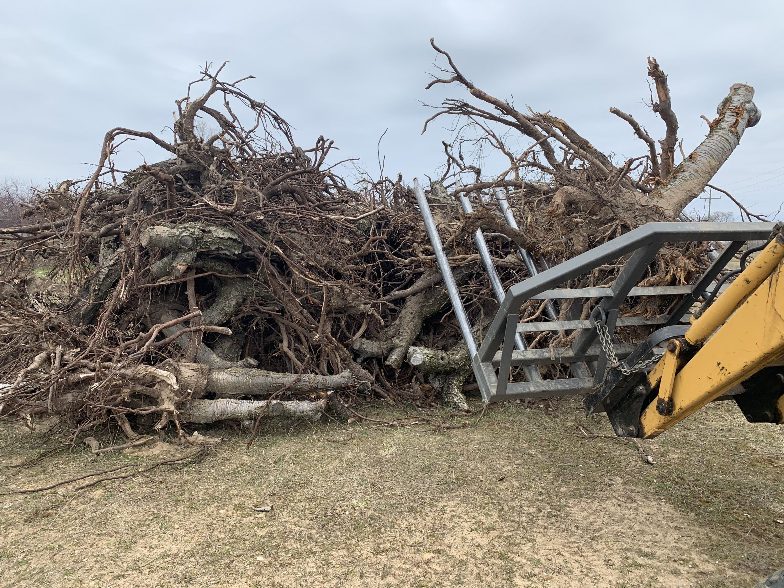

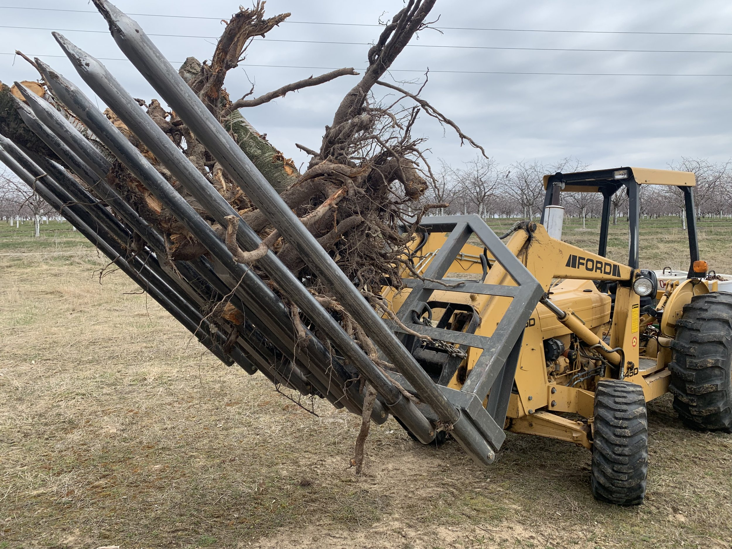

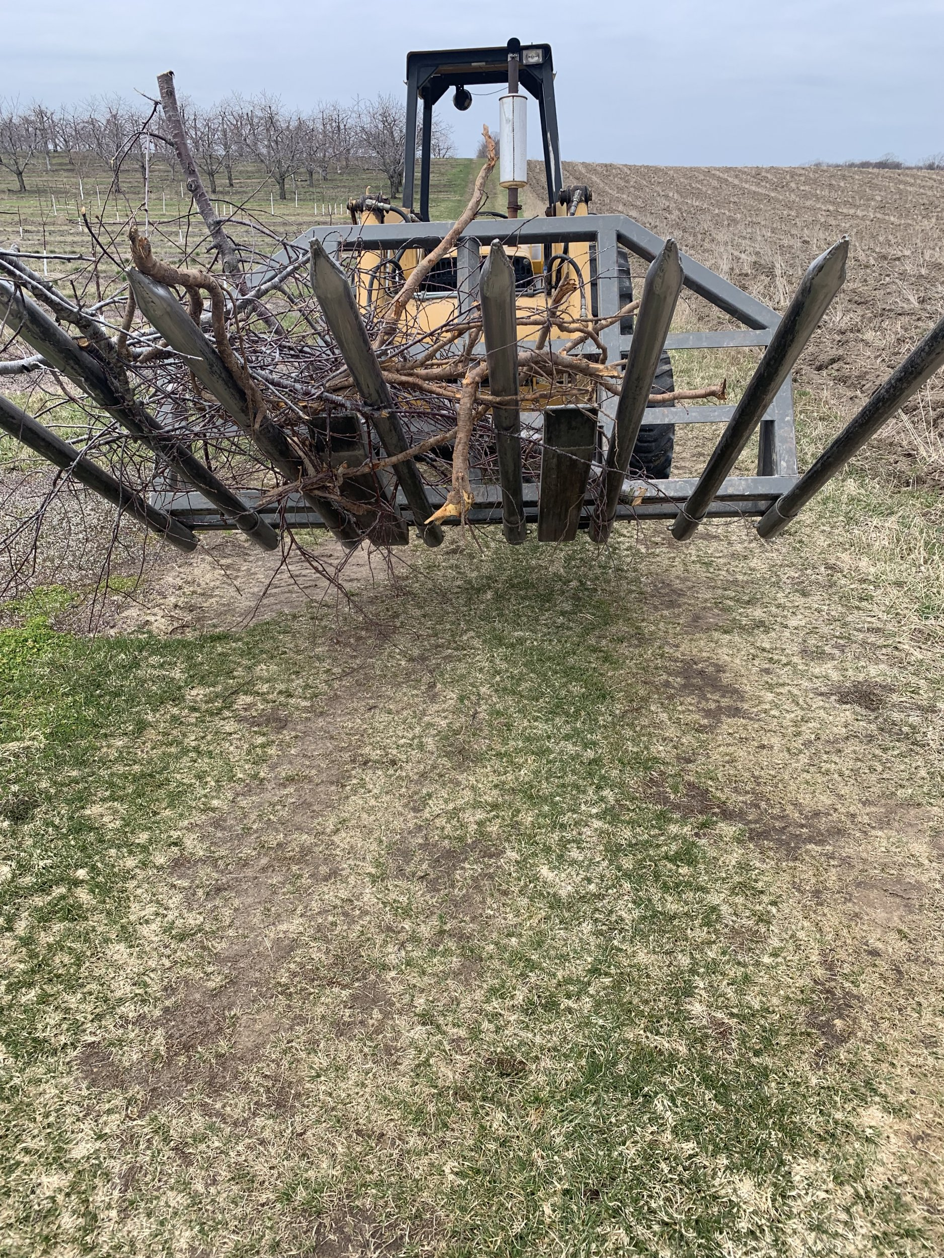

Great job on a really handy attachment. Around here all the orchard farmers including myself have basically a bigger version of what you made referred to as a buck rake. It’s main function is Pushing prunings from trees that have been piled down center of rows out to a big burn pile. Angle the rake down with just the tips riding on the ground so they slip under the brush and down the row you go, can move a mountain of brush in a hurry. My rake just quick slips over my front forks a chain holds it on and very importantly supports the load from bending the forks. I also use them to haul stumps /roots. For me they’re indispensable for moving a large volume of debris.

Clever way to reuse a shipping crate - that is a very useful attachment you built (y)
I like the way the frame for your forks is built with the reinforcement shown in the third picture. Are you using solid hay spears for the forks?
The tines are 3”OD 1/4”wall pipe with 4 v’s cut out of the end and remaining 4 v’s bent and seams welded to form round point. If one gets bent too much and can’t be straightened there easily replaced as only one bolt holds them in support tube. There made to be weakest link so you can’t tweak the frame. I’ve had that rake bout 7 years and still original tines.

Video was nice. If there's plastic in your tractor grill, you might consider adding some protection either to the grill or to the fork attachment. There's another member here who made very similar forks, but also welded some vertical bars on his attachment to protect his tractor. Tractor radiators seem to be pretty expensive.

Yeh, you're probably right, some sort of headache rack like Wrangler did.
