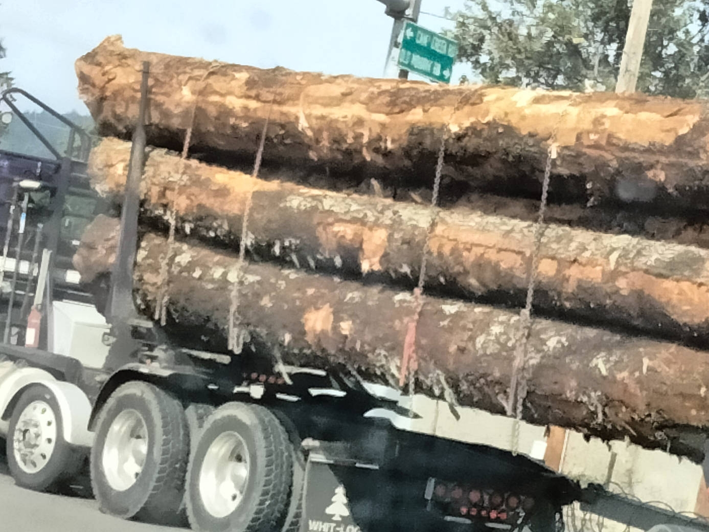

Around here, the binders go around the logs, but do not attach to the trailer.
The logs don't just fall off. However, about 50 years ago I saw the results of a log truck slamming into a solid embankment. It wasn't pretty. The headache rack doesn't help much when the truck stops and 50 tons of logs are still moving.

Also, when they have two cables holding 50k lbs of logs, those cables are usually loose after a mile or so. There is that one loose log that wiggles it's way out and into your lane.
I never seen this... For us driver don't tie up their logs until they get to the pavement, many miles has been driven in the bush road before they get there, I also never seen them loosing a log in a bush road. Many steel cable is being used once they tie it down, still it wouldn't hold in the event of a crash.

Attaching one's chains to the stinger or reach would be really bad as everything moves when going around corners.
I'm not quite sure how the bunks deal with going over hills or valleys. Perhaps the only thing that is really not moving with respect to the load is the bottom part of the bunk, and even that may need some qualification of not moving much.

I don't know about the current practice here. But, I am sure my grandfather had chains on the logs at the landing where they were loaded, or not driving more than 100 yards/meters before the chains went on. At that time there were scaling stations (different from weigh stations), and I presume the binders were all checked at the scaling station.
It wasn't uncommon to put long logs on the bottom of the load and short logs on top, so the short logs would need to be secured.
