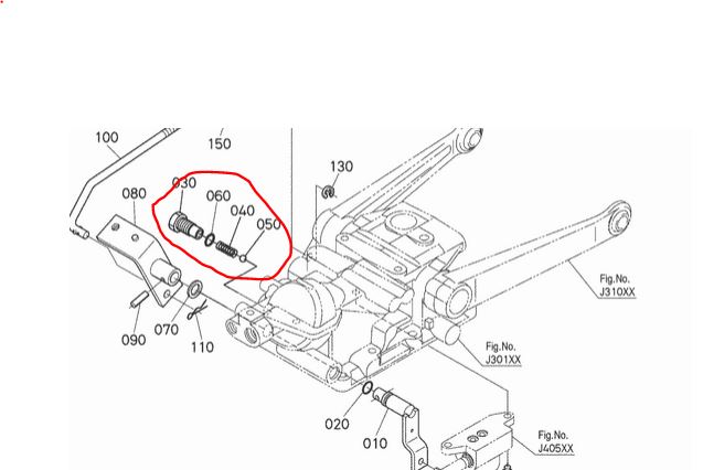

Sorry but I thought your statement of no relief on 3 pt was for the L3400. Actually I'm not attempting to "get you in an error" I just think info posted should be as correct as possible. . I just find it difficult to understand that a 3 pt hitch system has no relief valve. I'm not making an accusation but do you know what the function of the B2920 part outlined in red is?
Thanks,Jim
PS:The older I get the more mistakes I make

What you have circled in red appears to be a check valve.
As far as no relief on the 3pt, consider this.
If the loader valves are built in and have a relief valve, and the flow path is from the pump to the loader valve, which has a relief.
Would a relief for the 3pt be necessary?
The basic tractor would probably have a 3pt relief valve, as most use the 3pt functions.

OK consider this if all B2920 tractors aren't equipped with a FEL then what protects the 3 pt if no relief valve is listed in parts? Does that indicate that ALL B2920's have a FEL installed at the factory or before they were sold new?
It could be that they may not have the FEL ... but they do come with the control valve for it.
