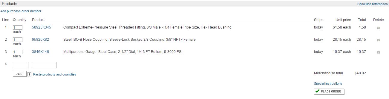

For $6 more we have one that includes a liquid filled 0-5000psi gauge, a 30" hose, and it's assembled ready to go.
If you just need the ISO7241 "B" Type nipple, we have those for only $6.50.
While I love McMaster Carr for their quality products and fast shipping, they are not always the best source.
Thanks for the heads up, Kenny. McMaster can be a beast to navigate so it looks like a quick order on your site might be considerably easier.

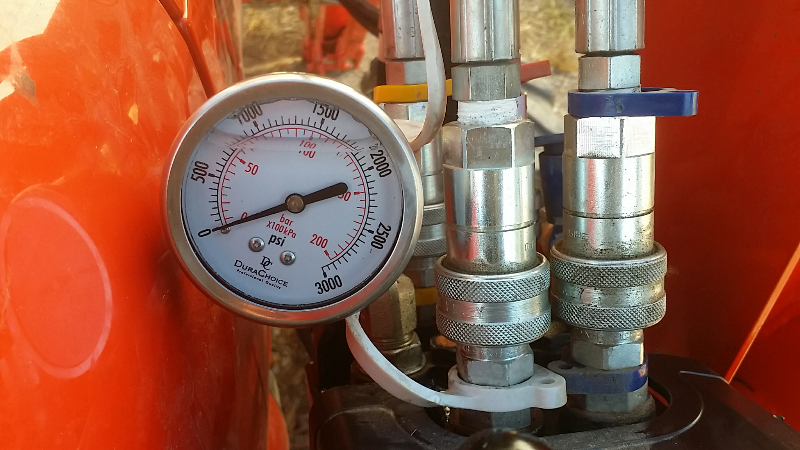

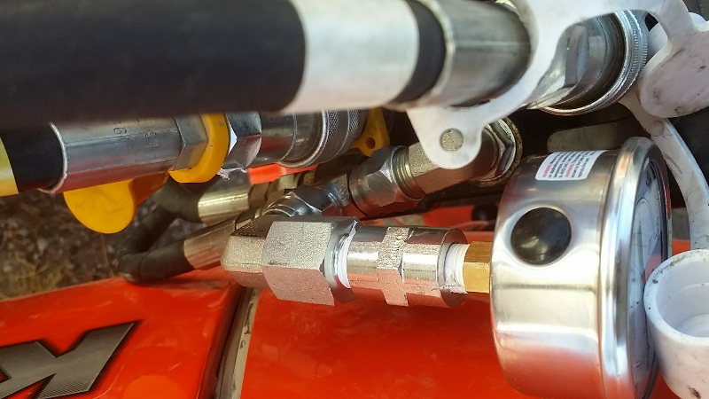

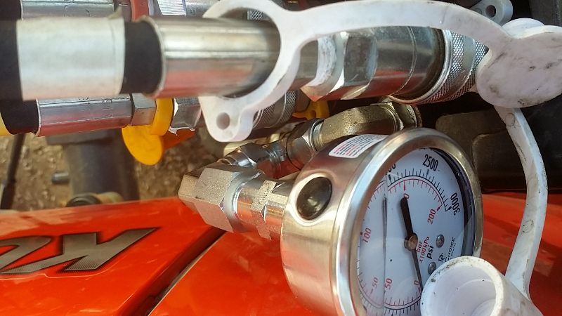

Here is a picture of the wet gauge I installed today. BTW it was set at about 2275 and plan on bumping it up to 2650. I have a 4 in 1 that has been the best thing I could have ever put on, and I think it will really help the grab capacity.
   / Bump up lift capacity of L3400/LA463 Loader #343
[snip]
Do you leave that on all the time or just when you're adjusting it?
Same question for everyone else that has one of these.
Thanks,
   / Bump up lift capacity of L3400/LA463 Loader #344
Yes it is a permanent setup
   / Bump up lift capacity of L3400/LA463 Loader #345
I just put mine on for purposes of evaluating the b4 and after pressure.
