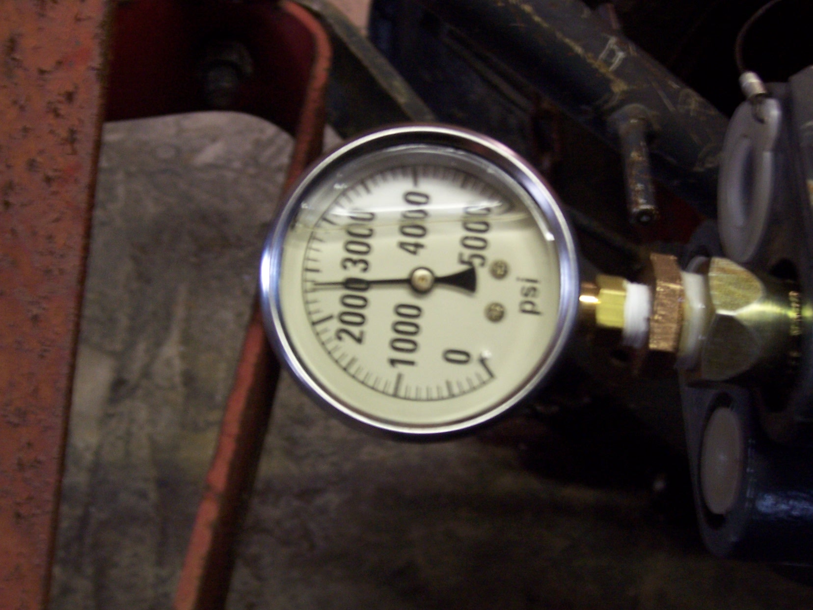

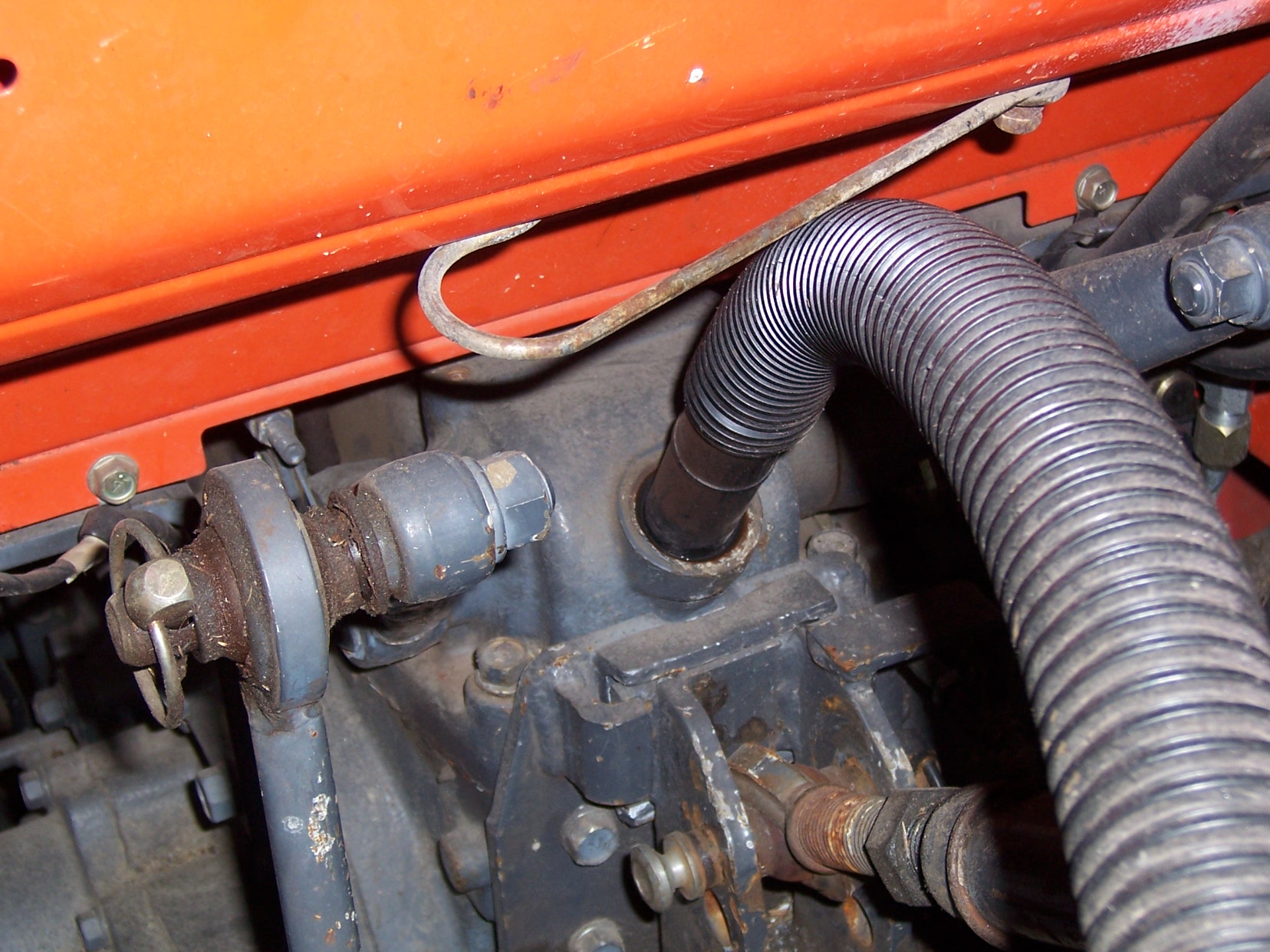

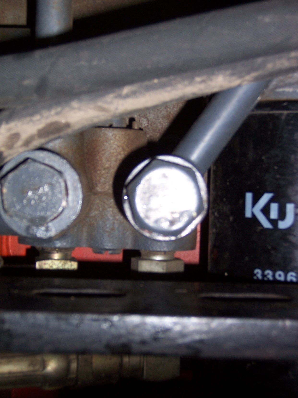

Ok, so I have an L3300 which is pretty much the same tractor and decided to check the hydraulic pressure and see if it needs a boost. I put together a pressure guage from Northern Tools and connected it to a spare male tip so I could use my remotes to measure the pressure. Got around 2100 psi, so I decided to go for the increase. I hooked up my shop vac to the hydraulic oil filler to prevent any fluid from spilling and turned it on. Took a 7/8 inch socket wrench and removed the left hand plug (when looking up from underneath the right side of the tractor).

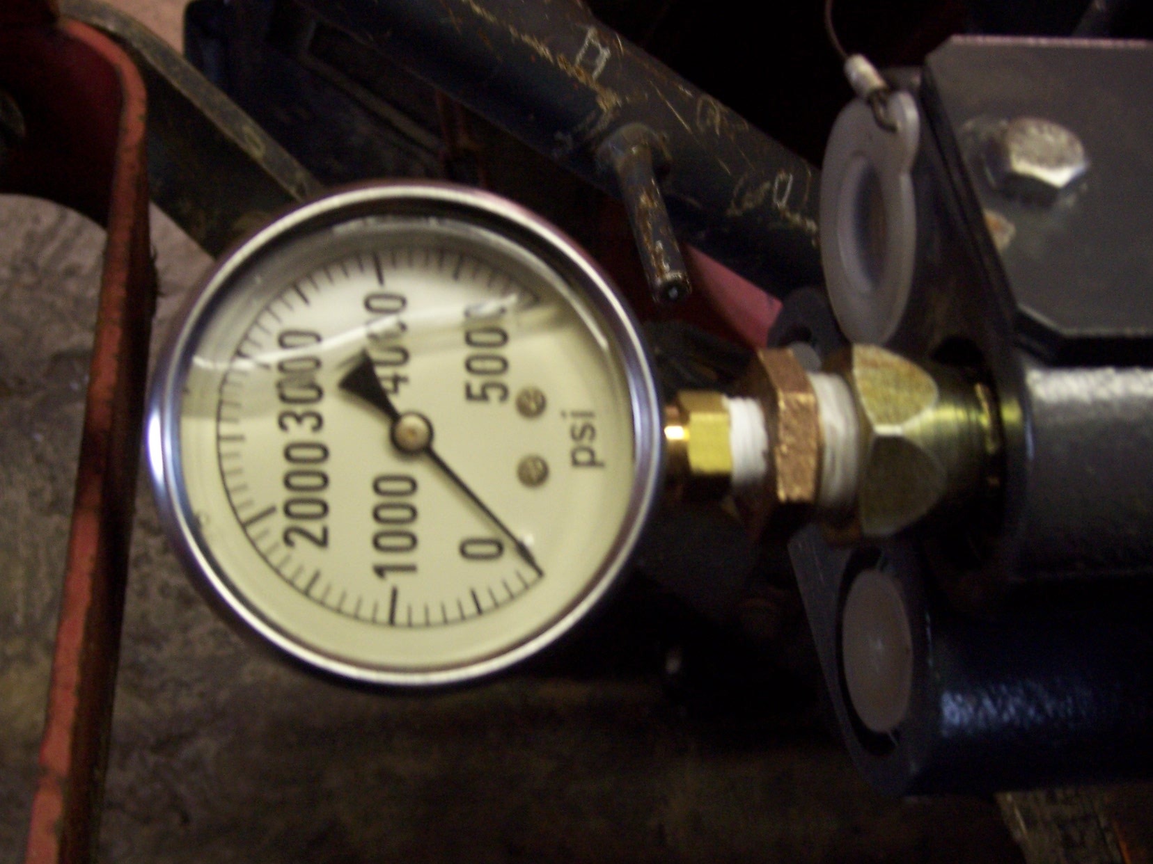

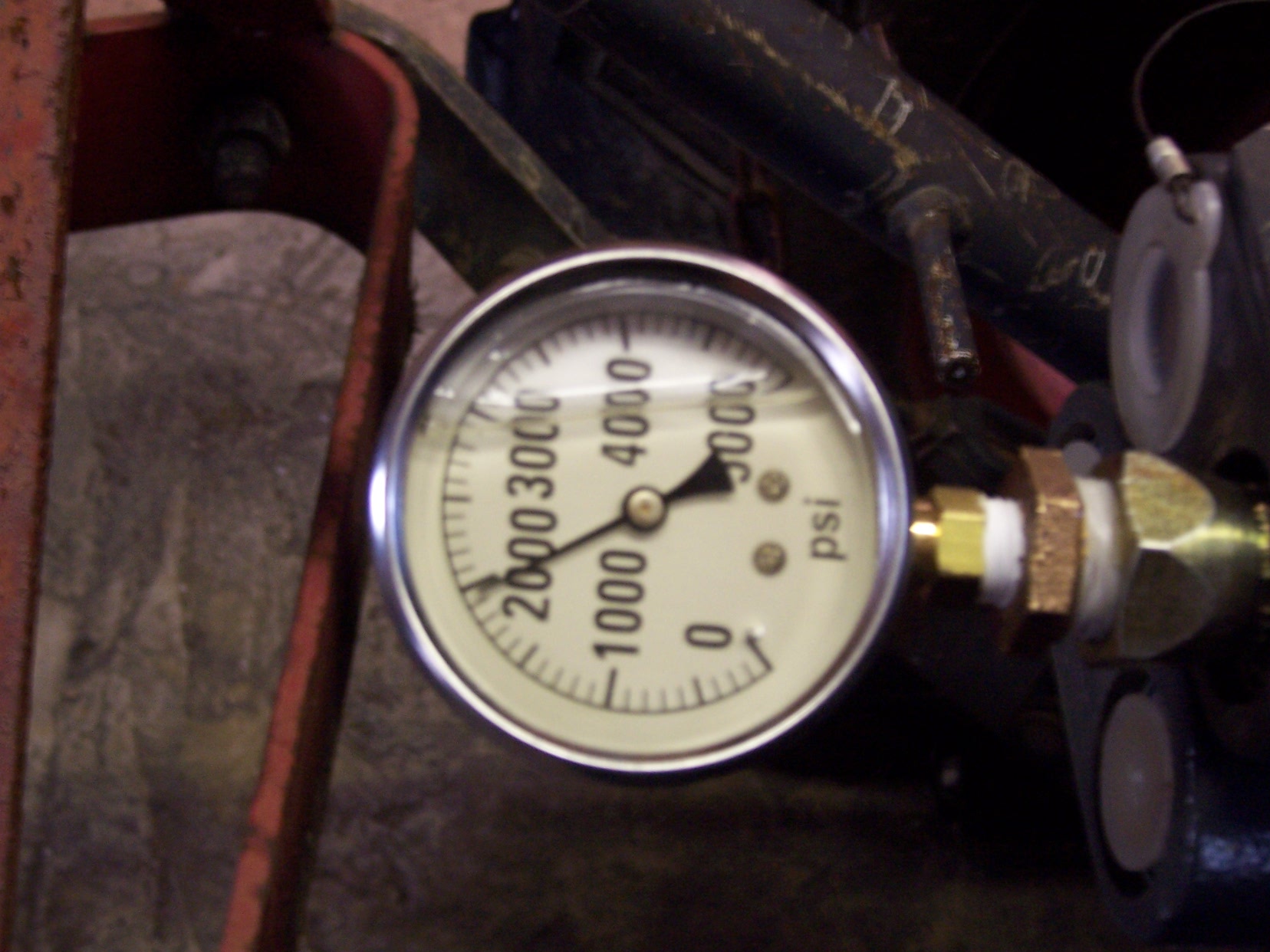

OK, back to the upgrade. I pulled out the plug and spring assembly. The upper part had to be pulled out with a pick as the vacuum from the shop vac was keeping it in, although it isn't necessary to remove it. I put things out on the bench and measured the existing shim located below the spring. It was a single shim of .2 mm width. I purchased a #10 washer at the local hardware store for pennies. The actual dimension of the shim matches a 6mm washer perfectly, but either will do. The washer was 1.2 mm thick, so I removed the existing shim and used only the single washer. I put it all back together and torqued the plug to 45 ft lbs and started her up. Got around 2500 psi, which I am quite happy with and will see how it works out before making any other changes. Pictures show before and after pressure. A 400 psi increase with a net increase in shim size of 1 mm seems to be consistent with the manual which shows 38 psi per 0.1 mm.

Canoetrpr: You literally won't lose a drop of hydraulic fluid if you put a shop vac on the fill port for the hydraulic fluid. The air gets sucked into the relief valve rather than fluid pouring out. You don't get any in the shop vac as it is way above the fluid level. Saves making a mess.
