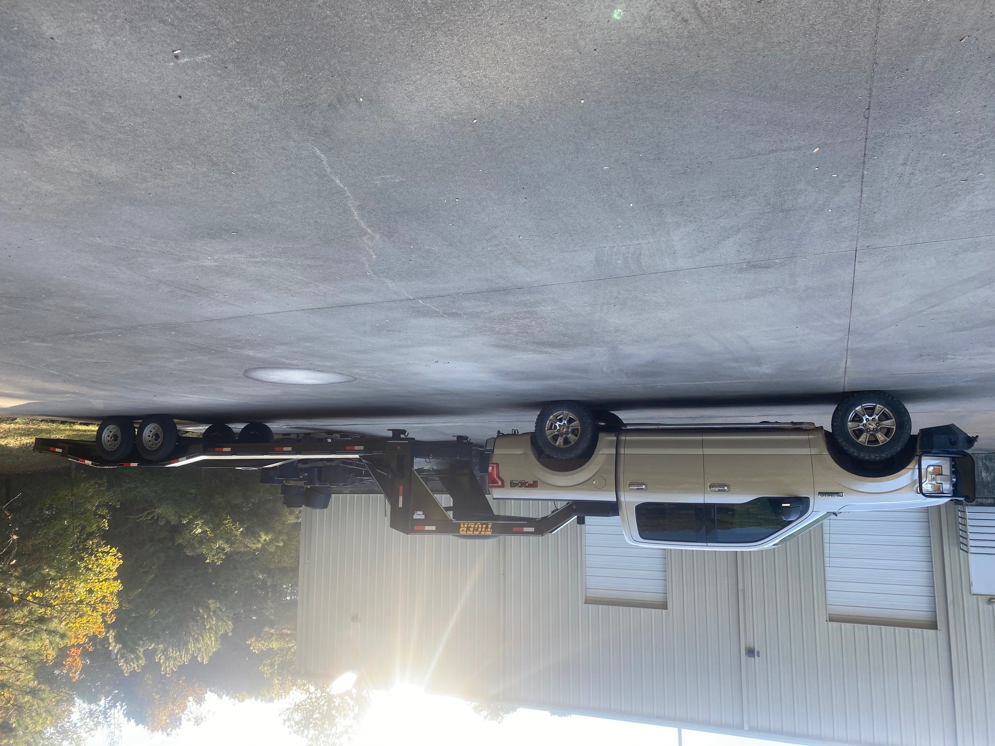

Just an update, I did end up going with a 24'(21'+3") 102" wide with drive over fenders. Here is a picture of hooked up empty. I measured the distance from the fender well to the ground, front and rear before and after. I will also take measurements after I get the tractor loaded this weekend. Thanks for all of the discussion on this.
No trailer: Front: 39-1/4" Rear: 40"
Empty Trailer: Front: 39-1/4" Rear: 38-1/4"

Nice. You might want some air bags for the rear end of your truck..... squatting pretty good already with an unloaded trailer. Even with all that dead weight bolted on up front, haha.
I suppose you "leveled" your truck ?

Yes truck has 2.5" spacers in the front so that contributes to the perceived sag in the rear. I do have an "add-a-leaf" put on the rear. I'll see how it looks with the tractor loaded Saturday or Sunday.

Air bags are great!
I added them, and it made towing pleasurable.

I think the idea of air bags is a good one Your trailer is NICE I like the drive over wheels
My fifth wheel tilt bed is a Real pain when hauling things like cars...- have to climb out the window once on the trailer because the doors hit the trailer fenders.
Only thing that is a question for me looking at the trailer is an appearance the wheels are a bit farther back than some others, with a good sized CUT parked centered it looks like the tongue weight could be a bit more than some other trailers.
No big deal, Just thinking May need to tie the tractor down a bit more rear ward to get the tongue weight where the F-150 is Happy.

Thanks! I pulled my tractor back home this afternoon and had the forks on. I had them flat on the trailer and almost touching the front and it seemed to pull well. I値l post a picture when I get on a computer.
I did measure the height of the Rear fender well though.
no trailer: 40
Empty trailer: 38-1/4
With tractor loaded: 36 (appx 6,500 lbs tractor or 10,500lbs tractor + trailer).
Truck only with 1000 lbs in bed: 38

Take and post again next time but do the front rise along with the rear drop. That tells you more than the rear alone.
Are you applying your weight distribution at that amount of rear drop?
