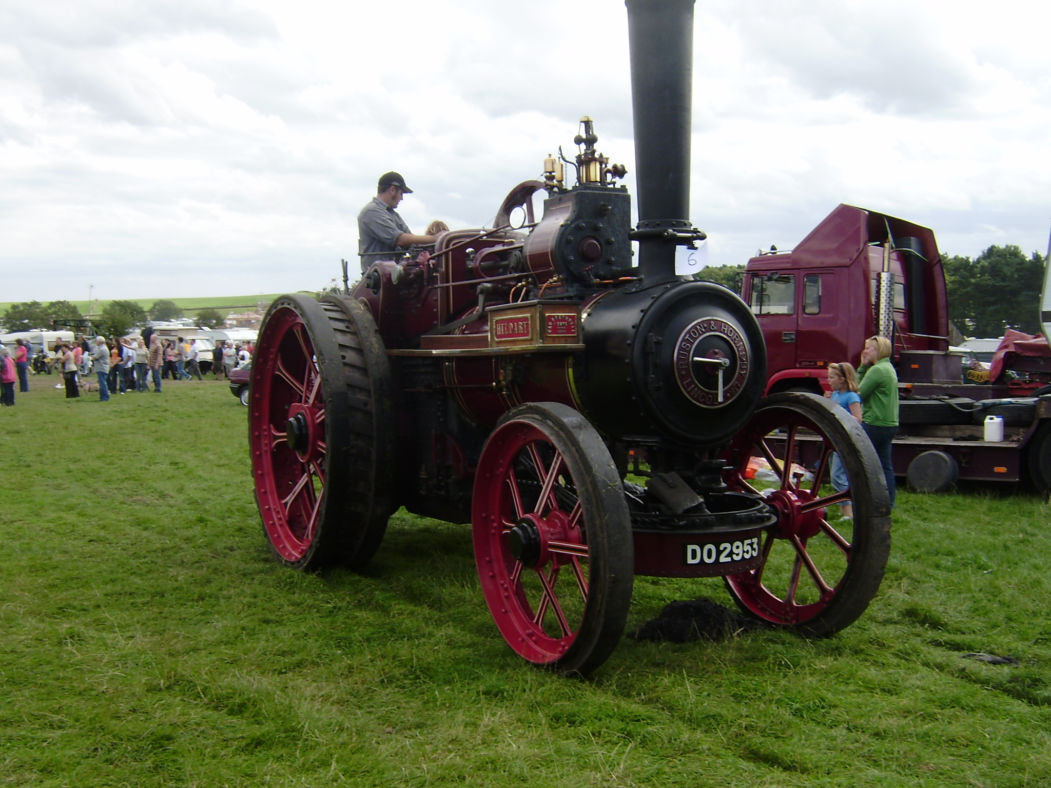

You're only about 150 years late there bud....
Interesting. Looks like that old smoothie has be retrofitted with some solid rubber pads to enable it to run on pavement. Reminded me of something I hadn't thought of for years...when I was a kid back in the 40's and 50's, I recall road signs in rural areas that read as follows: "Tractors with lugs prohibited". Didn't mean much then, but I can imagine what one of those old tractors with steel wheels and big lugs would do to a blacktop road.
Attachment 303133
I must be missing something. I saw that in the
original post and was wondering. What does that have to do with generating electricity other than it _could_ be used to drive a generator. It certainly doesn't show any sign of an on-board generator.
