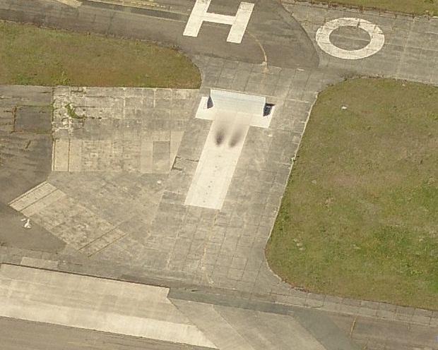

I think you will be far better off to figure out a way to collect the metal parts left behind.:thumbsup:
We had to construct a high power turn-up (read; strap a jet to the deck and fire it up.:shocked:) several years ago and the mix design was very expensive. There were several train cars of a processed shale that had to be brought in from Colorado to handle the heat, about 1400º behind the engines. I think parking garages also use a high temp concrete mix.
