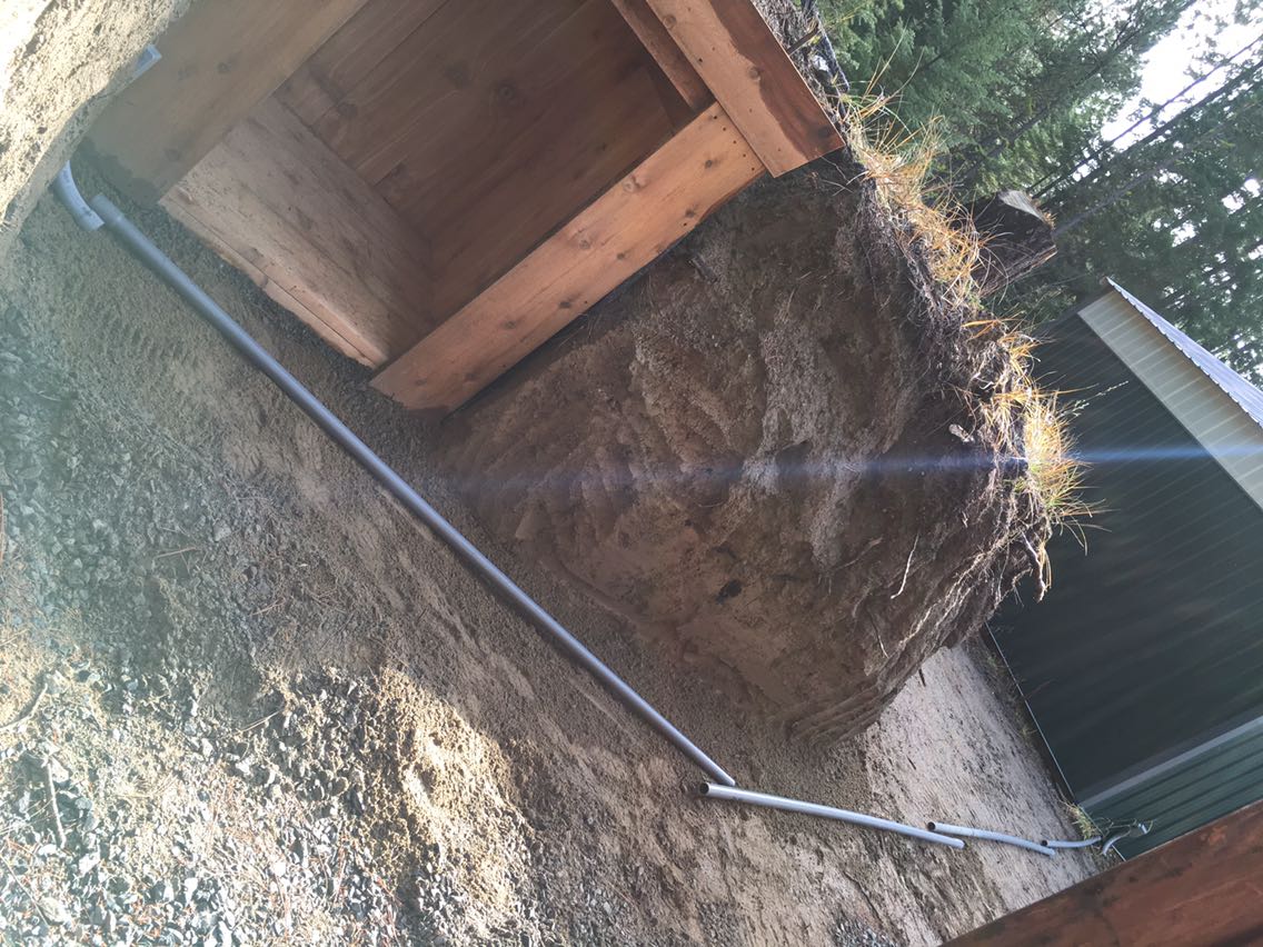

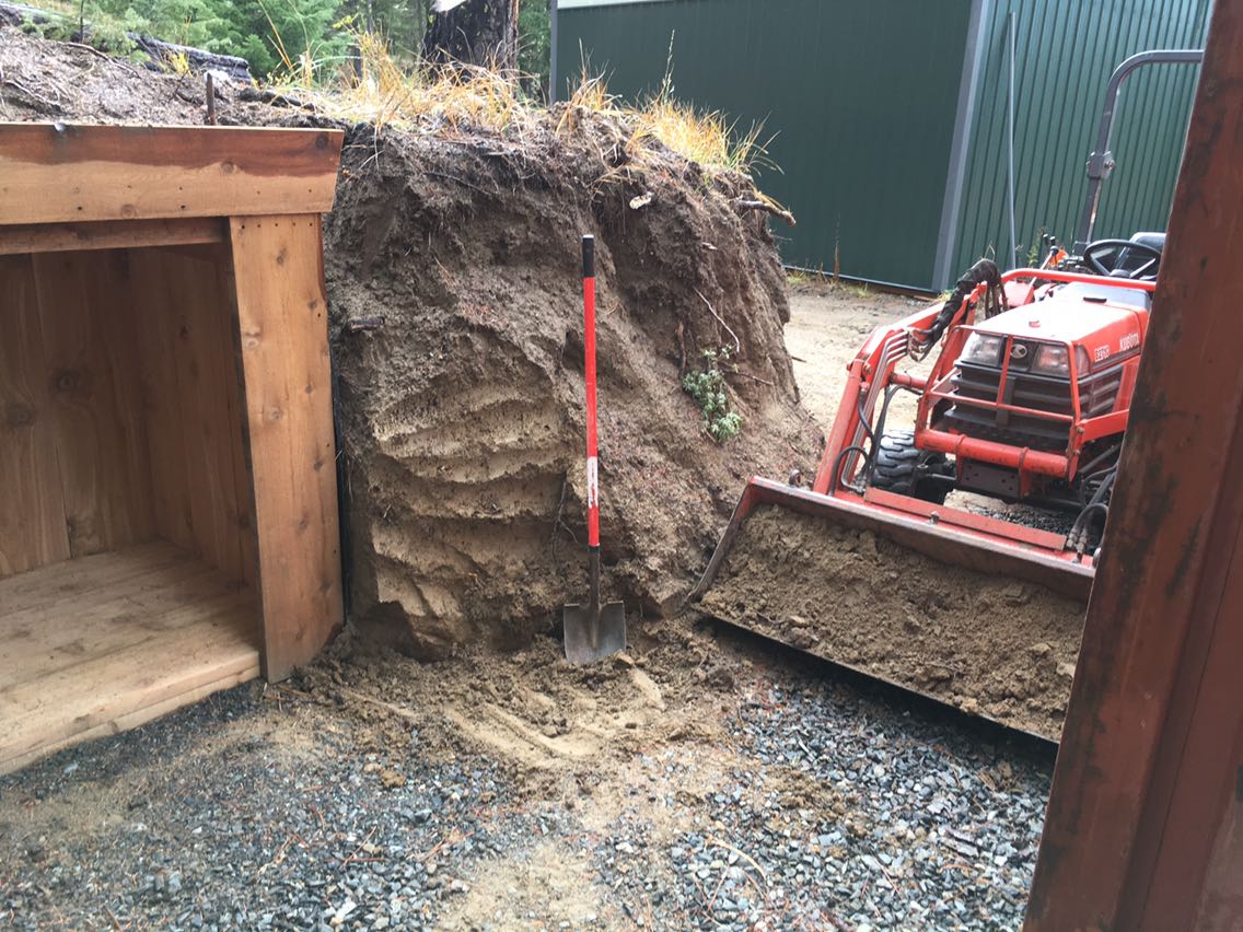

I'm gonna start with a manual form of overtemp shutdown. If it runs hotter than I like, I'll shut it down and redesign the ventilation. If it operates near enough to the limit, where an overtemp safety is necessary, thats too close for comfort, I'd rather oversize the ventilation. The" heat" is "16 Horsepower". Can 435 CFM blow away the heat that results from the generation of 16 HP? That is the "fan sizing question" and someone somewhere knows that answer. If I don't run across that person I'll have to find it by trial & error. My mini-excavator has 17 HP, that gives an idea of radiator size & fan size.

Wet dirt, easy diggin!

Gonna bury the conduit. Have 240v, 120v, 12vDC, and signal wires. But my PVC cement is all dried up dangit I'm dead in the water.
