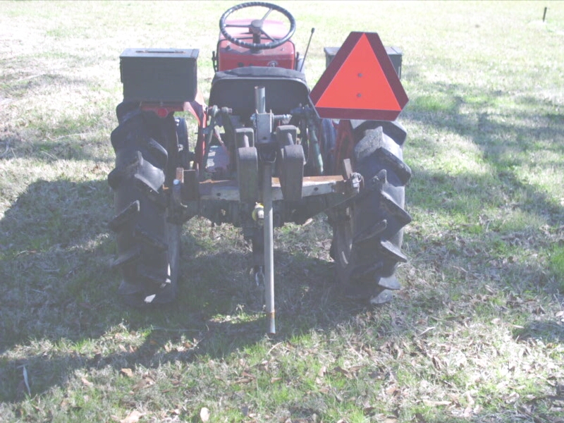

Gustav forced me to bury the cable TV line. This was put together with scrap odds and ends. The cutting knife was a BushHog blade found on the roadside and sharpend all the way up. That is 1" Galv Pipe, the bottom bend was enough. Check out the high tech anti-chaffing feed guide at the top of pipe (qt plastic oil spout).
It worked great, burrying the super duty coax the cable company left, the depth was 18" +/- . It left minimal disturbance to grass, a bigger tractor would have been a plus.
Good Luck
Rhett
