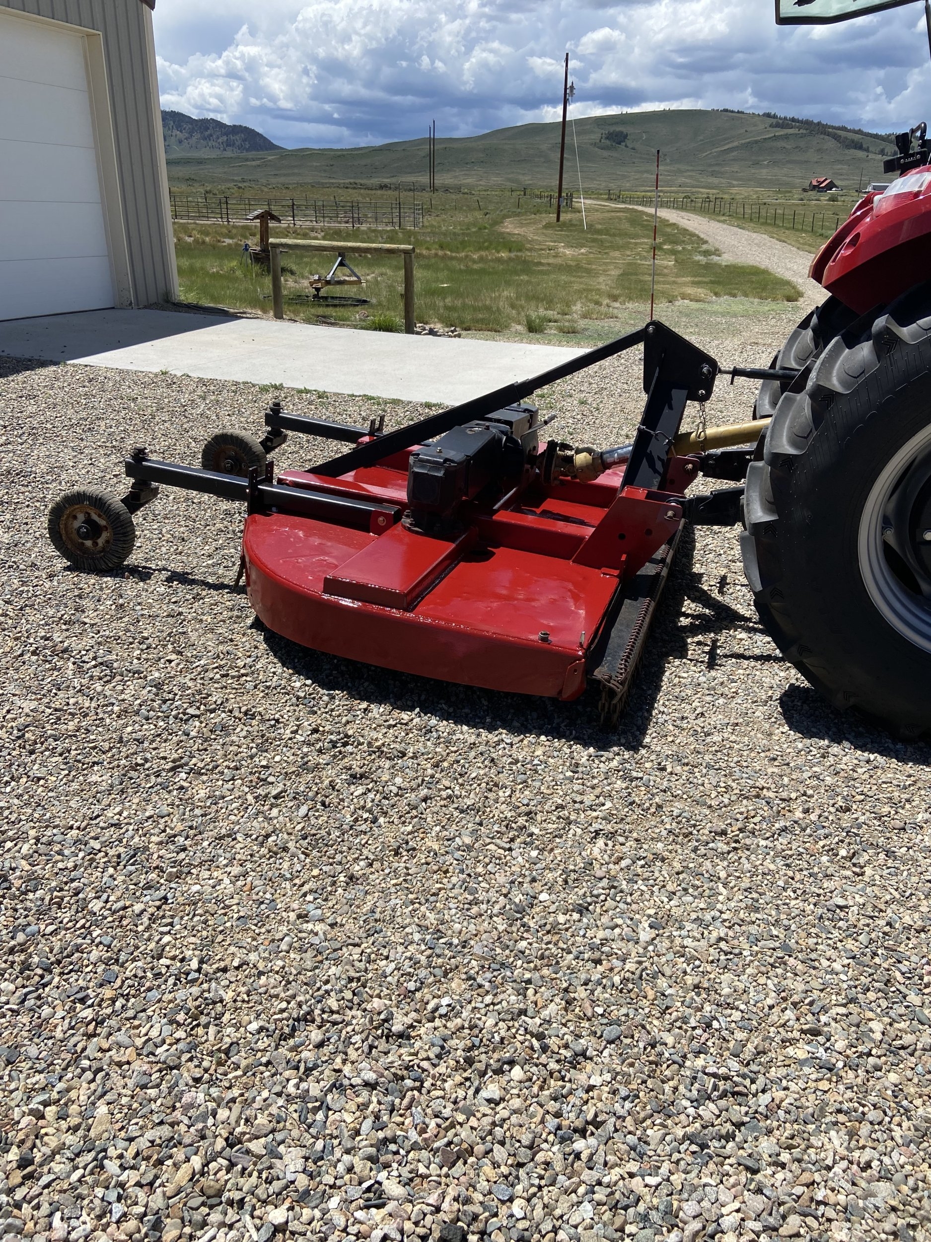

I think I read some place that the U.S. is 540 but in other
countries they have the 1000 rpm equipment
willy
Generally 540 only up to about 70 hp. 540/1000 on 70 to 150 hp. These will have 1 3/8" 1000 rpm 21 spline shafts.
Above about 125 hp, they will be 1000 rpm 20 spline 1 3/4" shafts in the USA
Mowers are ordered with 540 or 1000 rpm gearboxes from the manufacturer.

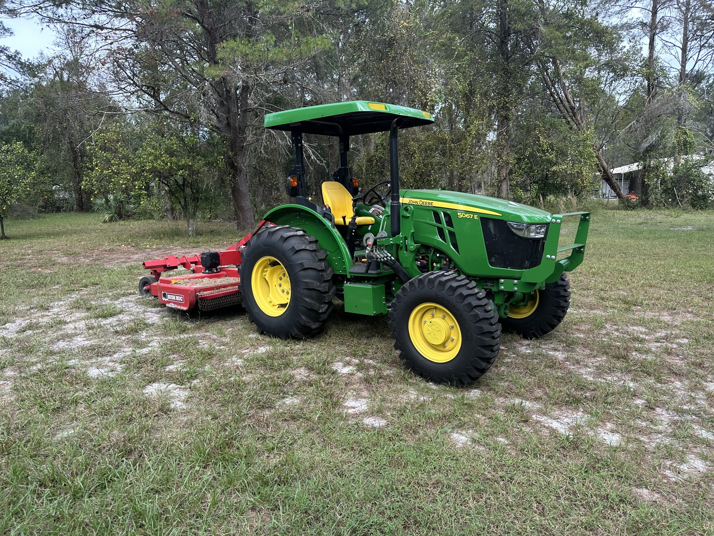

Well I got to test out the mower and its definitely 540! Even with dull blades the mower cut very well. I ran it on my 5067e John Deere and it had plenty of power, even for 4-5‘ tall invasive cogon grass.

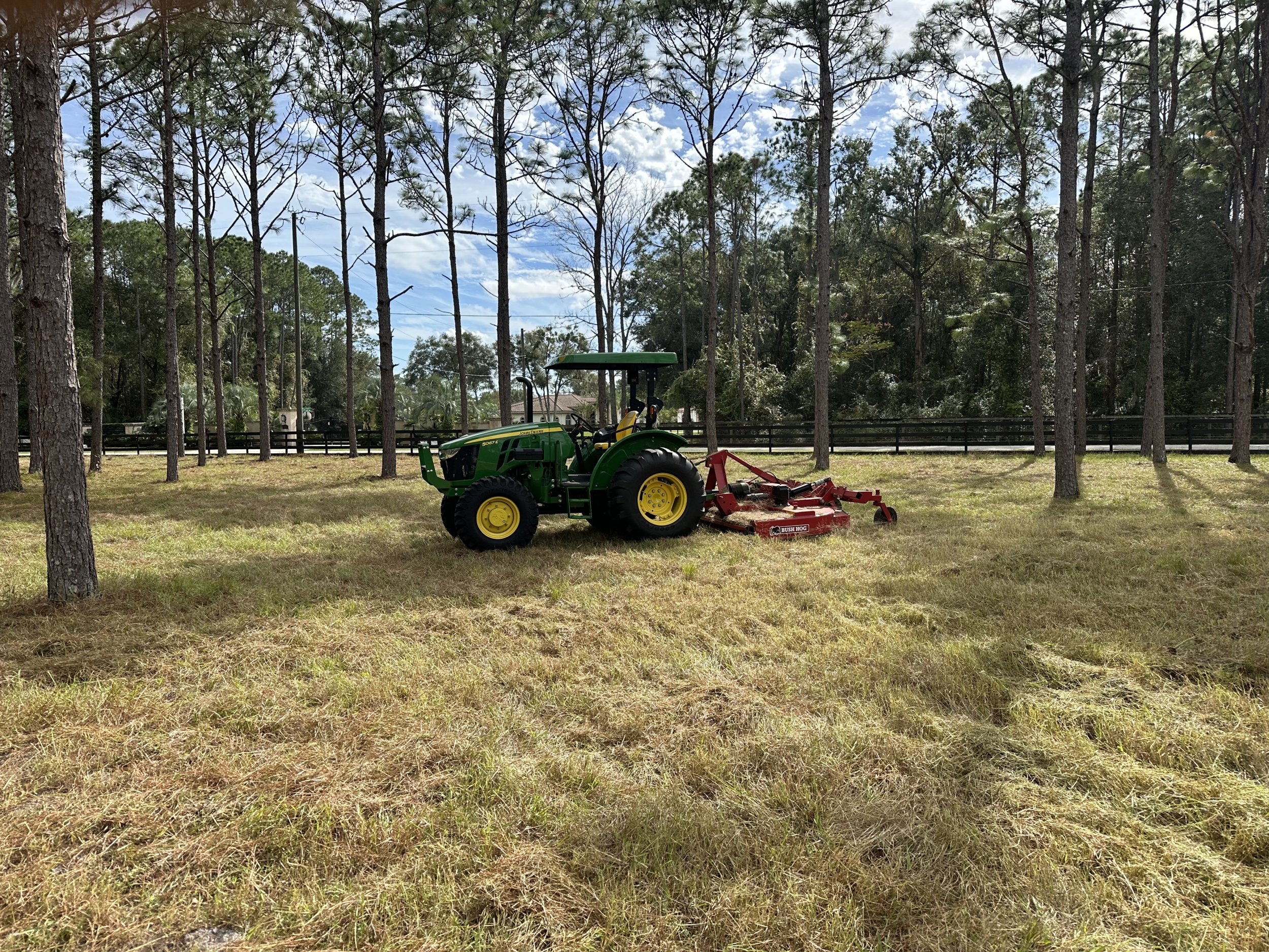

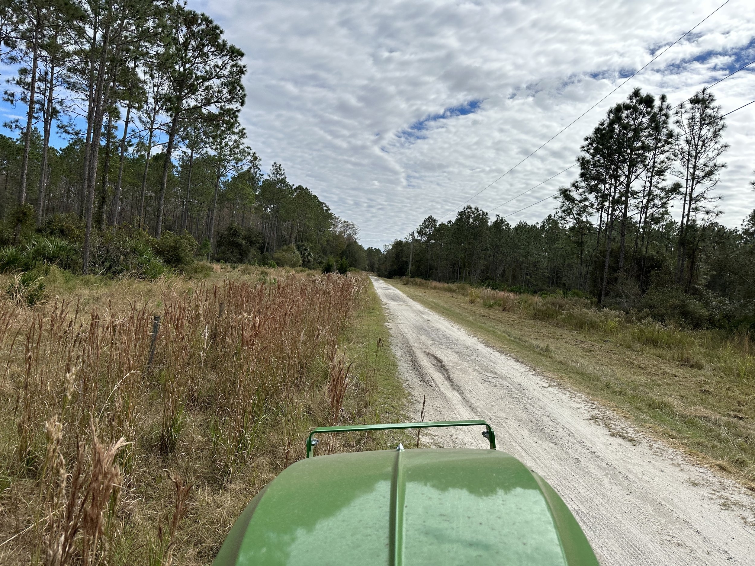

Already mowed a few passes on the other side of the road
The cogon grass was over the hood
All done on both sides of the road. No double cutting required!

Looks like a pretty solid bush hog. Agree, it's 540. I don't think I've ever seen a 1000 rpm bush hog.
I seen a bunch.
I kind of wished I had ordered mine as a 1000RPM.
Nothing wrong with 540.
