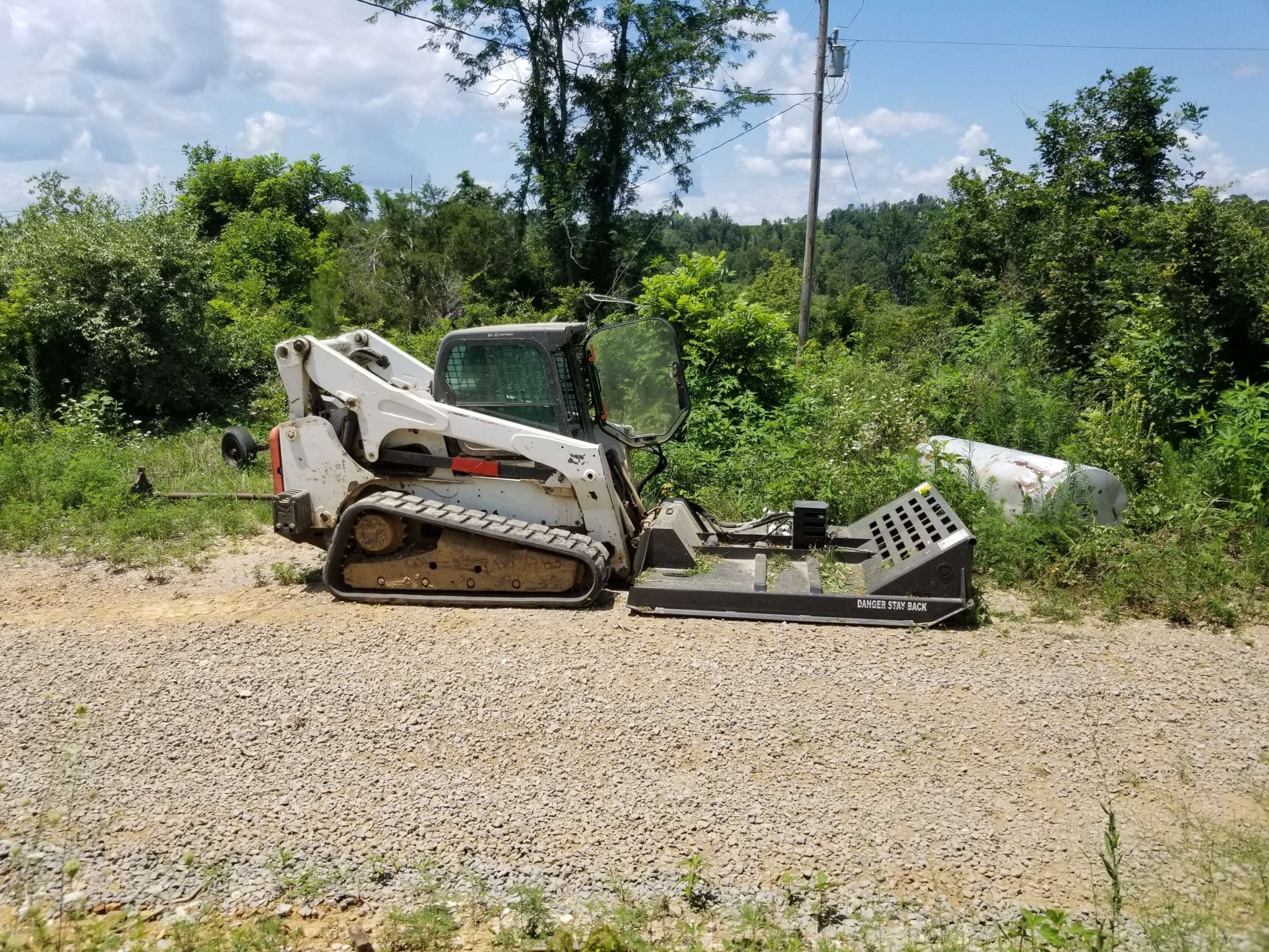

I was looking at a Brown Tree Cutter for clearing some severely overgrown areas but I ended up with a skid steer mower. I bought a Bobcat T870 for storm cleanup and ended up getting a Spartan Attachments brush cutter. It's an 84" model, 3 blades with mulching teeth bolted to the stump jumper, cuts a 10" tree like its not there. Built as heavy as the tree cutter, and easy to maneuver in tight areas. I'll post pictures of it, its a monster.

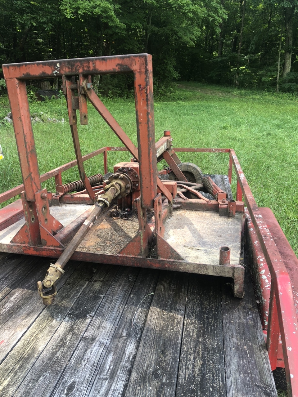

Bought a well used and abused 6’ Brown or pre-brown cutter for $300. 50# of weld bead added. Needed slip clutch, blades and bolts >$1,200 just for parts. Kept for a year before selling didn’t need a another project. Agree 6’ too big for a 60hp tractor.
Yesterday found a 5’ Brown for $1,150. Good shape, no bends or repairs. Blades have not been flipped yet. More in range of my 45hp pto / 60hp tractor. Will use an overriding clutch like I use with the other cutters. With a heavy disk these have tremendous inertia.

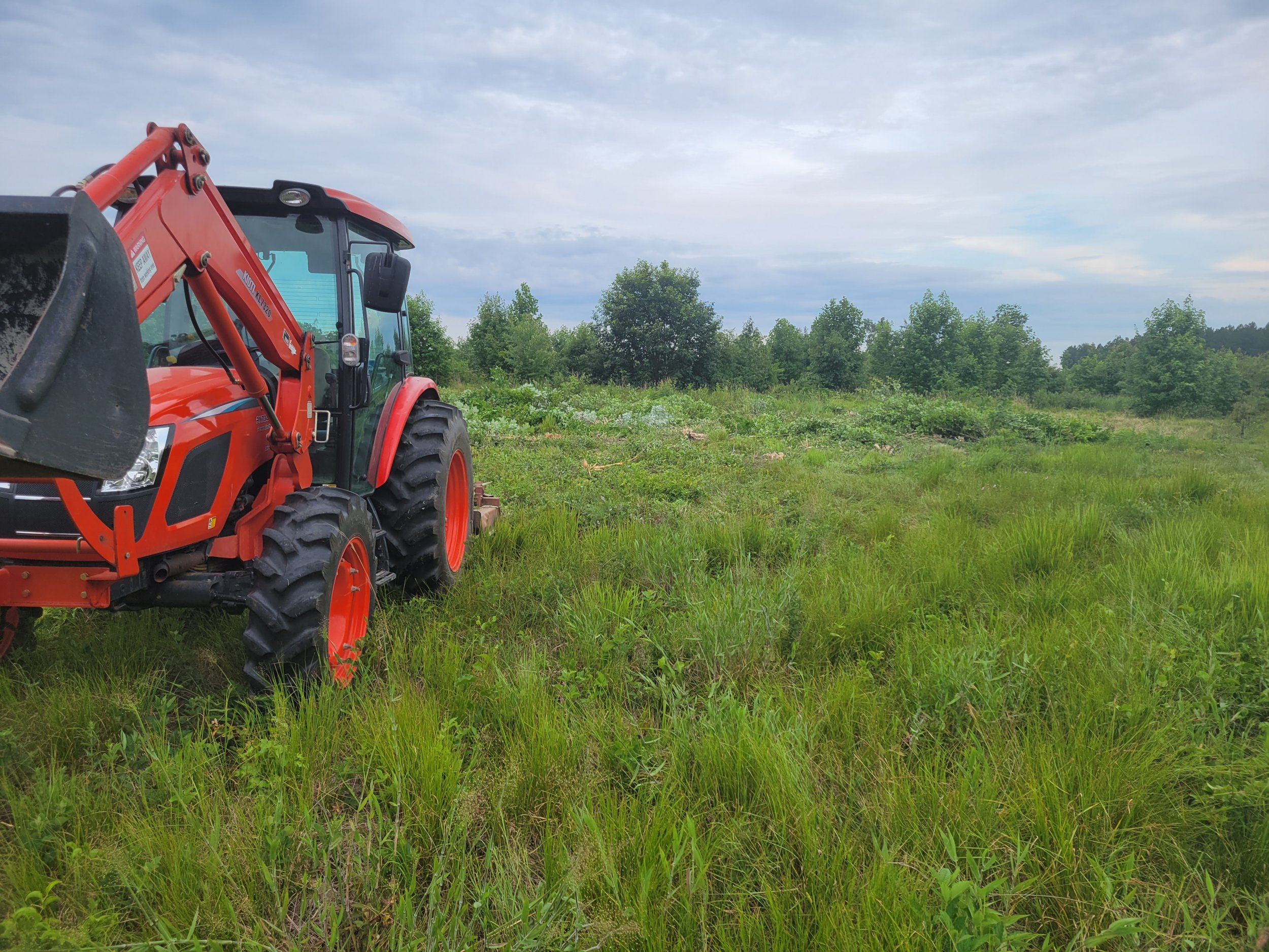

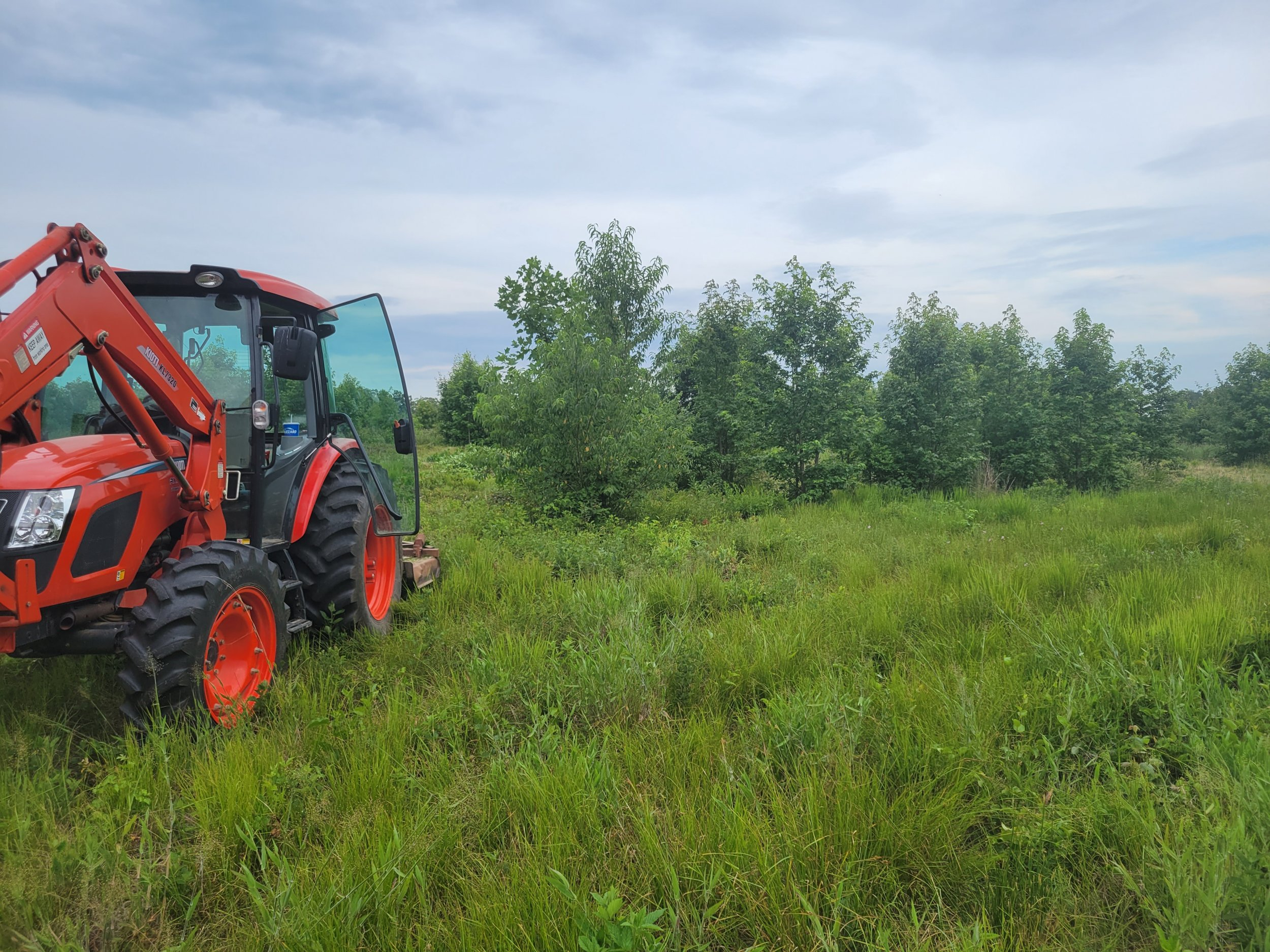

Tried out the used 5’ brown cutter. Grunts the tractor (Kubota M59) to start. Smooth running. Fallow pasture with tall weeds and this year trees no sweat. 2-4” trees or bigger limbs a little more chewing. Mulches better than two blade 286 bushhog. Easily sheds privet, multiflora rose or Russian olive. Doesn’t cut the low grass as much. Leaves no thick cut grass mats. Thinking thatch from bush hogging can kill grass and promote weeds? Need to experiment with summer mowing. Usually time cutting before weeds seed to have fall to spring grass for deer and turkey.
Wouldn’t want a smaller or lighter tractor with the brown tree cutter. At the low end of the power requirement. HST at its best. Providing more Hp than gear tractors;-)
Blades need sharpening and attention to deck rust. Slip clutch slipping about right. Going to be a valuable tool. For perimeter and trail maintenance.

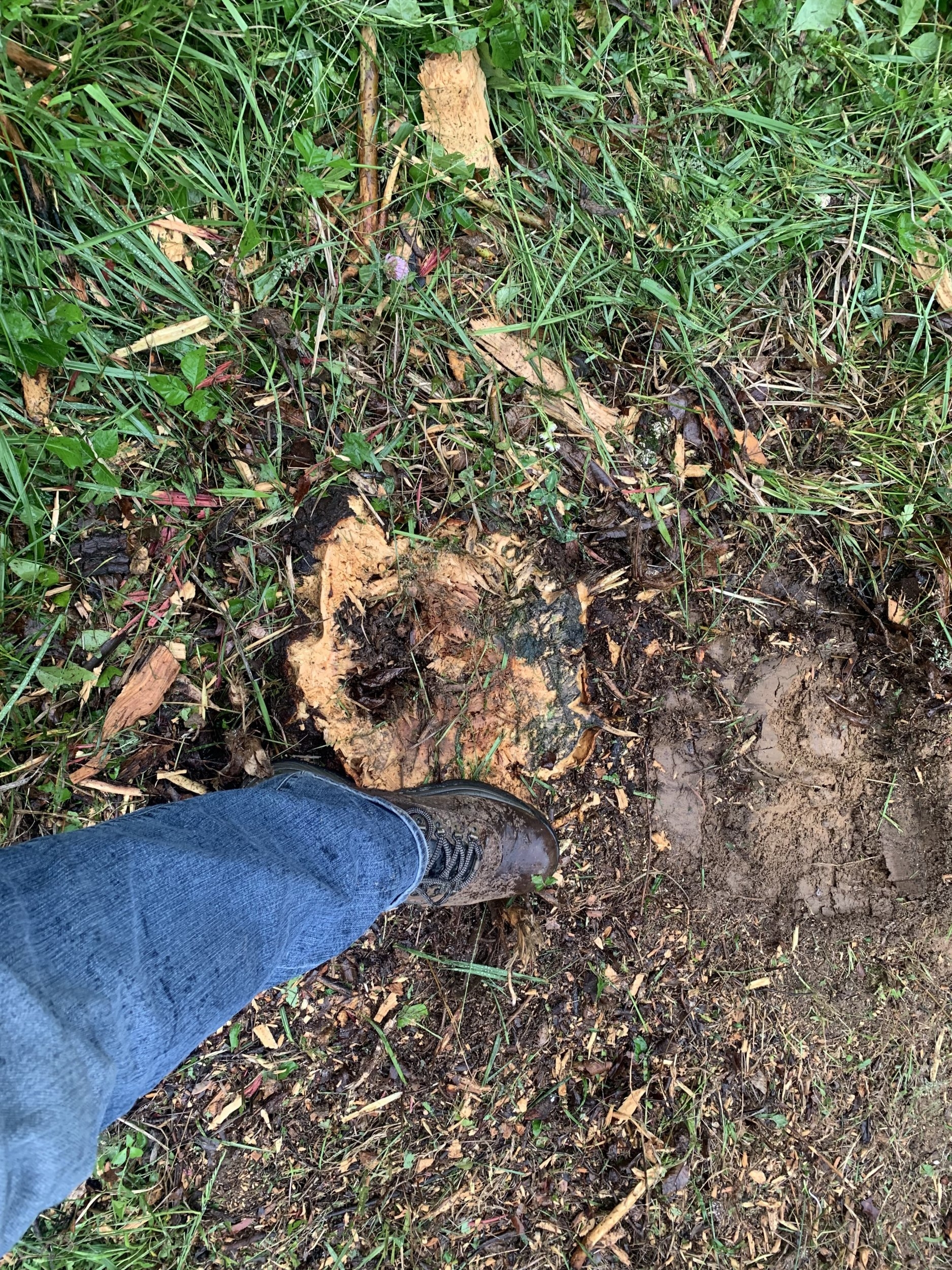

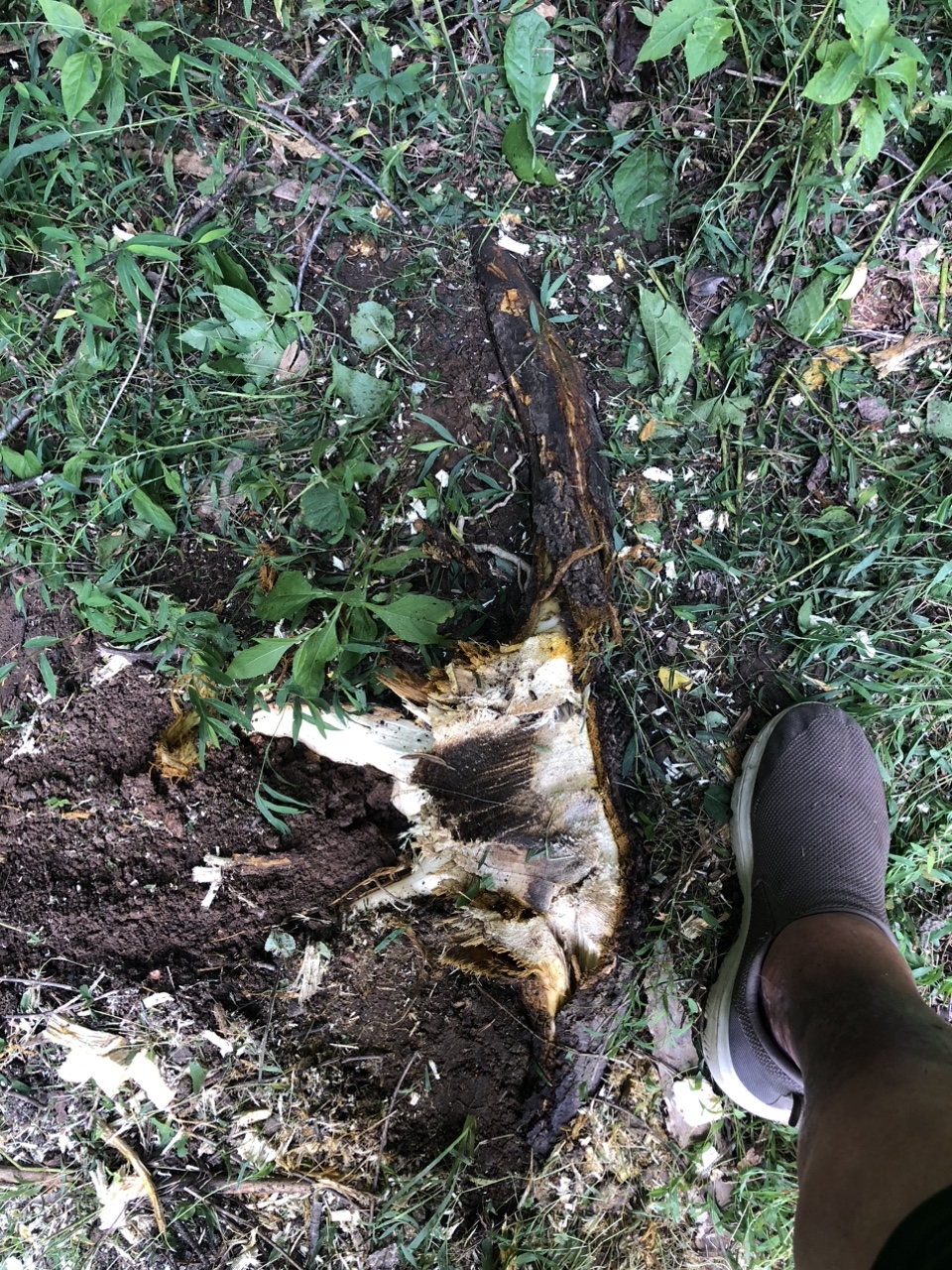

Black walnut stump after cutting. Size 13 shoe. Really too big for this size cutter and tractor combo. Cut 3/4 way thru, pushed into woods with FEL and then finish cutting. Chips really fly. Safety glasses needed. Be much better with sharp blades.

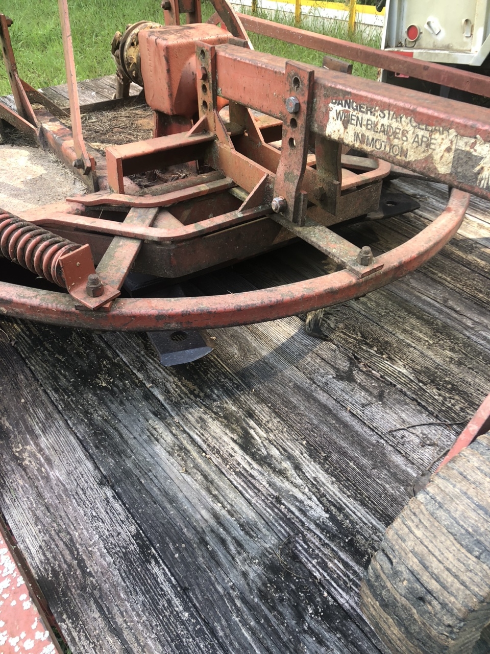

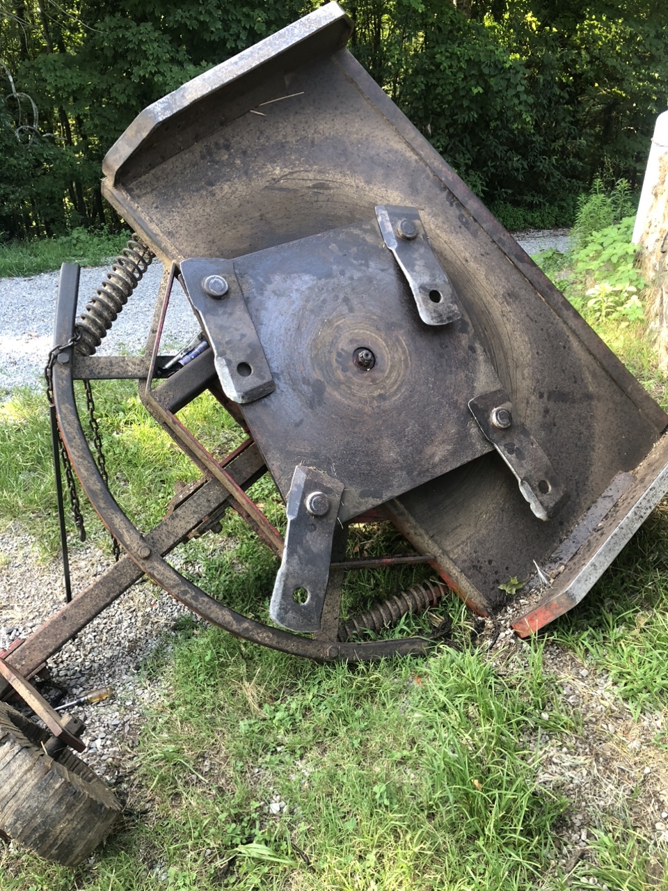

Sharpened the blades. Easy enough on the machine from the back thru the open push bar. The blades have two bevels, on side and end. Blades are flip-able to have a fresh edges. Cutting of brush now much easier. Even took another 1.5” off the black walnut stump.
Gearbox full of grease. Tried to add some OO grease but didn’t take much at the top plug. Don’t see a vent plug. Might get a vented plug. Gearbox warm to touch after a couple of hours. There’s a rubber dampened torque plate in addition to gearbox bolts thru the deck. The torque plate four bolts thru the deck are double nutted and a little loose. Don’t know if buy design or rust? Have yet to find a manual to describe this feature. Haven’t found a manual for this particular model.

Got into a little field fence with the tree cutter but quickly stopped. Found quite a bit of electric and high tensile barb wire wrapped around spindle from previous owner. Due diligence I didn’t check after I bought it. Many hours spent using vice grip, small chain and tractor pulling to clear the wire. Made a long handle cold chisel and forged a long hook tool to help pull the wire out. Gear box has grease but will need a new output seal. Winter project.
Brown manufacturing emailed an user and parts manual. Model pre 1998. Axe like blades hit at 173mph, 54 times per second.

Looks like you can swap ends with those blades.
Yes. They no longer make this style. Blades cut, two high, two low like an axe to take out chunks. These have never been flipped. Has more weathering wear than use. New style is still flipable but with one hole. Ultra tuff space age steel. Set of blades and bolts about $800.

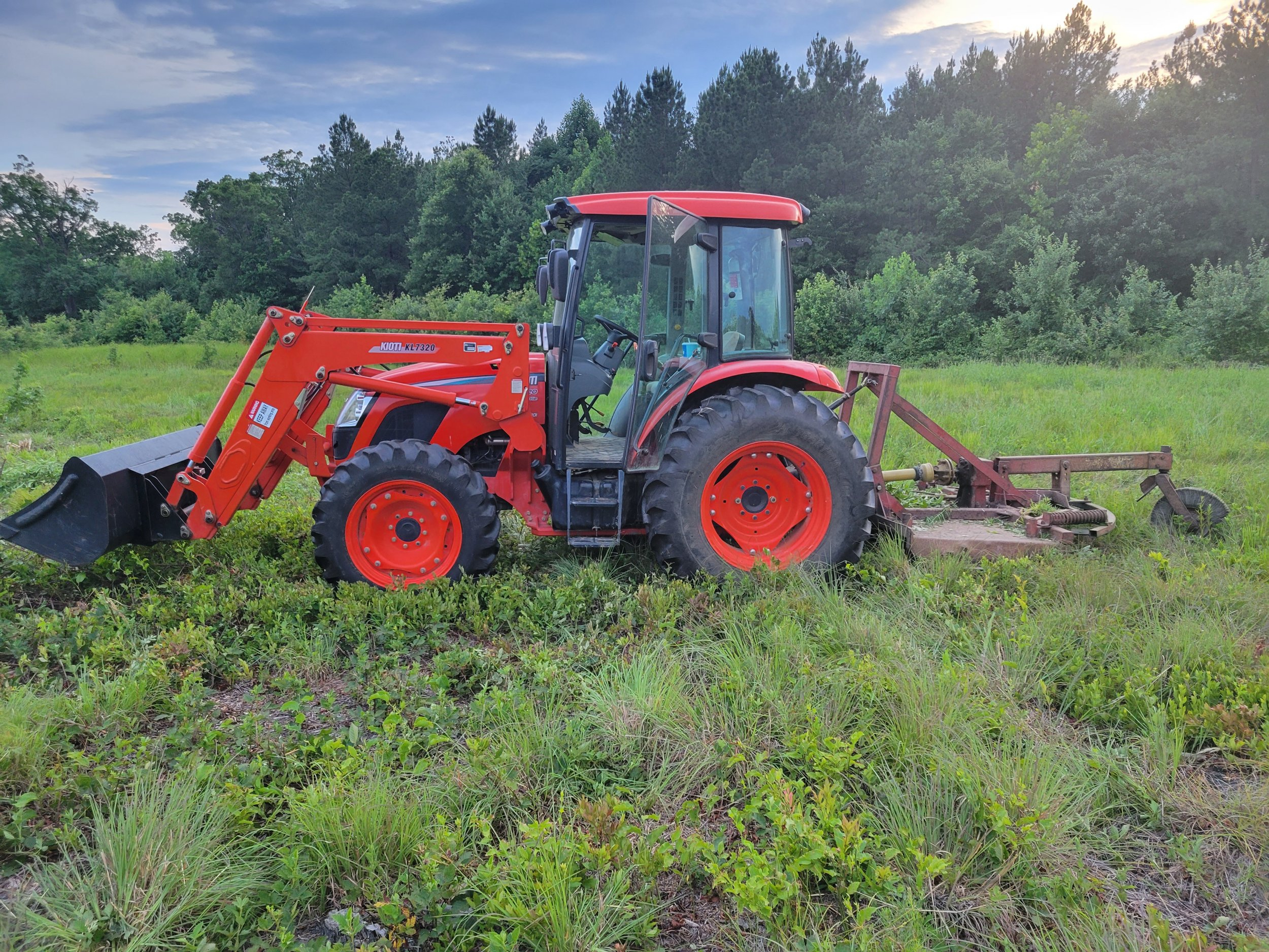

Mowed the pastures off with the brown tree cutter. No real power or speed advantage from a 5’ brown vs 6’ Bushhog.
I can grow black walnuts like weeds. 6-8’ first year, 15-20’ second.
Backing over small trees, clumps of privet, sumac, rose, olive is the biggest difference. Lot of thumping, jumping and noise with bushhog. Brown tree cutter cut’s smoothly without much effort till you hit big stuff you could not even touch with a Bushhog.
