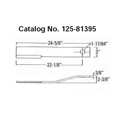

I really doubt reworking them would hurt a thing but they are fairly reasonable priced. They are not that hard, they are quite tough but if they were hard would shatter hitting rocks. They are designed to take brutal hits.
