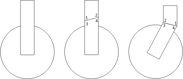

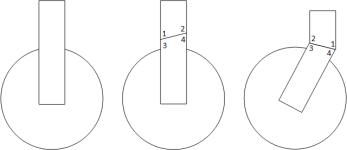

I would probably make one cut at a less extreme angle (20 degrees?), then flip the cut pieces around front for back (so it goes back together at an angle rather than straight) and weld that together.
Only one cut/weld vs two that way.
Aaron Z
Oh, sure, come up with an easier way to do it.:D
   / Bush hog crazy wheel.... #12
I've even got a diagram :D:
The diagram uses a 15 degree cut for a overall angle of 30 degrees once you flip the cut piece around.

   / Bush hog crazy wheel.... #17
Visio makes it easy (5 mins?)...
