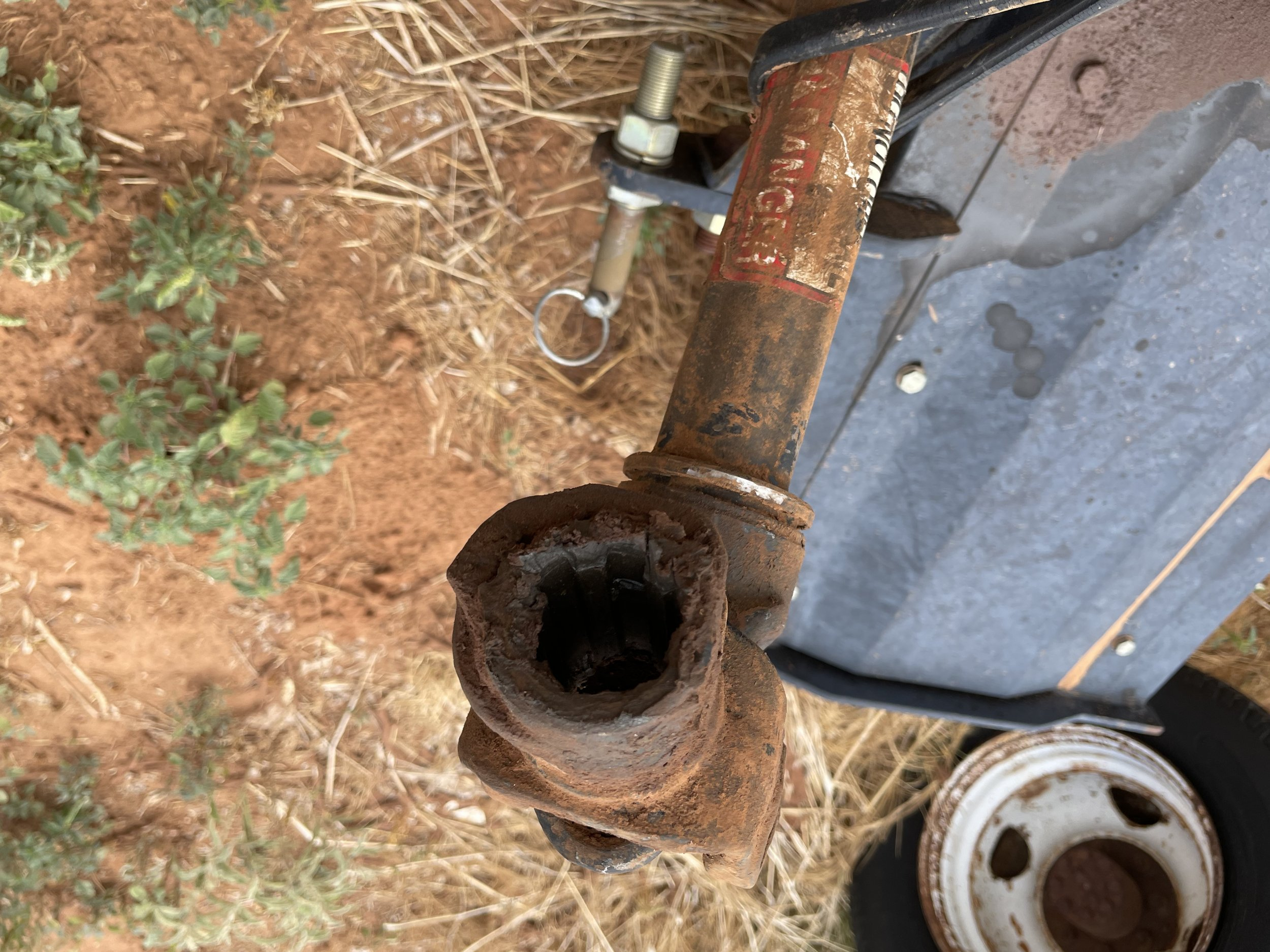

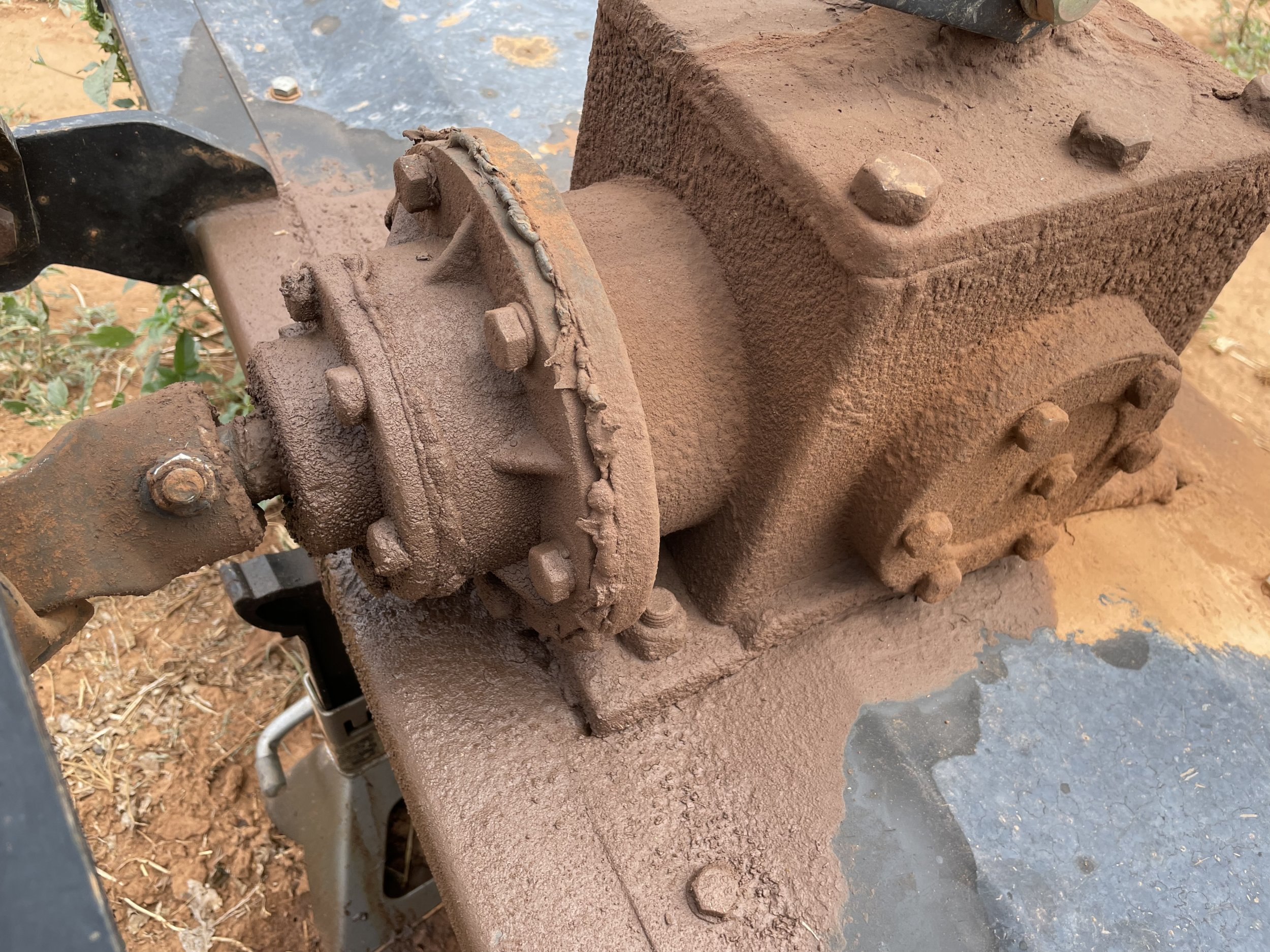

Hope these pictures can explain what I did to tiller
