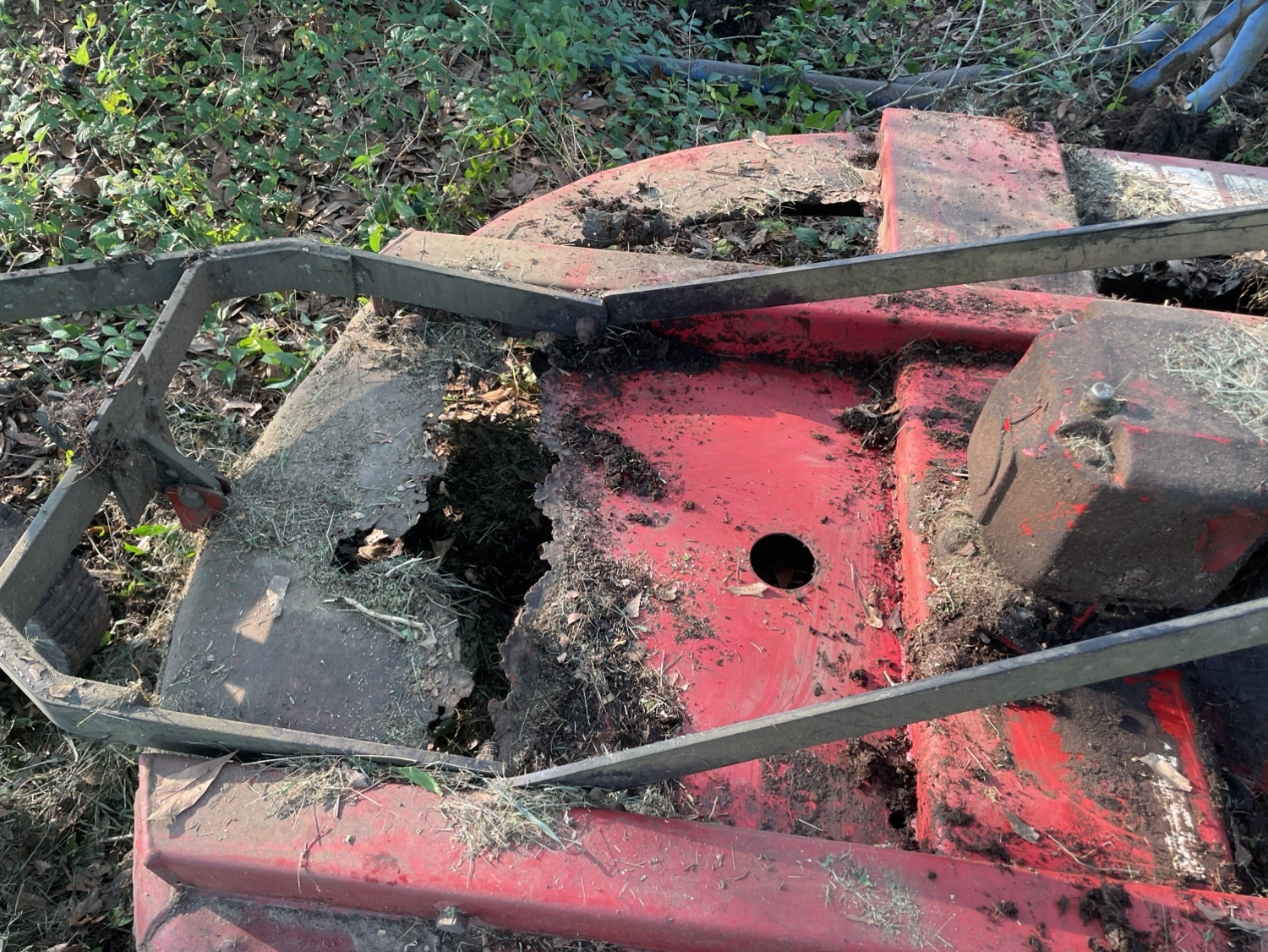

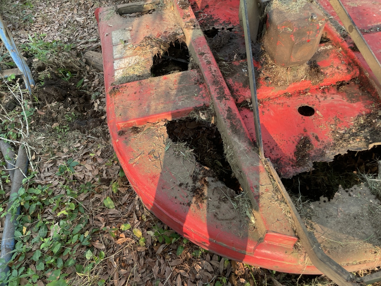

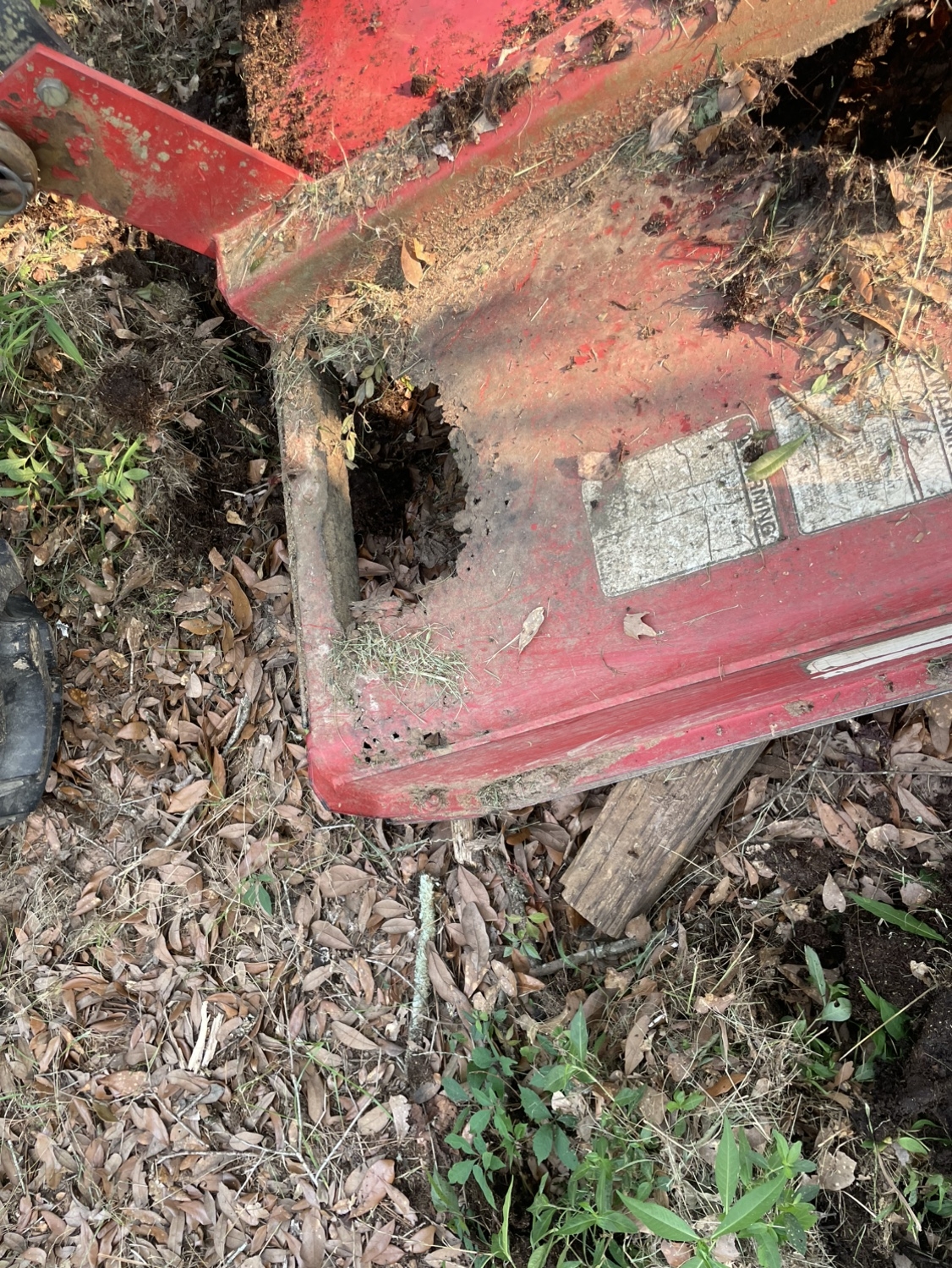

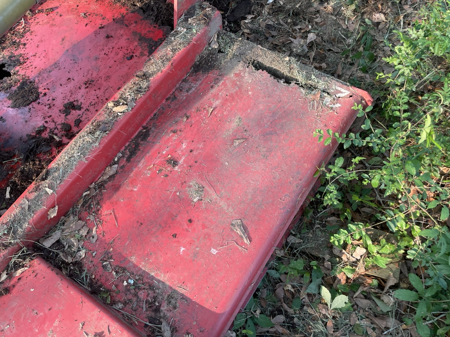

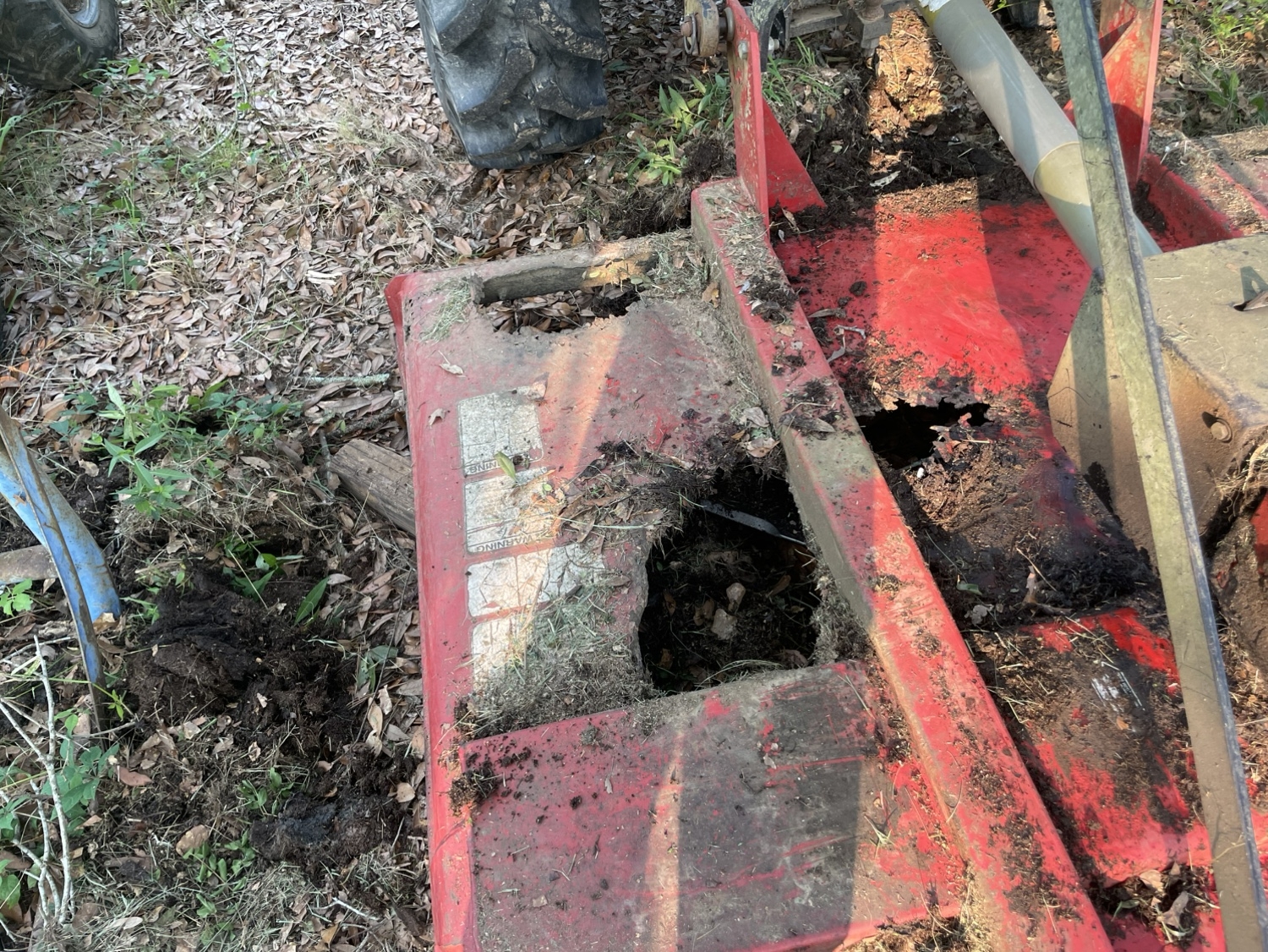

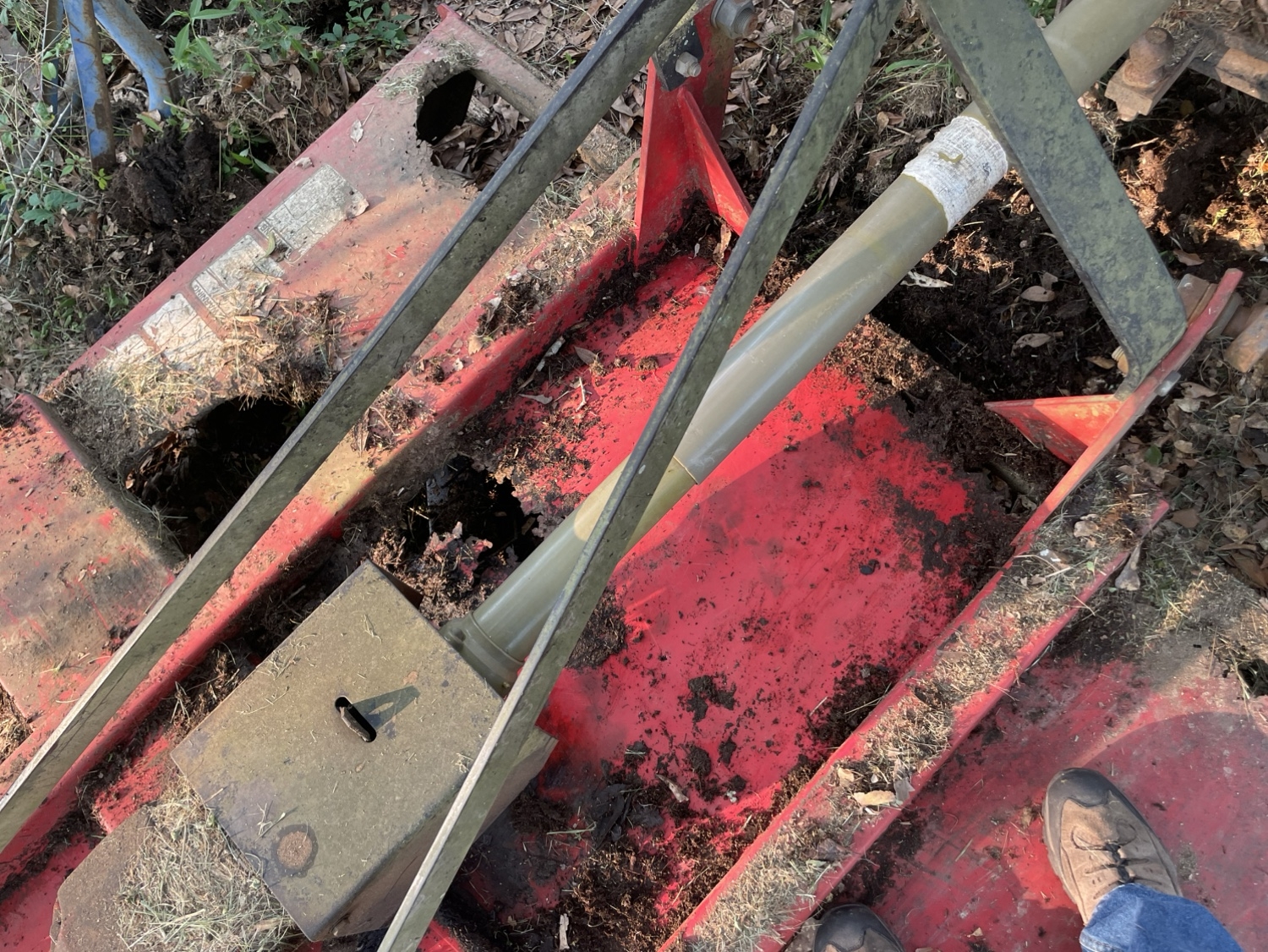

As the photos show, my deck is in bad shape. This cutter is 20 years old and when the rust/rot started it took hold fast. I have acquired some steel plate 1/8” to make the repairs. What is the best option to cut it? I do not have access to a torch, but do have a grinder with metal cut off wheels and can get my hands on a port a band. Thoughts? Any further advice on repair is definitely appreciated. Thanks
Get yourself a metal cutting blade for a circular saw. I’ve cut 1/4” metal with one with ease.

I burned my skilsaw up using one of those.
   / Bush hog Model 2[emoji[emoji62]][emoji62] Deck Repair #15
Can’t force them.
I would limit a circular saw to 1/8 sheet material due the length of the cuts.
For something like 1.5” strap I would likely do 1/4” thick.
Take it to a shop with a plasma cutter and remove ALL the panels. Cut new ones to suit.

Another vote for 4 1/2" grinder with thin cut-off disk. Ever since "Project Binky" (on U-tube), I've been impressed how much can be done with that tool. I've also done the saber saw, cutting torch, saws-all mentioned by others, but those are much slower. like chim, I make multiple passes to grind through the thickness, the first being mostly to set the line of the cut and rest to remove metal.

Would it be worth while to take the cutter to a metal fabrication shop and have it re-decked? Then when you get it back, you can prime and paint it yourself.
Unless it has sentimental value, I would sell it for what I could get for it and go buy another cutter, depending on what it would cost to have it re-decked.

Being the welder I have is light duty, I may go this route. No sentimental value, just an equivalent bush hog is 3k, not really in the budget.
