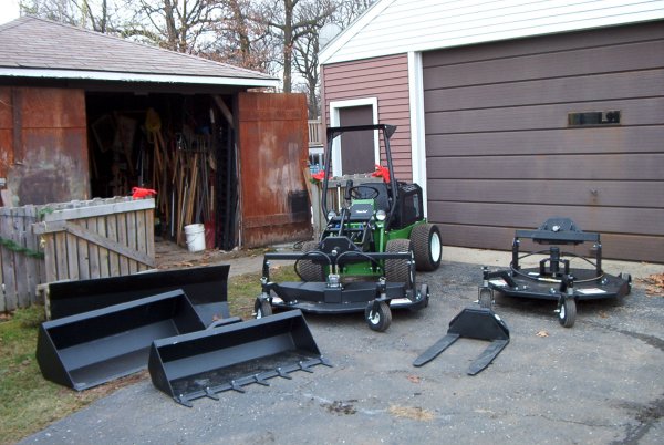

Well, look at a Power Trac for example...
428282d1433464753-bush-hog-front-bx-ptpackage-jpg
ALL implements are mounted on the FEL arms out front.... like the brush hog, mowers, buckets, forks, snowplows, blowers, post hole diggers, etc...
All powered implements are powered by hydraulics. No drive shafts.
For the record, the brush hog rides on its own wheels, so the weight is not constantly supported by the FEL or the front axle of the tractor. You just put the FEL in float and push it along in its own wheels. You can lift it up as high as the FEL will raise, but that brings spinning blades of death about head height with the operator, so you may want to limit how high you want to raise it.
Here's a link to a video of a Power Trac PT425 with 48" brush hog VS a rather large multi-flora rose bush. Out front brush hog works well.
PT425MultiFloraRose.WMV
The mount is made so that the deck pivots on the roll and pitch axis independently of the tractor. The FEL in float takes care of the 3rd axis. If you were going to do this on a standard tractor, you'd need something that supplies adequate hydraulic pressure and flow. My PT425 has 8GPM @ 2500psi. Can you get that from a BX25? Can you get that with an added PTO hydraulic pump? It would be interesting, for sure.
Good luck with your project. :thumbsup:
