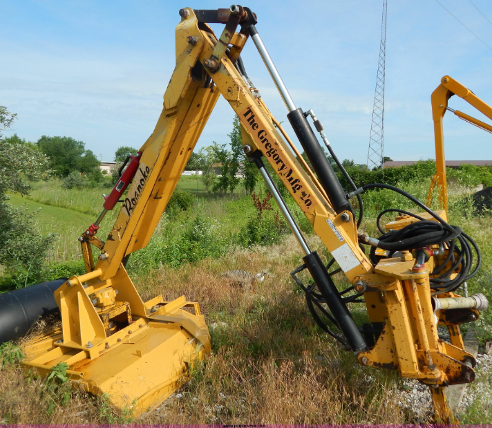

When I started working, we had Roanoke grader mounted bushcutters, they were deadly. The problem with them was you had to have the grader engine reving so fast to get the head speed up, you were travelling to fast to safely control the head position. This isn't one we worked on, it's the only good pic I could find online of a Roanoke unit.
A good friend and I were given the task of figuring out some way to power the head independently. We came up with a Cat 3208 powered unit the would mount to the pivot ball at the front and the turntable mounts at the rear under the gooseneck of the grader, needless to say it was a beast. We ended up making 5± units over the span of a couple of years, unfortunately I didn't take one pic which ticks me off.
Reason for my posting this is that I had hear of two instances where the blade had come off the machine and one had gone thru a car door in a driveway, the other had stuck in a house when it came off. I couldn't imagine the centrifugal force on the blade, the thing weighed over 20 lbs I'm sure.
Scariest part of the whole build was checking the head speed with no load. I got elected to stand on the head holding a tach up near the coupling under the motor mount with these blades whizzing around under you, mind you, it was the safest place to be.
Stupidest thing I ever did was taking the first one out for a test cut on a back, untraveled (much) road. I had never operated a grader before but being young and stupid figured it couldn't be that hard...right, you're just driving on the shoulder? Cutting roadside brush on this road all you could hear was the 3208 roaring, the head screaming and the grader engine. I never noticed a guy wire for a light pole...that was till I hit it, even then all I remember was hearing a wierd "twang' noise. we got back to the shop and my buddy who was driving the pickup behind me asked if I had seen the guy wire go. "what wire" I asked him. We went back and looked, the guy wire was looped over the horizontal wire on the pole which was thankfully not a power pole but telephone only for someone who lived way back in the road. Fun times...when you're young and don't know any better.
