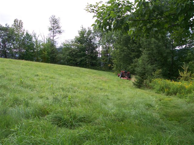

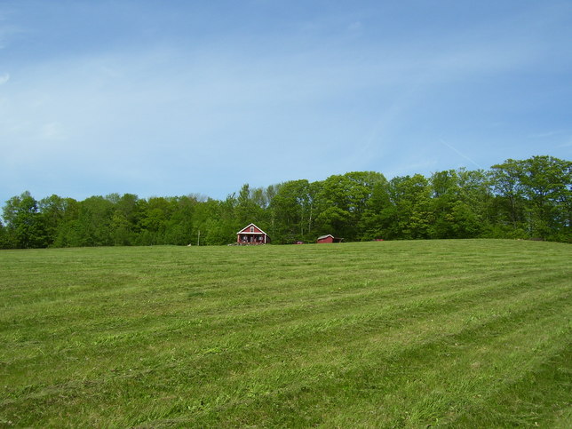

Kind of late to jump on this bandwagon now ;) but I kind of use the same method myself ! :) I started using this method because the lower part of my property is fairly steep and I only feel comfortable turning at the bottom and rather than making long passes at the bottom of the field while cutting air is easier and more efficient to divide the fields up into strips to maximize cutting time ! ;) Of course Im only using a 5ft hog:rolleyes:
Uh....Scotty....? Whatta you doin' in my pasture buddy?
Picture #2 looks enough like the pasture next to the house that I had to look 3 times to convince myself it wasn't.
And talk about mowing lots of ground with a small mower? I'm leaving in a couple hours to start on a mowing job we just took. 71 acres divided into small pastures, the BIGGEST being 4 acres. It a horse bording stables. (Arabians) The gates are all 8' and under. Gotta mow with the Massey and Ford, 6' cutters. We'll be there a while.
