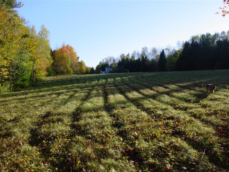

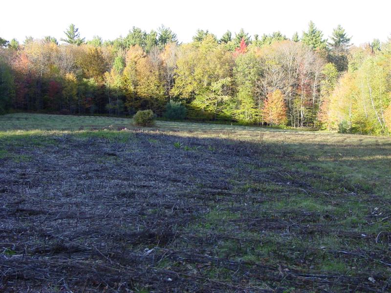

dknarnd:
I tend to keep my RC's rear laminated wheel down when turning while cutting except in those areas where the RC will scalp. I will lift the RC around known obstructions, going through swales and rises to prevent scalping and/or making a lot of scary sounds :eek:. I vary my cutting patterns to keep from leaving tire marks and ruts. I have some pretty steep areas that I have to approach straight up and down. In my lower field's two corners I tend to use a continuous loop and/or a continuous 180 degree turns (I used to use the turning brakes with my old Ford; I really have not figured out :confused: how to use the turning brakes on my new tractor yet :(). In order to cut a square corner you may have to back into the corner and/or start off from that corner.

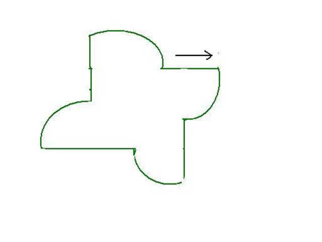

Is this what you guys are talking about when you refer to 270* turns to correct the "bumped out" corners?
/ Bush Hog Technique #12
Yep, Chuck, that's what I was talking about. The only difference is that your diagram is going around a field counterclockwise and turning to the right where I most frequently went clockwise and turned left.
