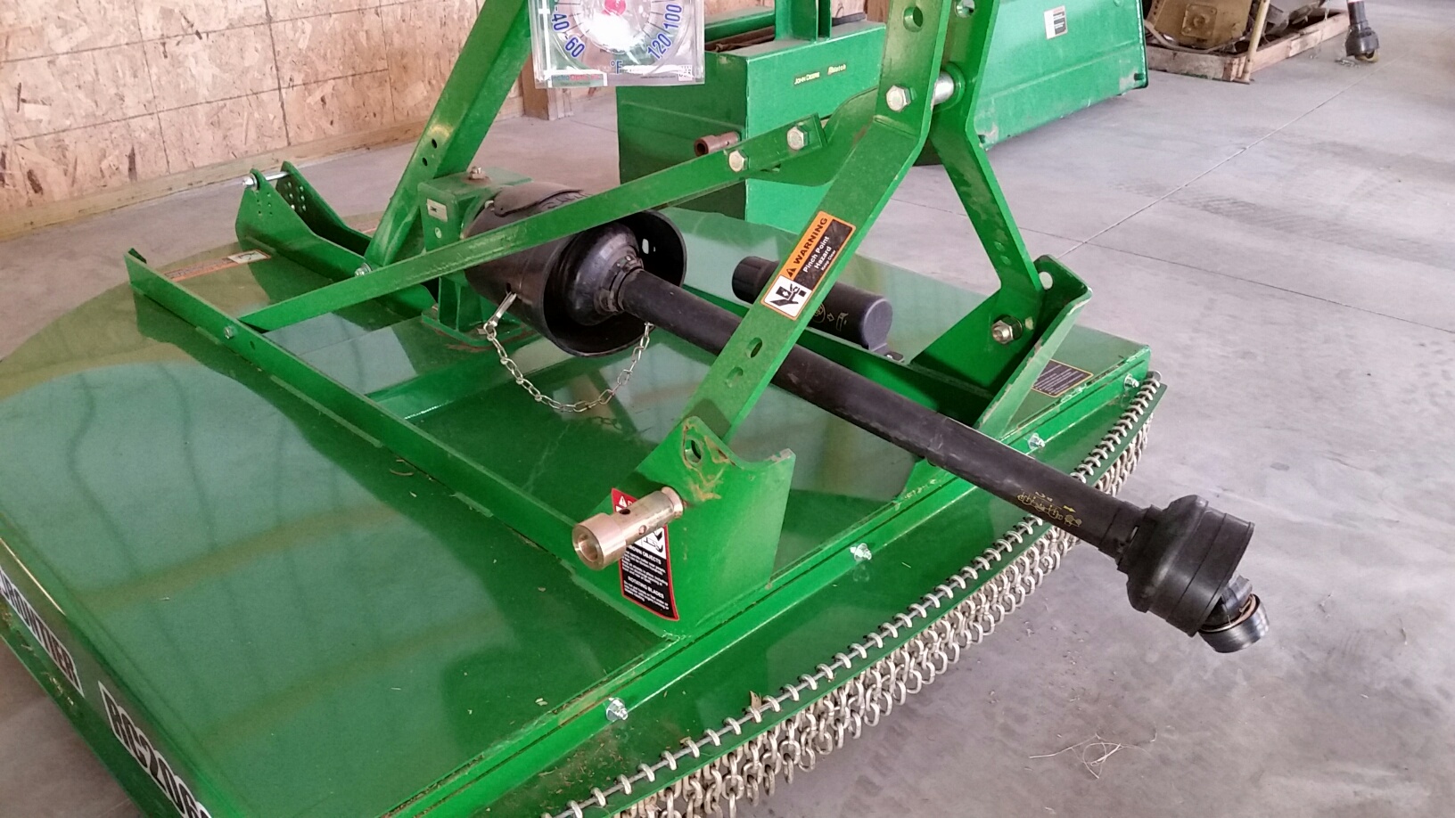

I had exactly the same problem with my John Deere 2720 and Frontier 2060. My hitch had a second pair of hitch pin holes that were slightly lower and further back. When I moved the pins to the lower holes I was able to lift the cutters wheel about knee high. Where before, I could barely get the wheel off the ground.

Thanks for the help guys. The holes are 13" now. I think I will lower them to 9"
FYI, my lower hole is 3" lower and 1.5" further back from the top hole.

Make sure it doesn't affect the length of the pto shaft when lifting it. Changing the the height will affect the shaft angle and might affect the length the shaft slides. If the shaft slide bottoms out you could damage the pto housing and guts. If its too long you can cut the shaft a bit.
