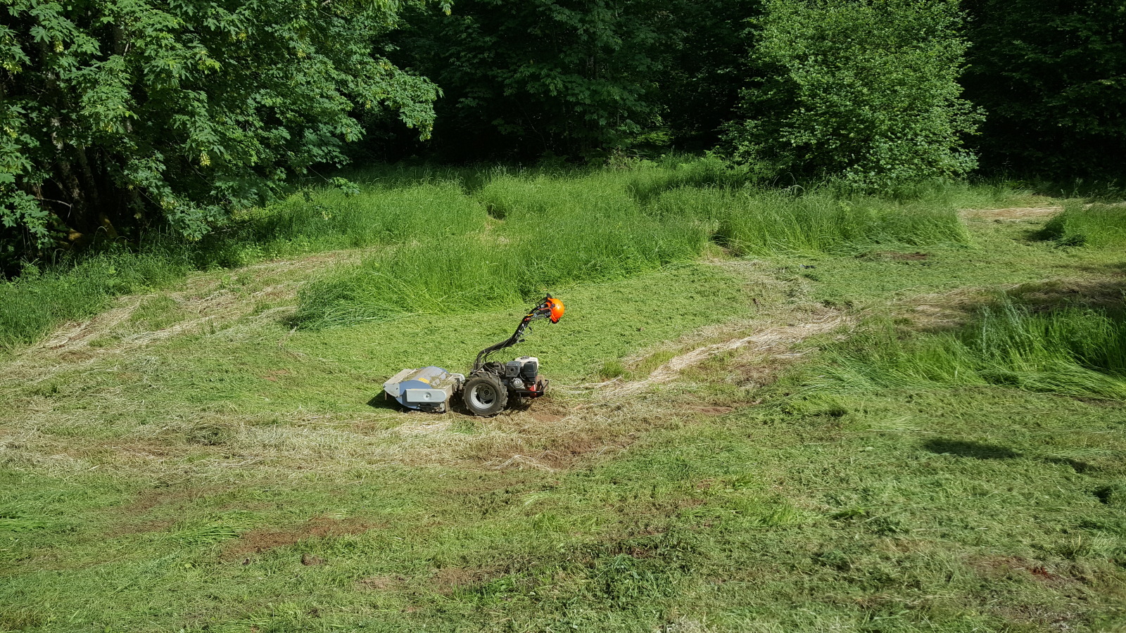

Do they do well over uneven terrain?
Better traction?
I am thinking of getting the rubber tracks. Even though I went over much of the ground around my house with a dozer and evened it out, there are still areas where the tires struggle to get traction and I occasionally get a little stuck and have to manhandle the tractor get it moving again. The moles don't help either.
And now that the loggers are dropping trees on the back acreage, I may need to go back there and keep the brush away from the replanted trees to give them a chance - not sure about that yet; going to have to see whether that makes sense or whether it will just be better to spray herbicide by hand.
It'd probably be cheaper and easier to get larger tires for your BCS, wheel extensions, or dual tires. I got the short extensions, and I found it a great upgrade over the stock setup. Get hung up less on stuff, and the tractor doesn't get as crazy hitting holes.
   / Bush mowing the pasture #12
I thought about getting larger wheels and tires and extensions and weights, but I think tracks would do better, and the cost is not an issue.
However, what I am thinking now is getting an ATV with a self-powered pull behind flail mower - the ground is more level now and the amount of acreage that I want to mow is such that an ATV would get it done faster so I can get other chores done. I can still use the Grillo with flail mower for the tight spots.
Also, I am in the middle of a timber sale on my back acreage and getting there with equipment/etc. requires going up my road about half a mile, then back down the new access road another half mile, because that acreage is on the other side of a gully, so having an ATV to get back there would be useful - plus I can pull a drag harrow with an ATV and I can't with a wheeled two wheel tractor.
