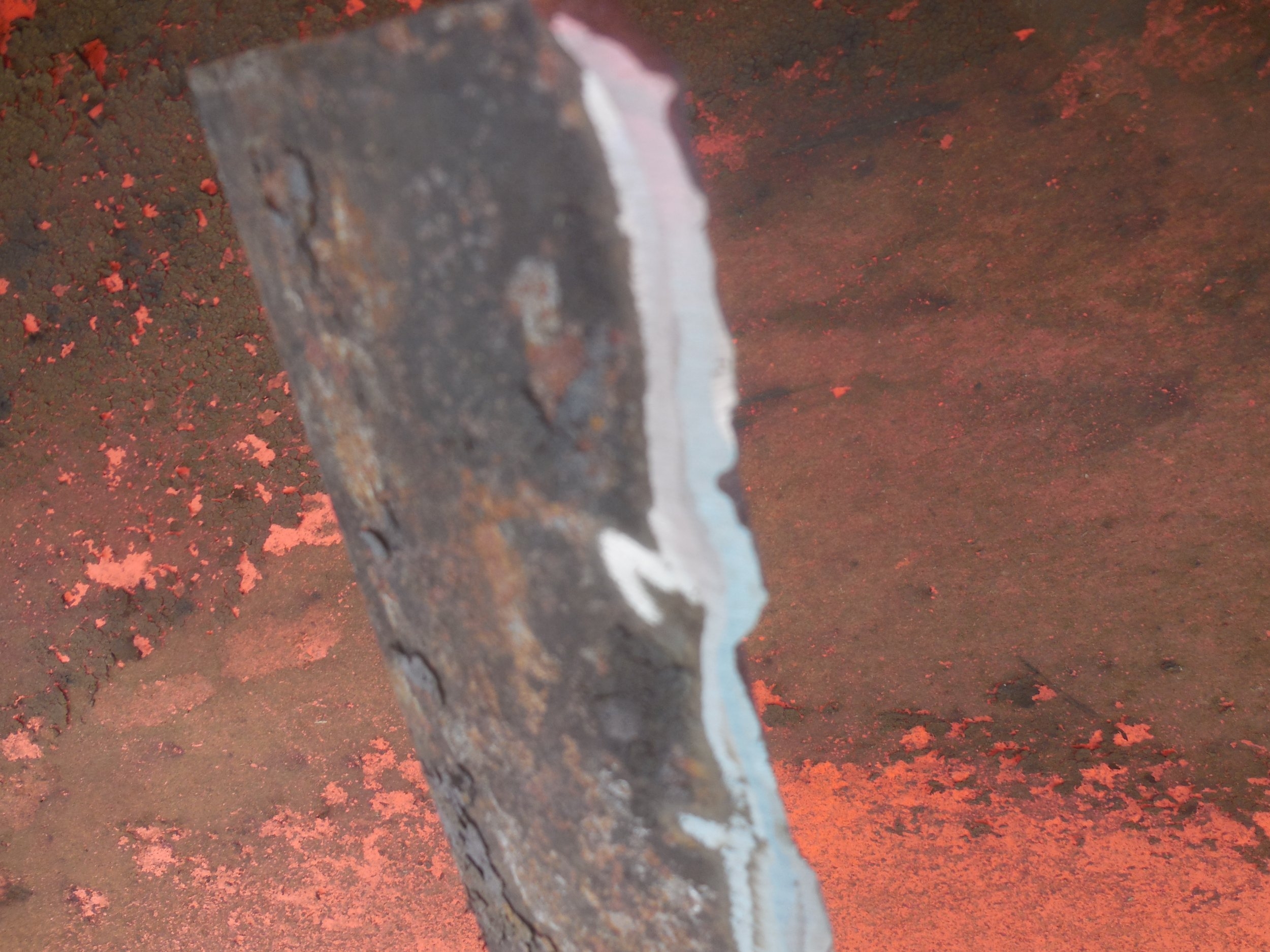

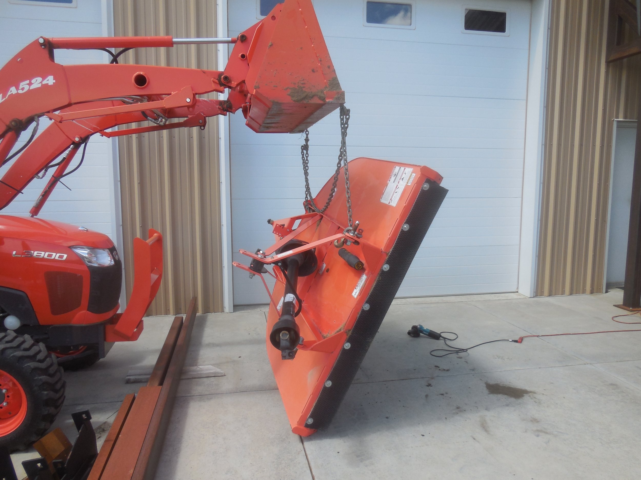

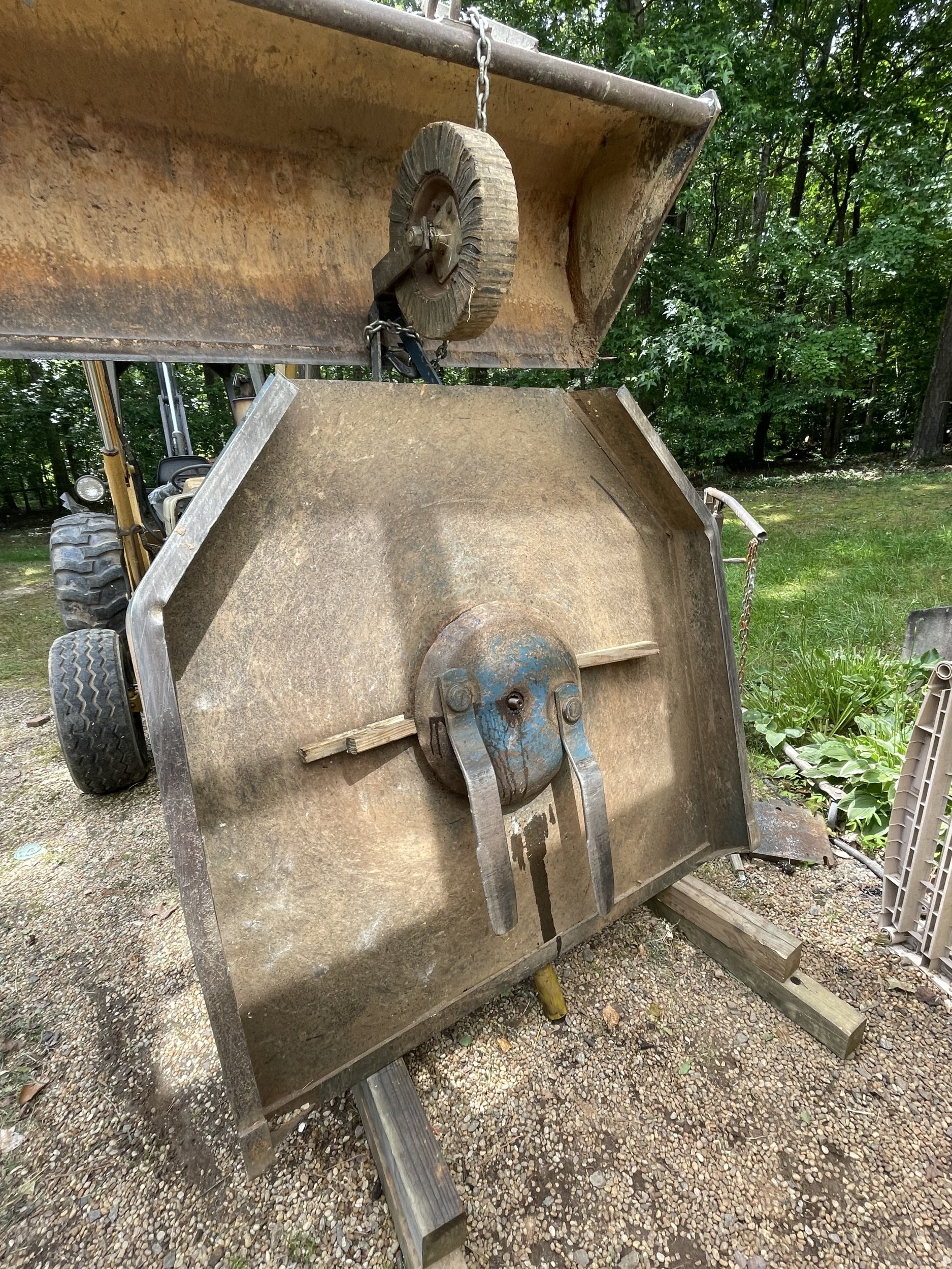

Tired of laying on a creeper and getting "dusted", this year I tilted both the little 5-footer and the larger one so I could stand up while sharpening the blades. Which my bad back appreciated.
By now I've found most of the rocks, so hopefully the blades won't take as much of a beating.
Besides, a serrated edge cuts better, doesn't it?
   / "bushhog" Blade Sharpening #31
^ looks plenty sharp to me! A couple sharpened divots in the edge never hurt nothin.
