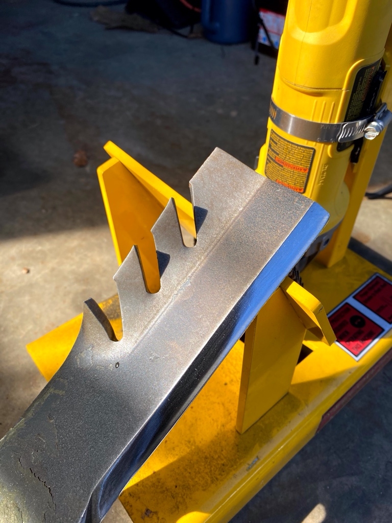

I use a jig to get a consistent edge using a 40 or 60g flap disk. Sharpening every 30-40 hours I can keep the tips square, and they get balanced each sharpening.
I'm using some of those Gator blades on my smaller (42") riding mowers and love them. Unfortunately I can't find them for my larger Woods decks. For the Gator-type blades, are you sharpening the edges of "lifting cuts" on the trailing edge of the blade? If so please provide more details. Thanks!
/ Resharpen or Replace #49
I don't sharpen the mulching wings. In my soil type (no sand) the lift wings see little, to no wear.
