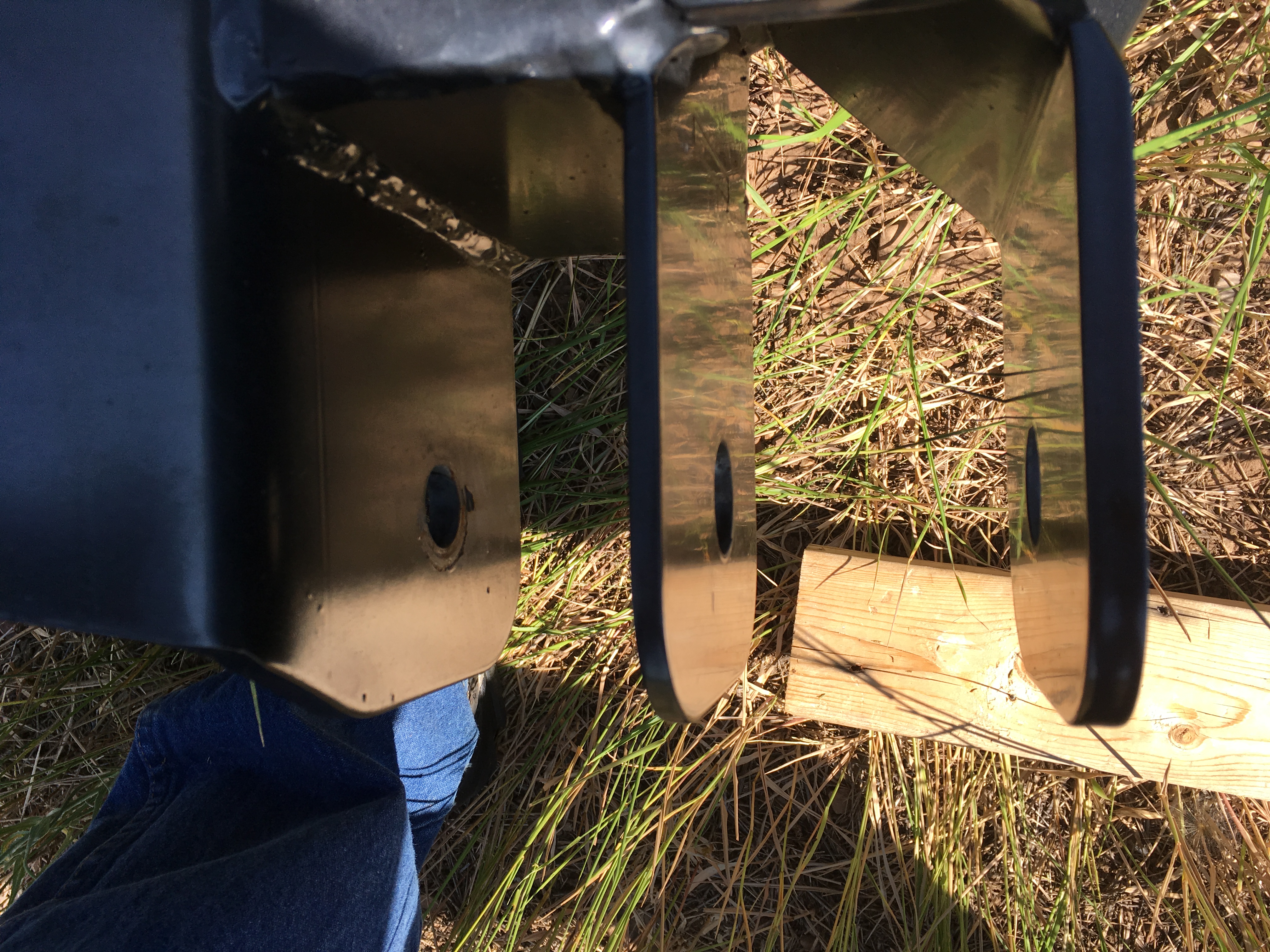

How wide is the space for the bushing? You can buy different width bushings.
   / bushings Cat 2 to Cat1 #12
As was mentioned, stack washers or cut down a bushing. My preference would be to stack washers or make a bigger diameter bushing so the side to side movement is minimized.

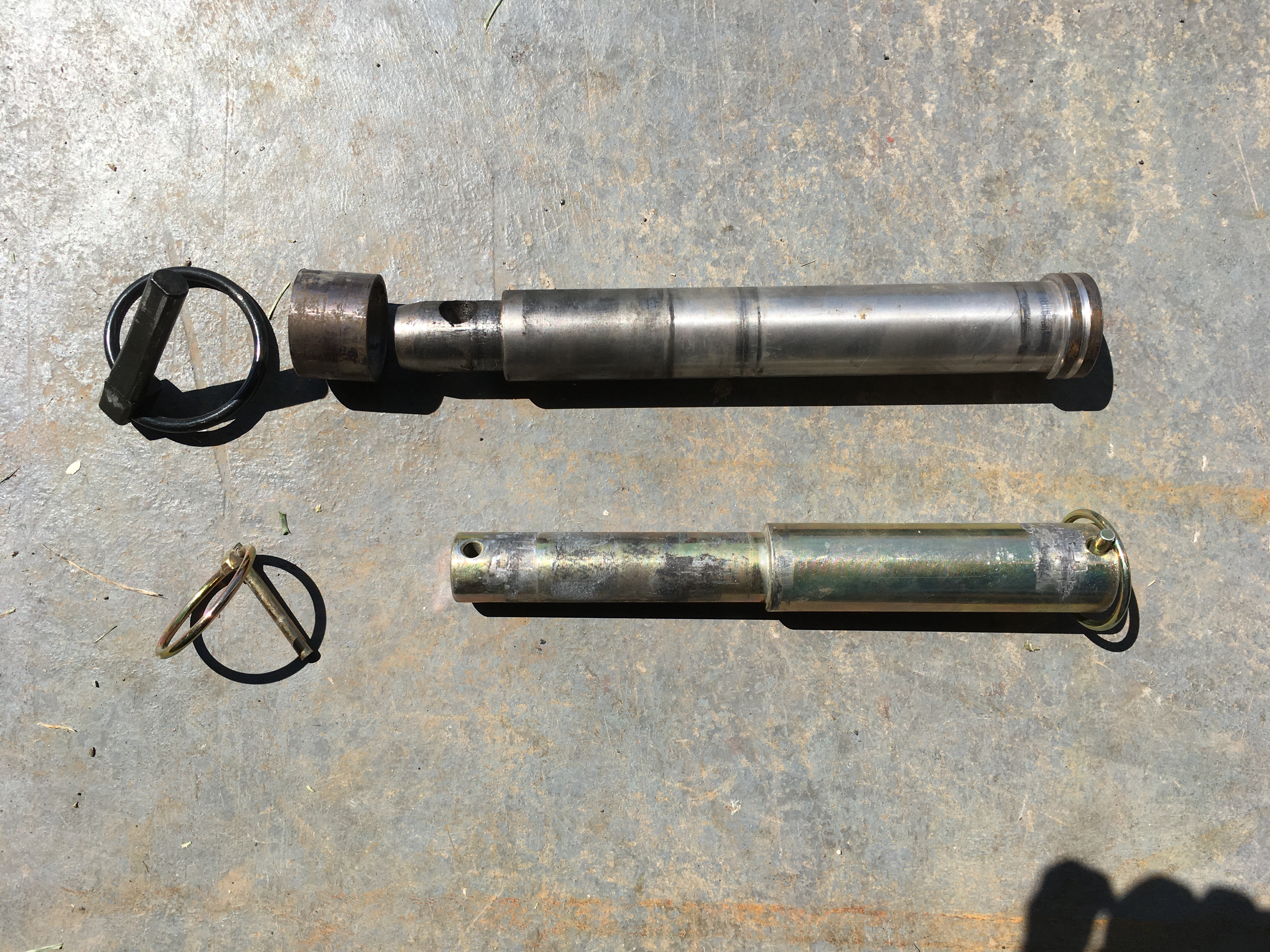

I had s similar problem with my snowblower. Blower was setup diameter wise for Cat1 and Cat2 but the blower Cat2 was too wide for the 3 point arms so I made new pins that were Cat2 all the way. Then made a bushing to control side to side movement.
I had hoped to post pictures but i dont see how on my phone.
I'm on a computer now so I can post the pictures of the pins I made. Maybe it will give you some ideas of what to do.
