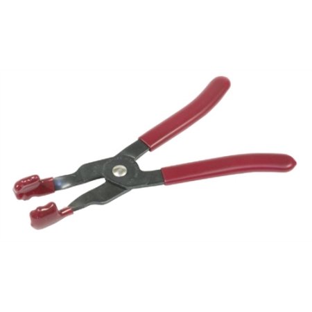

To see what happens when a plug is not firing, you can simply short the plug cap to the engine block using a screwdriver with a plastic handle.
If you want to swap wires when it is running, stop by any automotive store or Walmart and pick up a set o spark plug wire pliers. Around ten bucks for a typical pair of pliers. With those you can pull the hot wire off of the spark plug and transfer it to another plug - and all without that "twitchy feeling".
luck,
rScotty

Those work pretty well Scotty but 100% plastic/fiberglass versions are available that are even more fool proof. I'm looking foward to hearing how it's done in jackrabbit country.:bunny:

These engines are flat heads with just enough room between the top of the spark plug and the gas tank to get the wire off. Those pliars will look nice sitting on the shelf.
