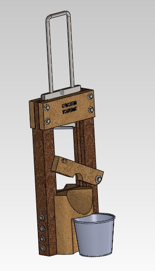

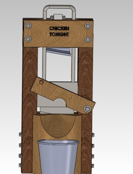

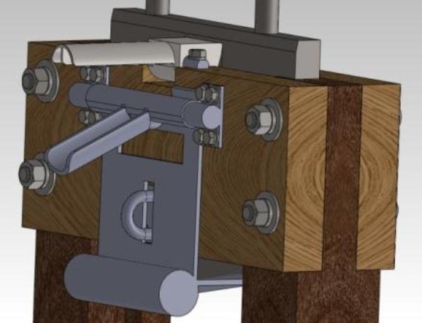

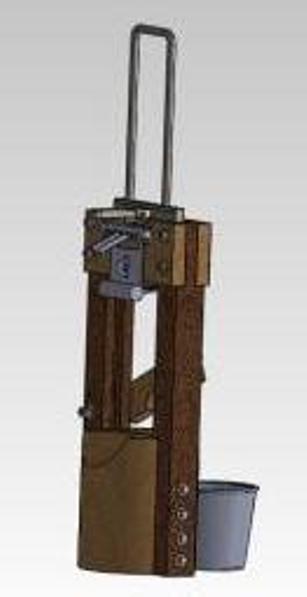

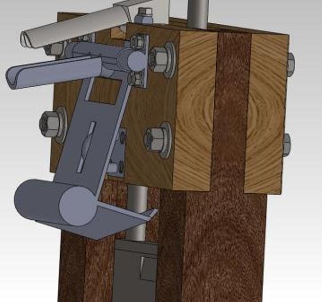

A rendition of YE old Chicken chopper

Since I mentioned this thing I thought I would draw one up
Lift the blade until the trigger sets
Place chicken on chopping block close head restraint
Grip the handles of the blade lock and the trigger and squeeze
Blade lock will open first additional downward push may be required to release trigger
if trigger is pushed down without holding blade lock handle the lifting bail on the blade must be raised again to re cock the trigger
Blade cannot fall unless both handles are squeezed together
Padlock loop is to prevent accidental or unauthorized use by children
If nothing else this would make a cool novelty item to build
Disclaimer should someone decide to build this no responsibility for accidental injury shall be assumed on my part. All reasonable safety precautions were taken into account should there be additional safeties required or thought of the builder owner assumes full responsibility Any deviation in sizes or materials are up to the builder
