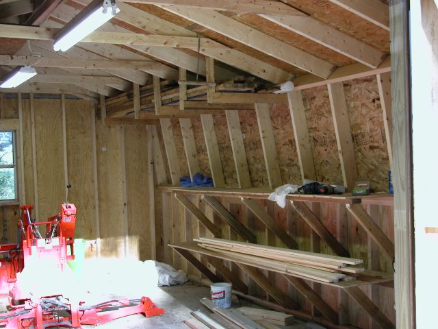

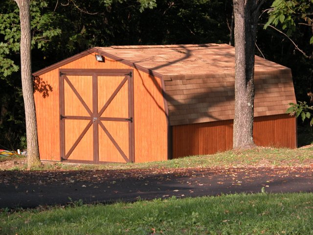

rogue:
Let me throw in my 2 cents. I needed a new shed last year to fit the new BX22. I looked to buy, to make life easy, but couldn't get the 8'x8' doors I wanted to clear the ROPS.
I ended up building a 16'x20'. Hip roof (I think, barn style), with 10' at the peak. For the foundation, I used PT 6x6's set on level ground and stone. The 6x6 are in a grid. I filled the spaces between the 6x6 with stone, leveled. On top is 1/2" OSB. Sounds weak, but I used it in the old shed (15 years ago). The stone gives the support and the board the nice surface. It holds the BX no problem. It is much cheaper than concrete, and in the locale, it is not considered a fixed structure, so it is not taxable.
The side walls are T1-11. Framing is 2x4 for the walls and 2x6 for the roof. Doors are 2 4x8 sheets of T1-11.
Overall took about 2 months of after work time, including razing the old shed. Total cost was under $ 1100. This was about 1/2 the price for a better shed.
paul

rogue:
A shot inside
paul
